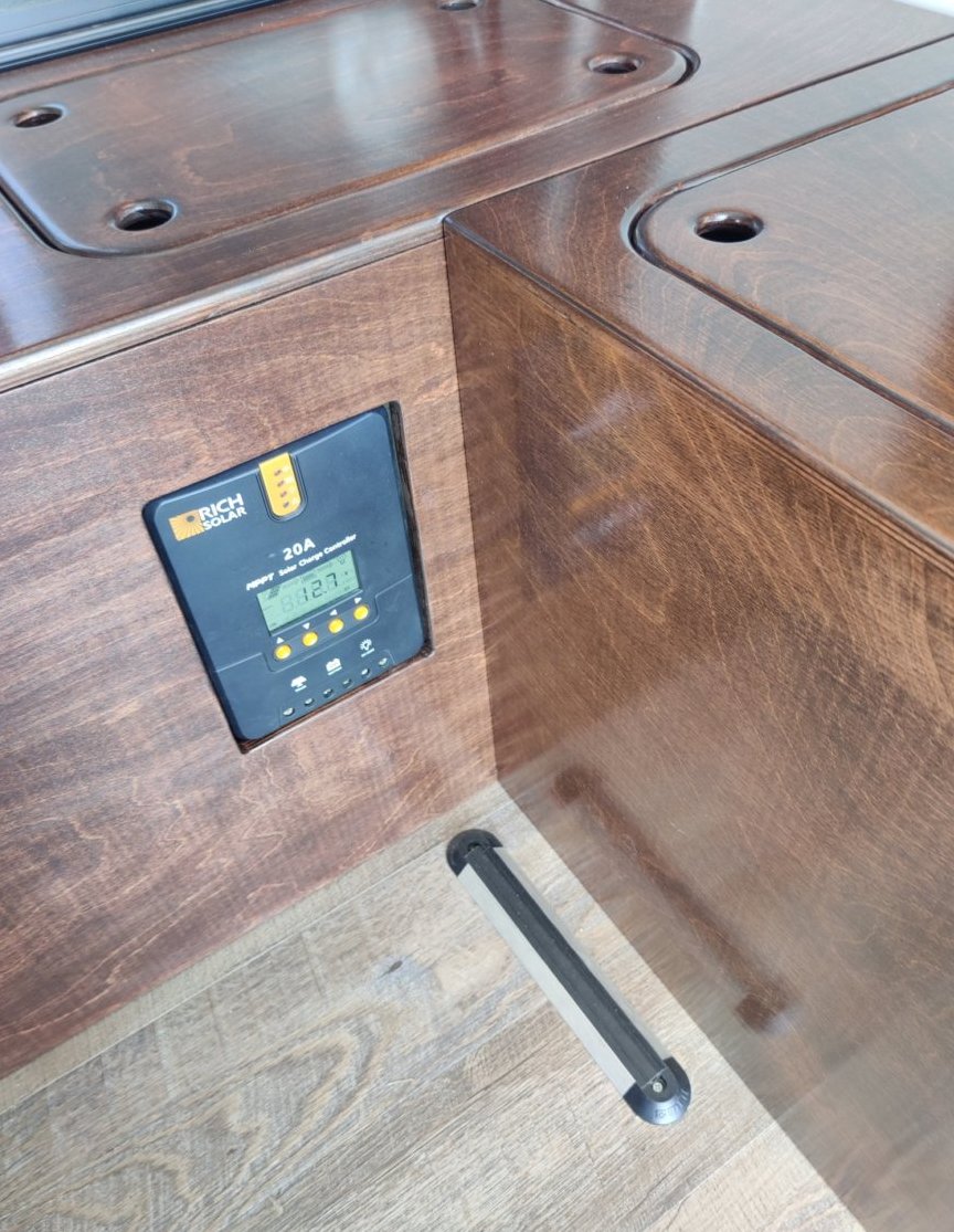

    stock af, but hover if you think you disagree... RV living: Vagabond Drifter (6' bed) Custom bed cabinet buildout 175w Renogy solar panel 40a Rich Solar MPPT solar controller 1000w Wagan Pure Line inverter Lavaner Pro 2kw diesel heat exchanger Suspension/wheels: Toytec Aluma 2.5 front shocks with resis 13x700 coils (soon 14x700) Toytec Aluma 2.5 rear shocks SPC UCAs Deaver Stage 3 rear leaf springs Wheeler's 3 degree axle shims Wheeler's U-bolt flip Wheeler's Super Bumpstops 18"x9" XD Monster (x5) 275/75/18 Cooper ST MAXX (x5) EBC Stage 3 pads/rotors Electronics: Kenwood DNX773S iDatalink - Maestro RR Stubby Antenna No-name Switchback LEDs Hella Sharptone horns (no relay) Relocated backup camera w/DIY bracket Armor/recovery: BruteForceFab Rear HC w/swingout BAMF Sliders (DOM, 10 degree w/kick out, rattle-canned) BAMF IFS Skid (BAMF powder-coated) BAMF Mid Skid (BAMF powder-coated) BAMF TC Skid (BAMF powder-coated) BAMF LCA Skids (BAMF powder-coated) BAMF Rear Diff Skid (early model, powder-coated) BAMF CMC Plates US Offroad Winch Bumper Smittybilt X20 10k synthetic rope winch Total Chaos Bed Stiffeners ARB compressor w/air-up kit DIY cowl snorkel ARB rear air-locker Interior: Husky Floor Liners (F&R) Rear 40% seat-delete Hinged fridge platform in place of rear seat Exterior: CaliRaised Low-profile Ditch Light Brackets CaliRaised Side-projecting LED pods CaliRaised Faux TRD Pro Grille Morimoto amber LED fog lights One-of-a-kind 1GRFE plate (second iteration) Removed: OEM Bed Mat CaliRaised bed molle panels
    I've had zero issues with my Rich Solar 20a MPPT controller (linked above) so far; I've had it connected and working for over a year now.
    It also supports the Renogy BT transmitter, but you do have to "add new device" each time you use it because the Renogy app was developed by idiots.

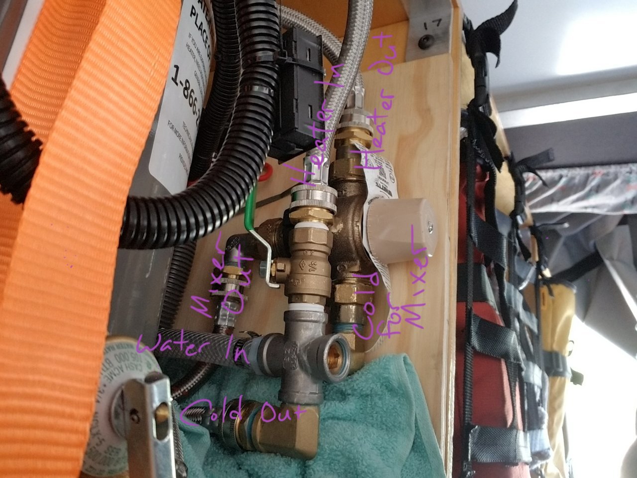

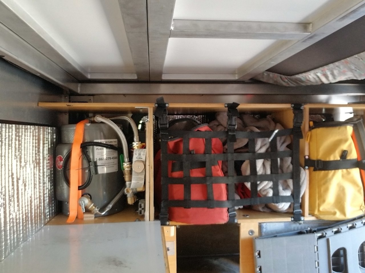

    Yeah, definitely not an instant type of thing. I don't think instant electric hot water is even (reasonably) possible, to be honest.
    I put a 12v/600W element in it, and that amount of power will basically give you 2 degrees per minute for this 2.5 gal. So 60* to 105* is ~22 min.
    If you were to end up using this heater and leaving it AC, that element is 1440W, so it would only be ~10 min.
    I took it one step further, and plumbed the water heater output into a thermostatic mixing valve. That way, I run the heater on a 176* thermostat, and the mixing valve will blend it with cold down to 105*, which stretches my hot water "capacity" to more like 4.5 gallons or so. The downside there is a fair amount more plumbing complexity.
    I also added a cheap little temp display, so if I don't need the extra volume for a shower, I can just switch the water heater off once it's up to 105* or so.
    One other simple (but inconvenient) option for you would just be using your kettle to boil probably a few batches of hot water to mix with cold for a simple gravity shower or whatever...
    Oh, and for the record, I debated about using pex for the plumbing, and I think deciding against it was definitely the wrong call. Haha
