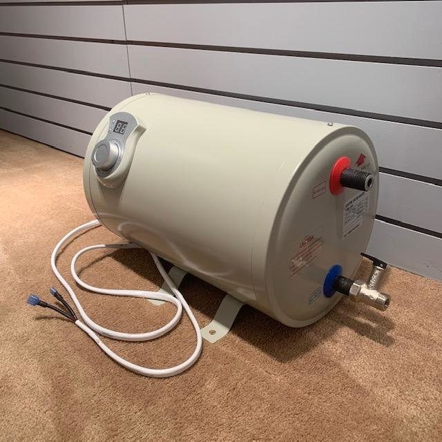

    I recently bought this tiny 6L 12v hot water heater for my build. My plan is to use it as a dump load from my solar when it gets charged around noon. I have 300w of solar, so have extra power especially in the summer. I am guessing it would 20-30 min to get up to temp. I didn’t have space for the larger units, so 6L will have to do. Will report back after install.

    Yeah, that's relatively similar to what I was doing before the water heater, just by using my propane stove instead. Personally, I got really tired of that process, and having to fiddle around with all of it, to the point that I highly preferred just using one of those solar shower bags. Though I also live and work out of the camper for months at a time, so...
    I wired my heater such that I can also turn it on from the cab while I'm driving, so the heating time really doesn't bother me. And with the thermostat, I could even turn it on in the morning, go hike or whatever for several hours, and then be ready to shower immediately upon returning.
    No way, that does sound pretty intriguing. Though, (without knowing any details about this product) I have to wonder how well that would work out in terms of raw heating ability, flow rate, temperature spikes if/when the flow isn't constant, etc.
    Definitely keep us posted on that one if you go that route!
    I had the same concerns on vibration, but I had to go through a lot of effort to get it all sealed originally, so that really led me to go above and beyond. I'm pretty confident in its current state, though I don't expect it to be 100% maintenance free long-term, so I'll always be keeping an eye on it.

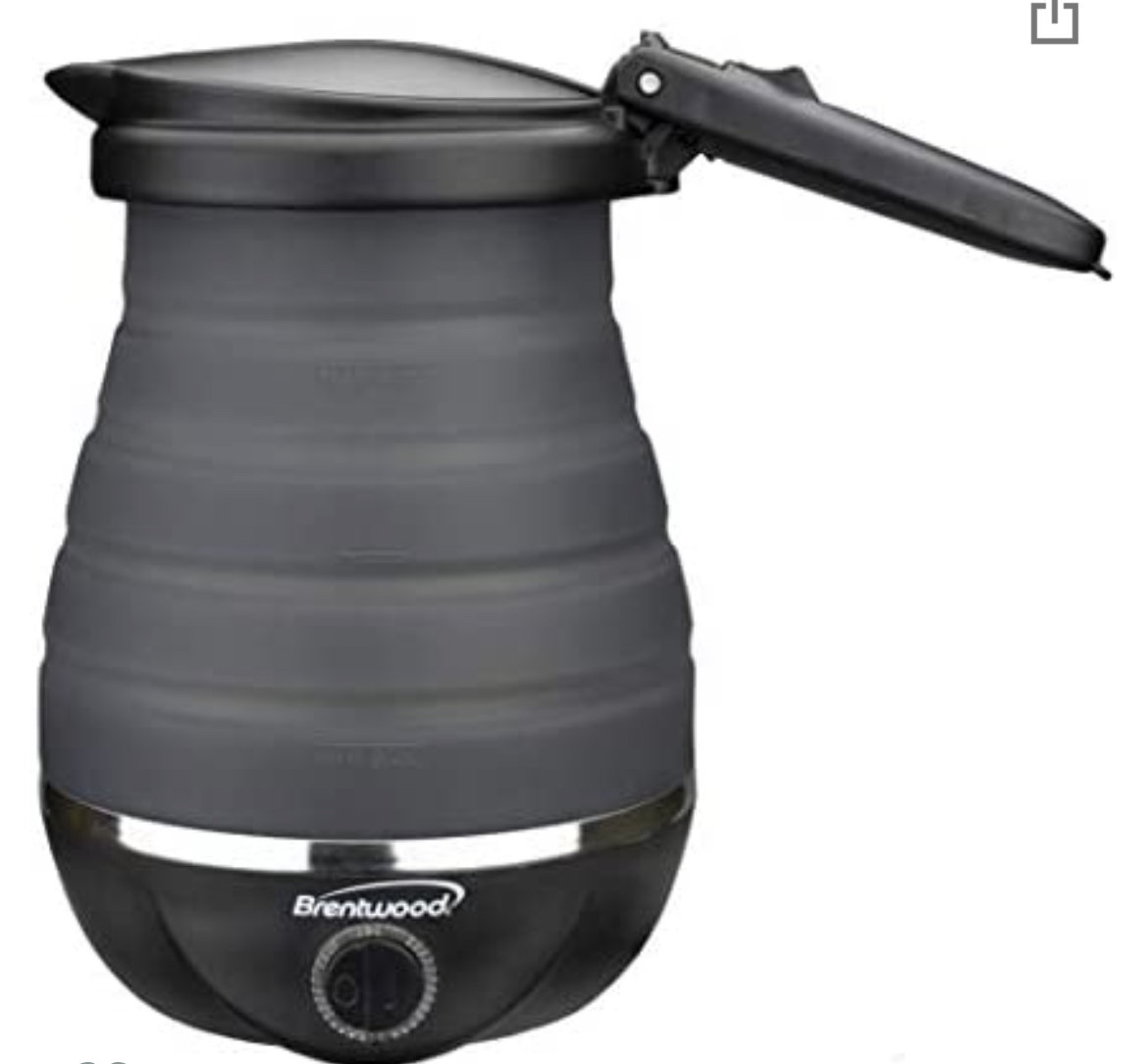

    Does anyone use an electric kettle?
    Looks like most kettles would require an inverter to use. There are a few 12v ones but I imagine they take forever to boil.
    What do other people do here? Inverter or 12v for these types of power draws?

    @xplorn is the only one to say so in this thread from my searches... I've been thinking about it. My Dad has an electric kettle from the 80s, but he usually runs it off "shore" power.
    @xplorn - what kettle do you have?

    We have been using the Brentwood Electric Kettle for a year. For $27, it is our favorite accessory. We have it dialed in to fill to the brim with water for breakfast in the winter. No need to fire up the stove and open up the heated camper to vent CO. One kettle full uses about 12 Ah and will make 2x instant coffee and 2x instant oatmeal bowls. Perfect and easy breakfast while in the go. Power from the sun can be hard to come by in the winter, so we are adding a DC/DC charger to charge while driving.
    Brentwood Appliances KT-1508BK .85-Quart Dual-Voltage Collapsible-Travel Kettle (Black), 0.85Q https://www.amazon.com/dp/B07NMT99NB?_encoding=UTF8

    Nice! Those are the exact reasons we plan to go that route.
    What size inverter do you use to run it? Looks like it the draw is around 800 watts, so I’m assuming at least a 1000w inverter?

    Yup. I am using a 1000w Victron inverter. It turns out that is the largest size Victron that I can fit in my build. So, I have managed to find appliances that work on 1000w or less. I have even been experimenting with a induction cooktop. Fair warning, however. All these electrical appliances increase your appetite for battery storage. I am upgrading from 80Ah to 200 shortly. Enduro Power Battery.
