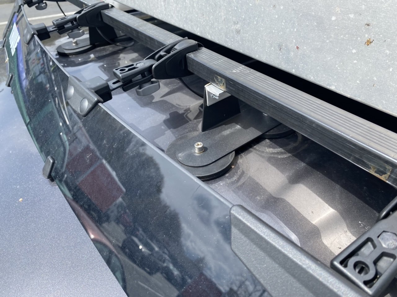

    Partial list: Vagabond Drifter 3rd Gen OR rear axle 4.30 gears Bilstein 6112s and Tundra 5160s.
    Magnets for wind faring mount:
    I posted a while back about using suction cups to mount a wind faring in front of the camper to reduce road noise. Some of you speculated the suction cups would eventually fail, which they did, even with adhesive, after a few weeks. (The suction cups are vinyl and I ultimately couldn’t find a suitable adhesive that I felt confident wouldn’t hurt the truck’s clearcoat.)
    Enter magnets from Amazon. I cut some rough brackets from aluminum angle and screwed them to a crossbar for the wind faring, and everything is working perfectly.
    (The residue rings are from an attempt to glue the suction cups, not from the magnets slipping.)
    Magnets seem to be the easiest, cheapest way to mount a wind faring in front of the camper’s leading edge on an access cab.
    https://www.amazon.com/dp/B0831M38LR?_encoding=UTF8

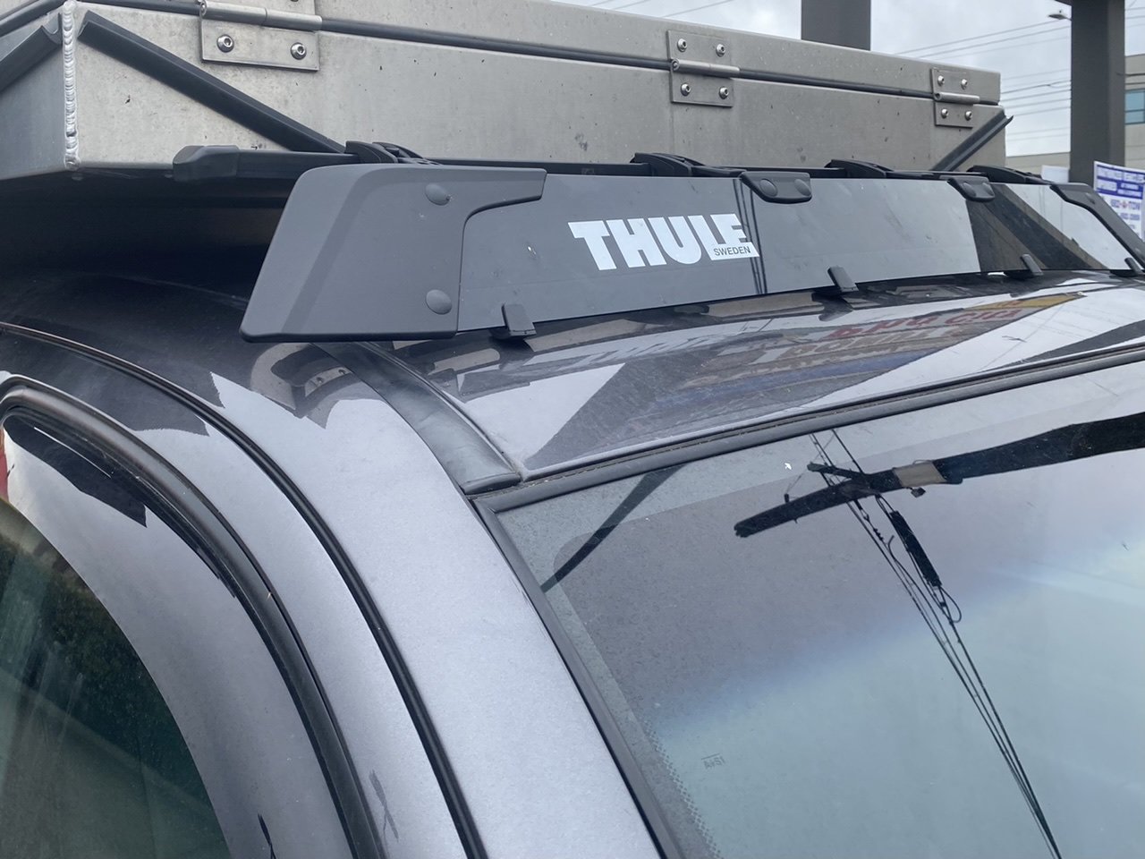

    Thanks for the info! $30 I can give it a try. Already have the fairing and crossbar. I'll just figure a way for it to work with a round Yakima bar.
    My only concern is the AT Summit extends even further than the Drifter so it's going to be close...

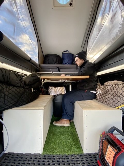

    Might as well post my interior build in its current state.
    I live in my Drifter full time in the Seattle area — I have been since October, including during those really cold “polar vortex” nights — when I wished someone at Vagabond would return my several attempts at communication regarding how to buy the insulation pack for the wedge.
    My budget is not big, so my setup is somewhat Spartan:
    1.) The benches end two feet from the tailgate. A slotted rubber mat takes up the rest of the rear area, giving me a “mud room” and a place to bathe.
    2.) Fake grass feels great on the feet.
    3.) I use the Lagun rotating, raising, swiveling, removable table arm.
    4.) A 5-gallon bucket toilet with plastic liners lives in the leftbench. I rarely use it, but if something gets the best of me in the middle of the night, I’ve found that the liners are the easiest way to dispose of the waste in an urban environment — tie them up and throw them in a dumpster like you would a diaper.
    5.) I have a funnel at mattress height, connected to a tube that empties under the truck. I can pee without getting out of bed, on the street in Seattle.
    6.) 10 gallons of water live at the front of the bed in the center, in the form of two septer cans. (Behind the trash can.) I like this set-up because two 5 gallon cans don’t slosh like a single 10 gallon tank, and if one tank is breached, I still have five gallons of water left. On the to-do list: run a water line with an electric pump to one tank, with a dishwashing, boot-washing spray nozzle at the tailgate.
    7.) A 20 lb. propane tank lives in front of the right bench. This powers my buddy heater and a small stove (that stows in the right bench).
    8.) I put a shut-off on the propane line just behind the heater, and built a drip leg into the line, after some oil in a bad propane fill ruined two previous buddy heaters. I keep the heater covered with a backpack rain cover to protect it from dust when not in use.
    9.) Also in the passenger bench: A bluetti lithium battery that powers the house through the 12v cigarette jack, via a line that runs under the bed.
    10.) I did the 400w anytime mod to my truck’s inverter; the bed’s AC outlet charges my bluetti battery while I drive.
    11.) I have a cooler instead of a refrigerator. It lives in the cab of the truck, where (I think) I can access it through the back glass. I haven’t used it because the weather has stayed cool here in Seattle.
    12.) Cargo nets all around the “ground floor” store my bedding, etc.
    13.) I removed the overload springs from an old set of Dakars and replaced them with Deaver 3-leaf AALs. This combination of Dakars and 3-leaf AALs rides really smoothly and supports the loaded Drifter. The set-up cost $300 total; they do still squeak like crazy.
    14.) I regeared to 4.10 (265/75/16), which restored all my acceleration with the truck loaded, and still keeps my RPMs low at 65mpg. I do sometimes wonder if I would have liked 4.30 more.

    Looks like a well thought out build! Do you keep the wedge popped up at night to sleep or do you use one of the benches as a stealth sleeping platform?
  15. Apr 22, 2022 at 11:15 AM
    #6335
    TomHGZ
    TomHGZ Well-Known Member
    Jun 24, 2011
    #58798
    850
    2014 TRD Frankensport 4x4 AC AT
    I pop the wedge every night. I find sleepy streets, I come in late and leave early, and often switch my location so I don’t draw too much attention.
