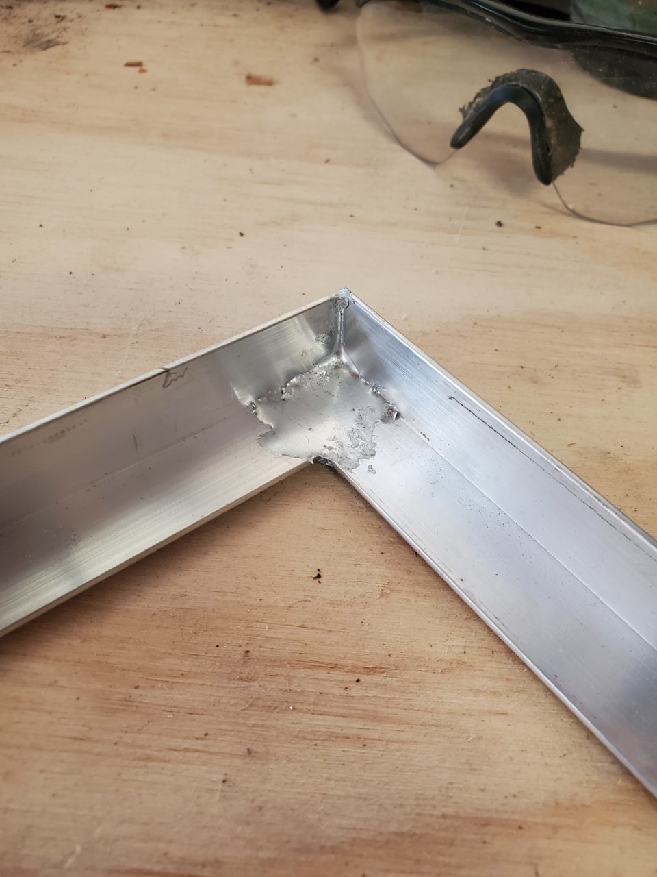

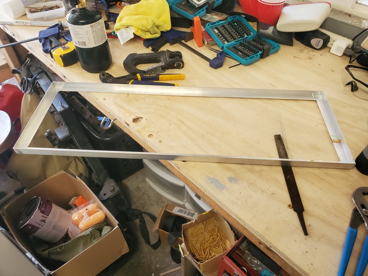

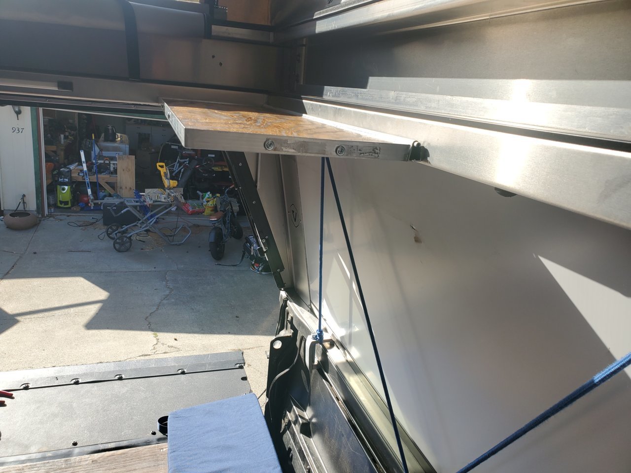

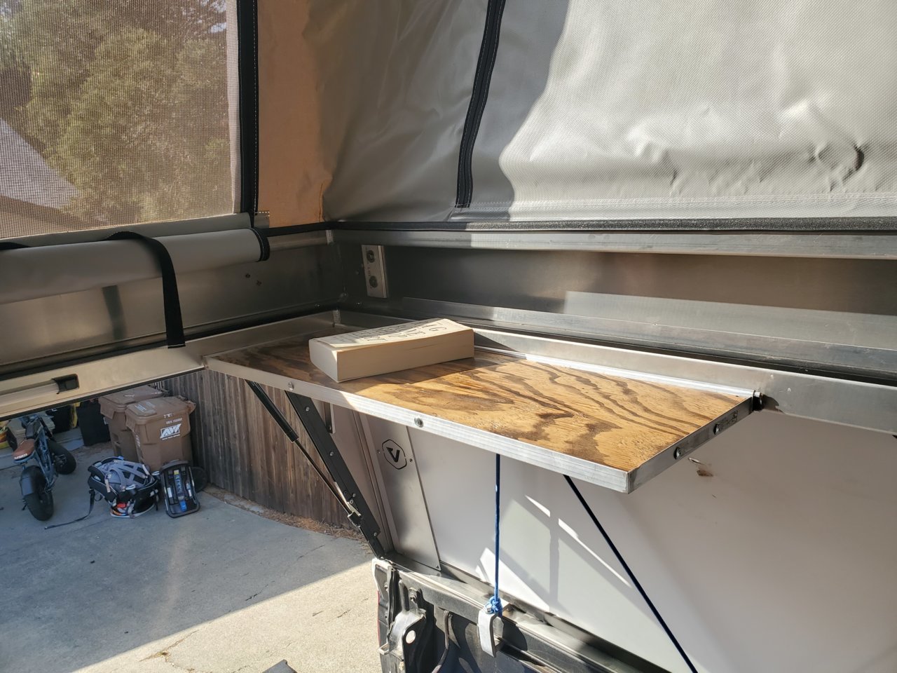

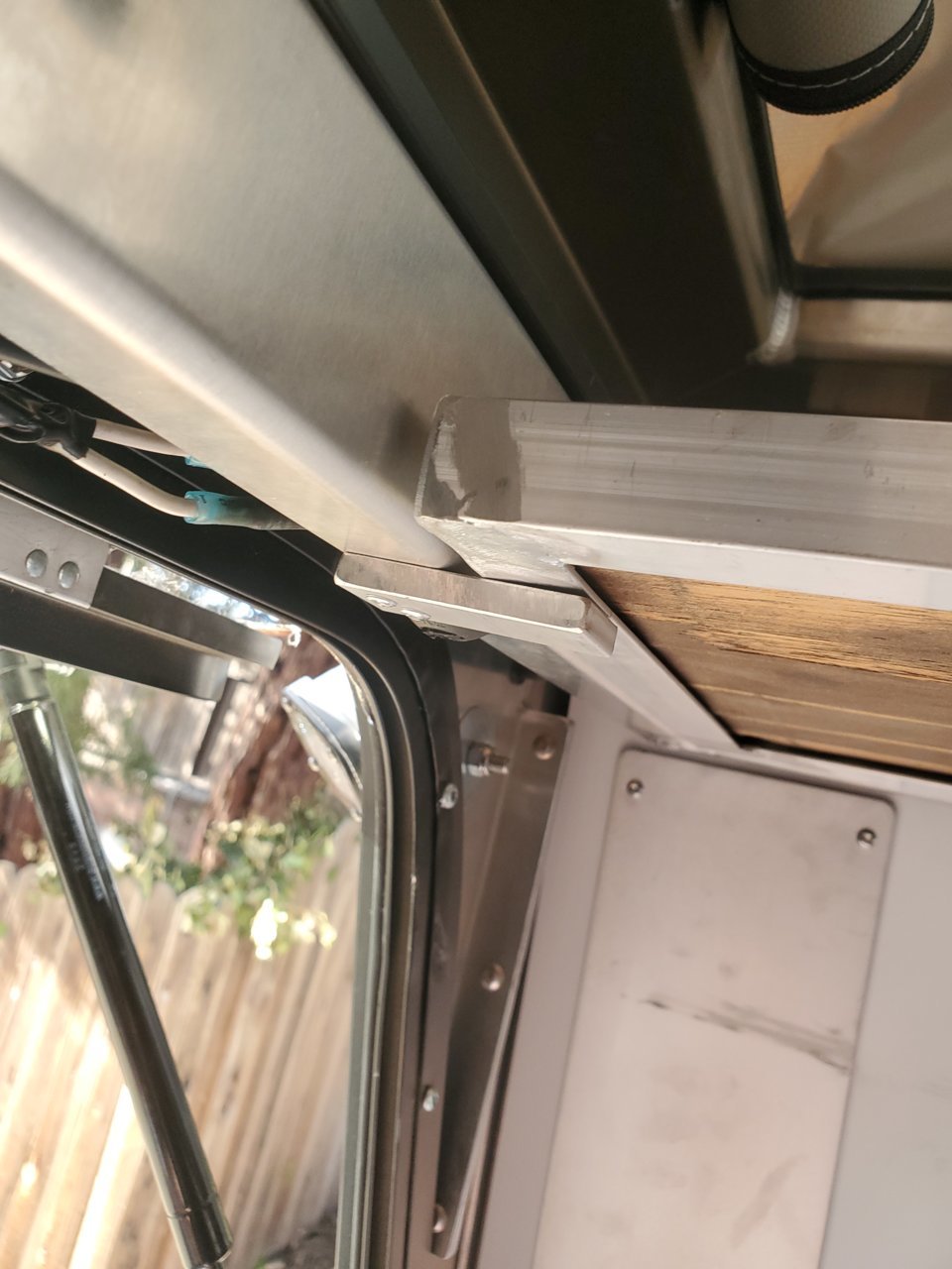

    After removing half my buildout for the growing family, I lost a place to put phones/water/stuff at night.
    Minimalist nightstand:
    I used aluminum angle iron and "welded" (not really) them together with those Alumirods. Then riveted an rv side table mount to the outside and the drifter. Temporary plywood to fill it out until I find something I like better. An aluminum support near the hatch helps up the weight capacity. The whole thing pops off and stores under the matress when more room is needed.
    20220426_124204.jpg20220426_124208.jpg 20220426_174326.jpg 20220426_174507.jpg
    Alumaloy 20 Rods - USA Made, As Seen on TV, 1/8" x 18" Simple Welding Rods, Aluminum Brazing/Welding Rods, Aluminum Repair https://www.amazon.com/dp/B01MQX8QJY?_encoding=UTF8
    AP Products (013-164922 30.25" Table Support https://www.amazon.com/dp/B00G44IZEO?_encoding=UTF8
