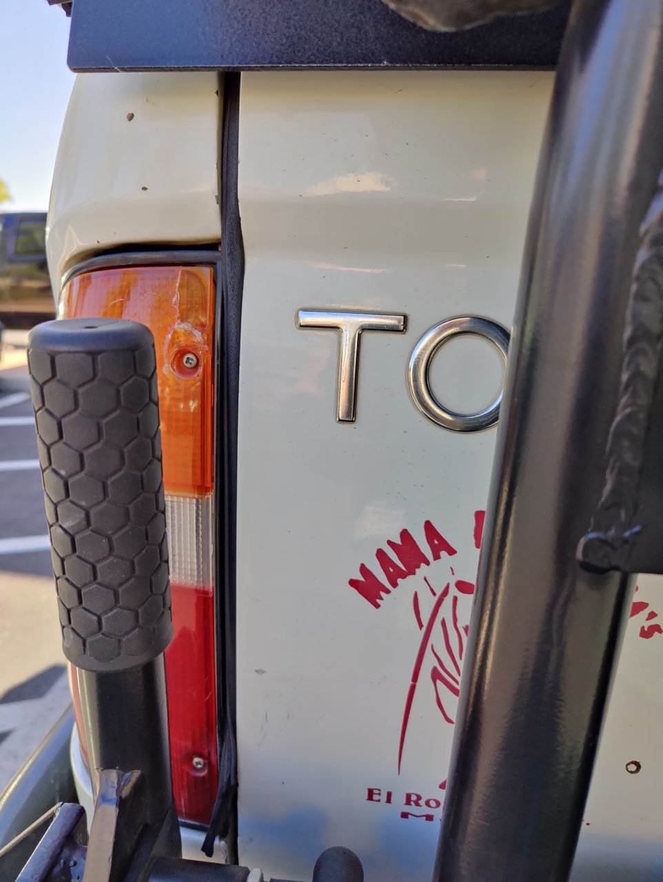

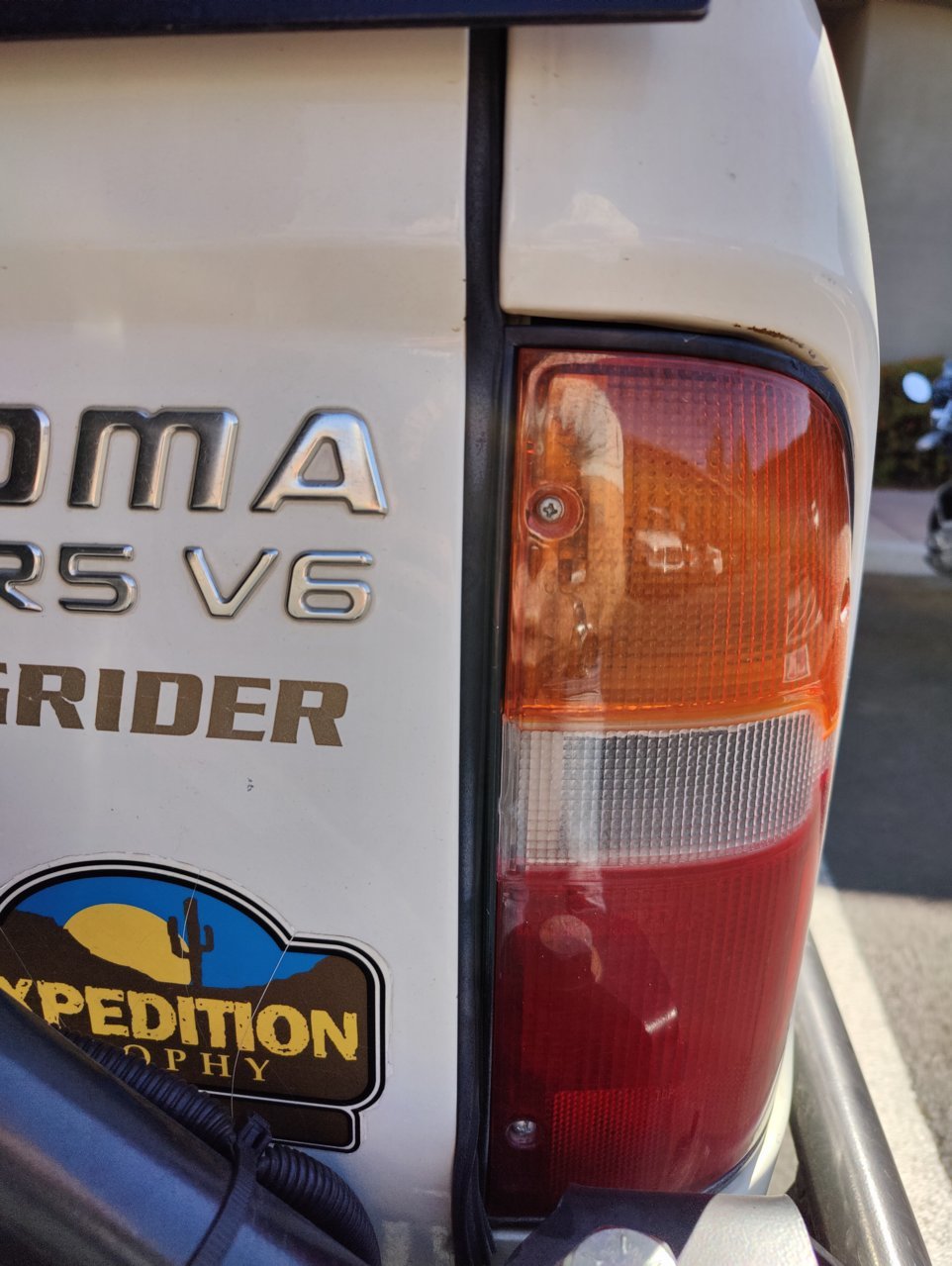

    For what it's worth, I've also got a 1st gen, xcab regular bed '98, so almost 25 years old, 282K miles, lots of 4wd use and full-time camper for all but the first couple years. No issue with gaps at the rear quarter panels and tailgate. Gap is 5/16".

    The 1" aluminum extrusion (80/20, tnutz) works well. I looked at Coroplast as well but went with baltic birch. I liked the look of the wood with stain and finish on it. Coroplast is probably not much difference in price but not sure. On the Baltic birch, I used 1/2" for the bench/cabinet tops and 1/4" for the side panels that fit inside the extruded aluminum.

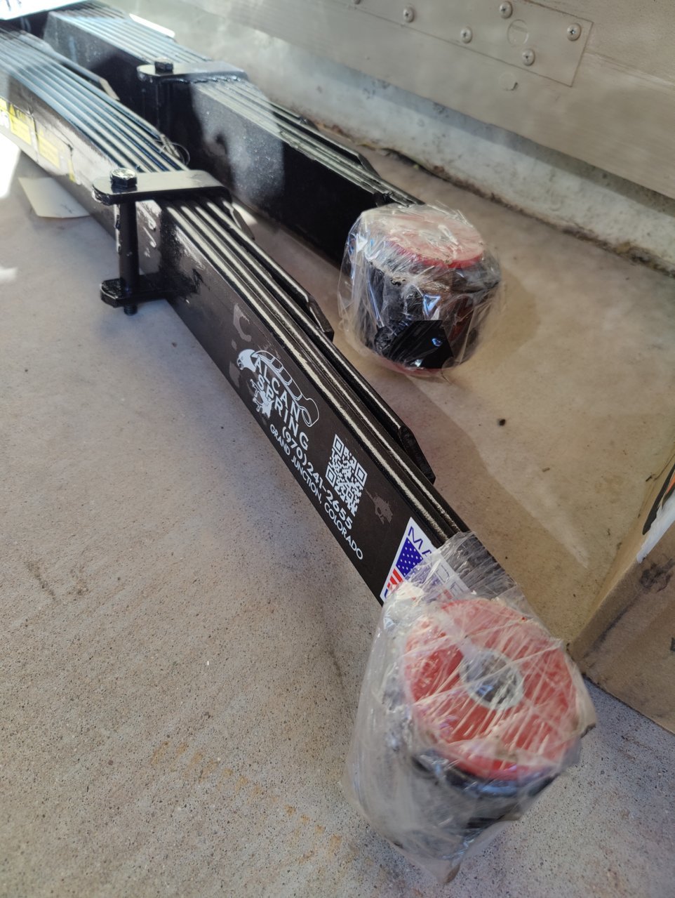

    I've had Alcan's on my truck for 19 years and they've been great. Now that I have the Drifter built out and added a rear swing-out carrier, it's much heavier than my old camper setup and the old springs are out of spec. So I just ordered another set of Alcans and will be installing them soon. I'm looking forward to getting them on there. Also, get the largest diameter shock and/or reservoir shock that you can accommodate, whatever your budget allows... the more volume, the more heat they will handle and less they will fade with the heavy camper and other loads at the back half of the truck.

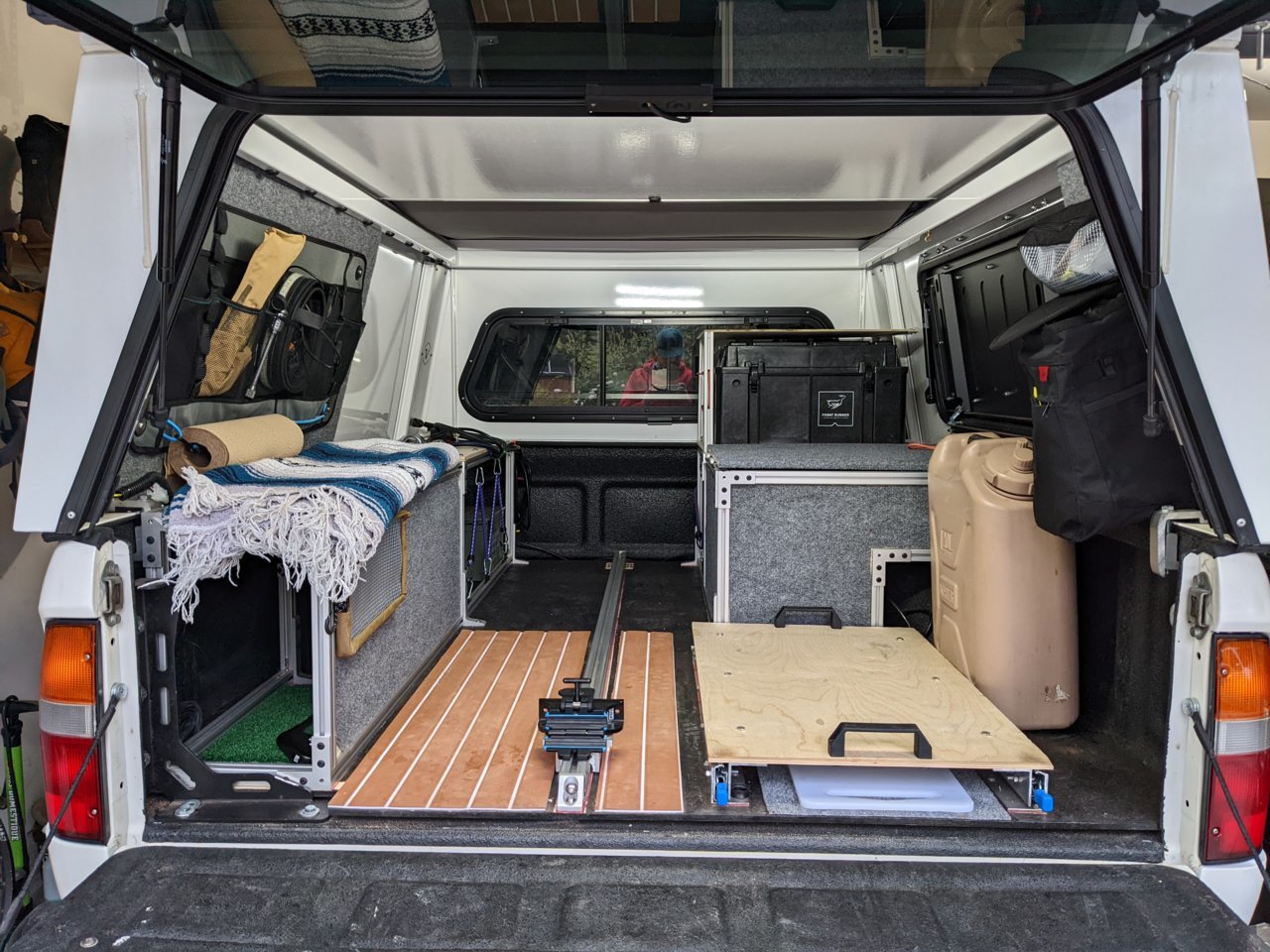

    Good to know. I have OME 90004 & OME 2880 coils. Its an area I dont know much about truthfully, just went with OME when my stock suspension was practically dead and figured it would be a good upgrade for my budget at the time. I reeeeeally am finding myself wanting an ARB front bumper now, so I think I'd need to get different coils for that regardless.
    Damn I just got unlucky I guess, something must be different with mine. Seeing your build is actually when I opted out of installing the stiffeners! Thankfully its stopped on that side, and oddly hasnt moved at all on the other.
    Thats good to know!
    Sweet, thats good to know. Im excited to see how different they feel.
    How specific of weight did you send them for your new pack? I've tried to get my daily load to within like 10lbs to be as accurate as possible, and then hoping that will handle my camping loadouts with the extra 250ish lbs. How much does your weight vary? I'm also thinking I might have Lew make me an additional leaf now to add when I eventually get a bumper so I dont have to wait when that happens.
    My current Dakar pack is so damn slammed with my camping load. Hoping it holds up for the next month and a half. Can anything bad happen with overloaded leafs?
    On another note, apart from some little finishing touches, I think I'm done with my build for this year. Kind of tired of thinking about it and buying shit haha. Have been camping the last 3 weekends so its a little dirty and there are some weird fitment things, but here's my layout. Just simple and useful things really.

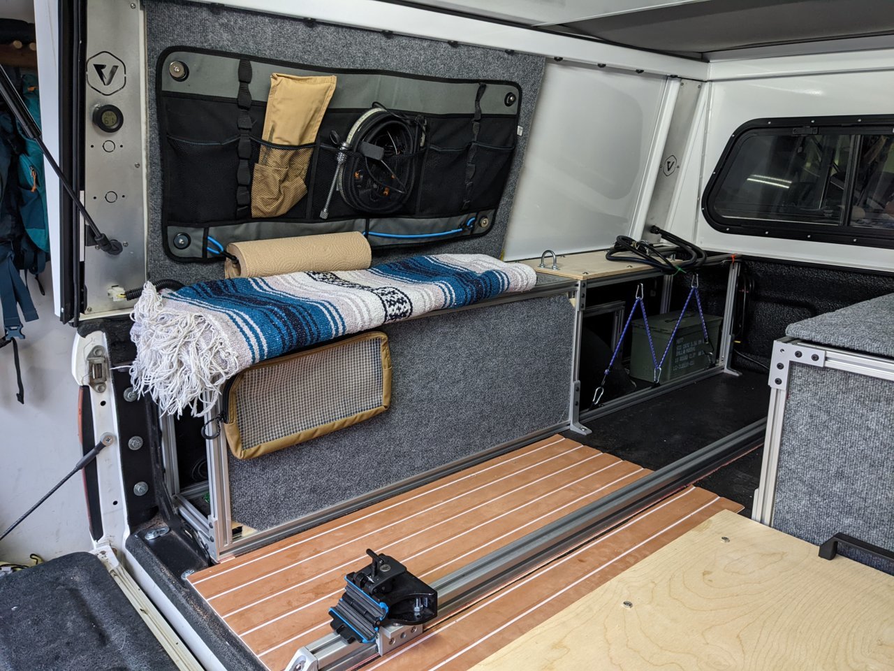

    The little bit of boat decking foam was a proof of concept to see if it would stick on the rather awful coats of Herculiner I did. Essentially just a soft place to stand/kneel, but the girlfriend is pretty adamant about me putting some fake grass in there. The practical side of me that doesn't want to clean it says no, the part of me that likes dumb aesthetics says yes..
    Someone said they wanted to copy the bike rack idea, and by all means please do, but DM me if/when you do. There's just enough play in the slider that the bike wobbled more than I'd like, so I essentially had to create a shim dock that the slider locks into at the back of the bed. And that's a grandiose way of saying that I superglued washers together and to my baseplate. Trying to figure out how to lubricate the damn thing still though.

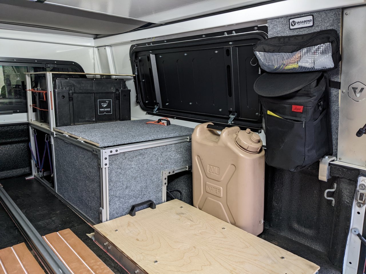

    Biggest dilemma right now is water. There's no straightforward place to keep my jug, and its a pain in the ass to get it out from the side of the fridge where it currently is. I want to get a bumper really bad, but I'm struggling to find someone locally who can make me one with a swingout with a 2" receiver, 2 jug tray, and fold down table. Also $$$. I hated the idea at first, but I've started looking at RIGd Ultraswings, but to get all the above features its such an insulting amount of money. Quality of life would be drastically improved with those things though.
    I know absolutely nothing about wiring, and only have a vague understanding of how the camper is wired. My brake light isnt working so I need to try to troubleshoot that but dont know where to start. And in addition to that to help learn how to wire things, I want to try to wire a 12v cigarette port into the wire tray that goes into an anderson connector for my Goalzero.

    For water you could quite easily build out the jerry can like one of the portable shower designs and then just use it to dispense water for drinking and general use. The nice thing with that is you don't have to move the jerry can to get water from it, and when it's time to refill, it is light and empty. Though putting it back in place it would be full. This is basically what I did, it was a very easy build. I typically keep a 1 gal plastic water jug for general use and refill that from the jerry can every day or so.

    I would run what you have if you get a bumper and see how it feels. Coils aren't hard to swap out.. it is a sketchy operation to compress them and the (search "Macpherson spring compressor") ~$100+ tools give quite a bit more confidence than the $20-40 tools.
    A place like this might have a water tank to fit beside your fridge slide and fill up the pocket. https://www.plastic-mart.com/category/33/rv-water-tanks 12V pump to a quick connect port, large enough opening that you can clean it and getting one clear enough to see level is about all you need to start. The more capacity the better imo, but everyone's needs are different. Definitely a permanent mount is better than moving jugs around. Mine is stuffed up by the cab underneath drawer flooring.
    Electrical is pretty easy, with just a lot of details and doing everything safely to keep the electrons inside. ;) There are a lot of tutorials on YT and threads around here for dual battery setups or the big electrical thread. You don't need to buy a third party kit for any of this, just start with a breaker near the starting battery and get some 6-10ga snaked back to the drifter. Pay attention to wire size vs length and amp charts. Protect the wire to not rub against sharp things, ensure it doesn't move, and put fuse protection on your devices. Use a multimeter with extreme paranoia of your work. Buy quality tools and components. Learning this gives you some freedom and some ability to troubleshoot issues in the field. Cruiser Outfitters is a good local place for advice and seeing examples, as is probably Wasatch Cruisers.
