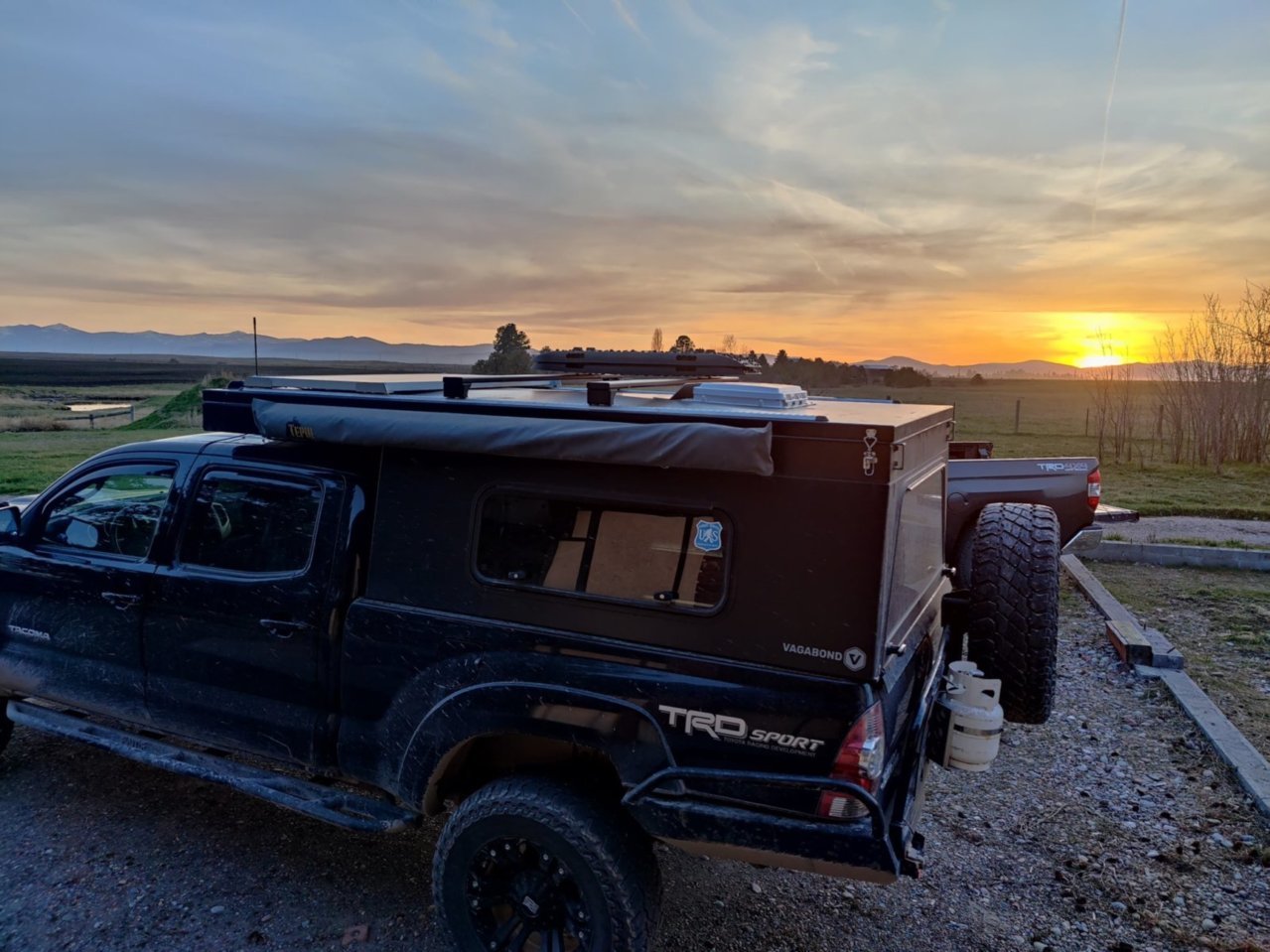

    Well, I would assume a 270 would make the STS mounts moot. The 270 mounts include a back-plate and whatnot, since they hold a lot more weight.
    We usually keep ours on the driver side (swingout opens to the passenger side), but can move it around as we please. The STS mounts on the rear are great for quick deployment over the Drifter entrance, but you'll have to use a pool noodle (or similar) in wet conditions, as the awning will not make contact with the Drifter, allowing water to channel down to the rear window.
    If your intent is to have a single (standard) awning, and move it around, then the STS mounts are the best option IMO.
    If you want heavier/non-standard awnings, then the hard-mounts with the extra reinforcements that Vagabond uses would be my suggestion.
    I decided to save the weight/size, and avoid the 270 awnings, especially since deployment may be impacted by the area we're in. I may end up hard-mounting a 4' awning on the rear of mine, and only use the STS brackets on the sides, but for now floating my single awning around has been just fine.
    I'm lazy and didn't go take a fresh pic, so this one's about a month old. Here you can see the depth of the brackets, so maybe the water comment above makes a little more sense.

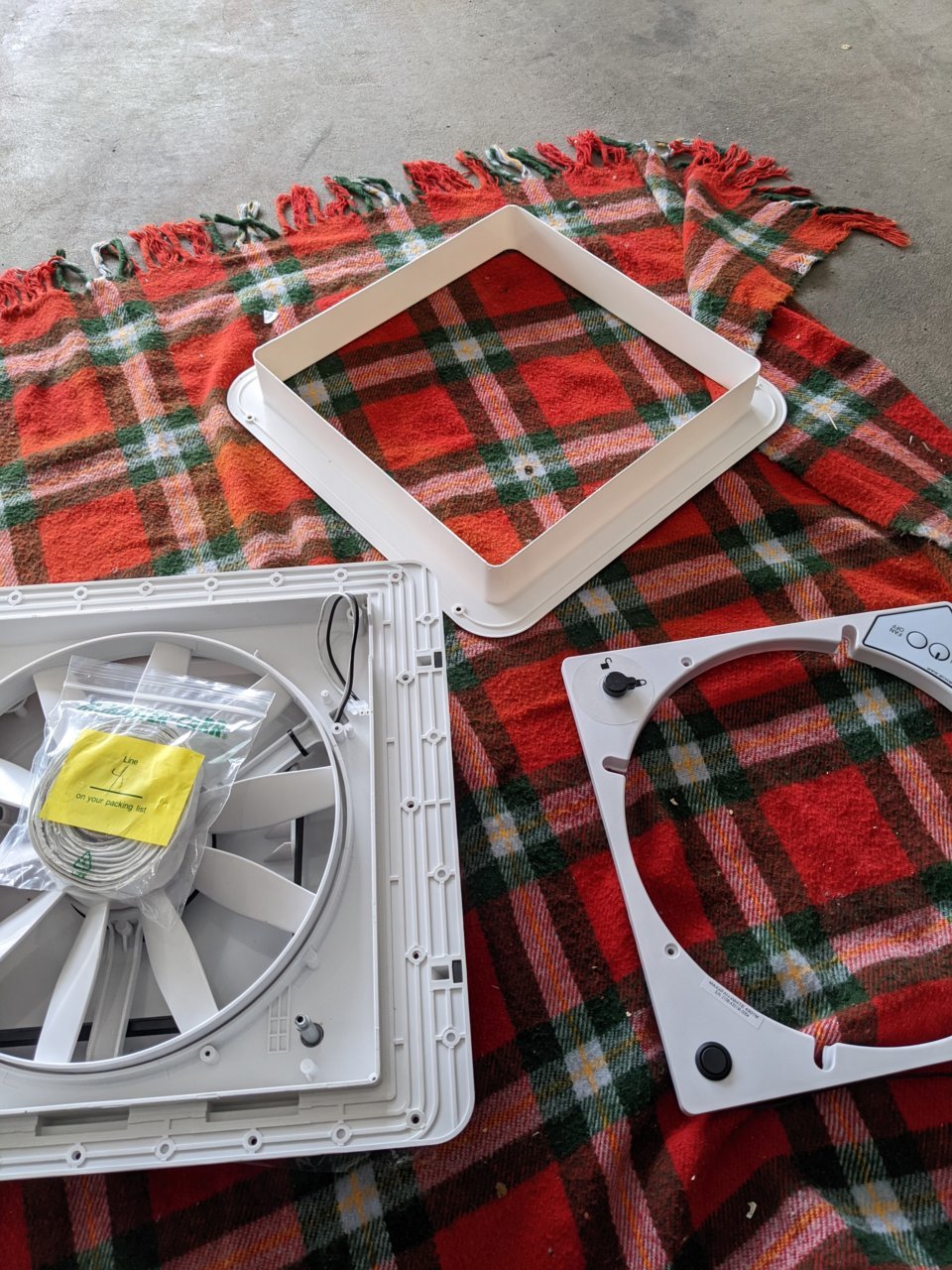

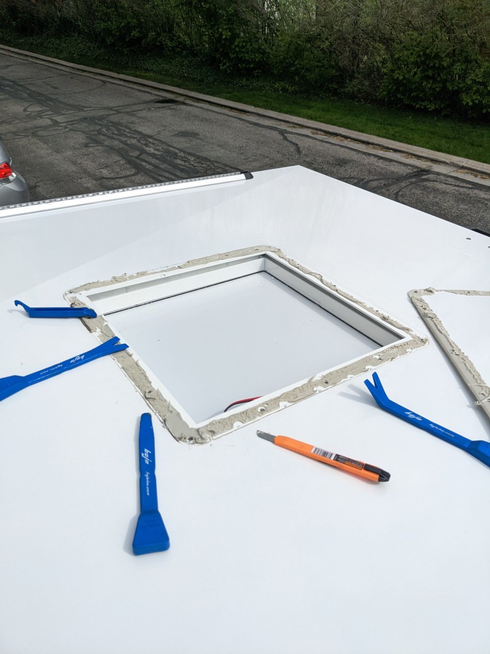

    Y'all better be ready to see the comical clearance I'm about to get in my garage once I get this fan on.
    But first I need help on understanding which way to orient the top piece in the second picture. I'm assume exactly how it is there, just straight up from the interior?

    Yep, that's right. Though you might have to trim it down if it's too deep compared to the thickness of the roof, or cut a slot for the wiring, etc.
    And I was right there with you on comical garage clearance at my last place.
    I had to adjust the door to run further up the track, remove the trim around the garage door opening, and hug the side of the garage opening due to the concrete sloping down very slightly on that side, and then I could JUST squeak in.
    I actually have a couple little scrape marks on the fan lid from times when the tank was empty or whatever, haha.

    Double check that the pins going into the connectors on the fan and the VO switch wiring are fully seated in the plastic connector portions. My fan stopped working on my third night and I found a loose connection up there.
    Also, when you stuff the wiring under the cover be careful about routing, mine was pinched and had already worn through the insulation in one spot.
