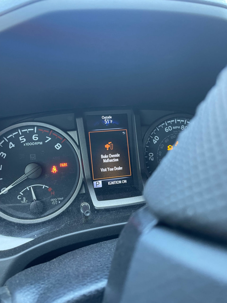

    long story of Drifter induced car problems but read on. Something useful to check.
    Washed my truck last Friday. A nice couple with another camper top of some sort saw the Drifter and wanted to see inside. Sure!
    Move the truck, open it up, show them around, close it up. Get in to leave.
    No start. Brake Override Malfunction.
    I try everything I can think of, check fuses (I’ve only added two add a fuse for Redarc charger relay and dashcam). Disconnect battery. Run reader and clear everything (there was nothing).
    Getting frustrated and running out of ideas I call Toyotacare and get a tow on a Friday at noon. Get nowhere with the dealer Friday.
    Monday morning (dealer doesn’t work weekends) I head to the dealer to unload my fridge I left full all weekend. Dealer states they are leaning towards an issue with the tail lights after checking all fuses, dashboard, etc. I know exactly what it is.
    Take the service rep, open up the Drifter rear window and I see all the Drifter tail light wires were all worn through. I had noticed they were started to bend and wear before. Bingo. Unhook the Drifter cable. Ask for the keys to check it-no keys and they can’t find the tech. Of course.
    Very long story short (finally got my truck back Wednesday afternoon) it was the shorted cable which shorted the brake circuit which I’ve heard can also be caused by bad tail lightbulbs or bad bulb installation.
    A reminder to all who have played with any of the factory wiring/fuses/settings/etc to check it for worn, frayed, corroded etc conditions from time to time. These new vehicles have every little thing ran by a computer so some simple lights or worn out cable can leave us stranded.

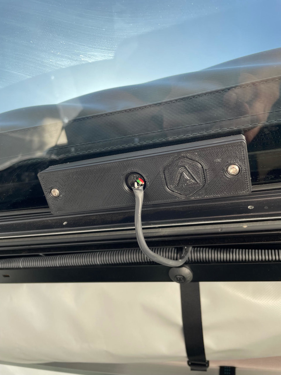

    The 3rd brake light on the Drifter needs a better stress relief on the wires coming out of it. I have a replacement that I still haven't installed because I haven't fixed this issue yet on the replacement (and forgot about it since I run a 3rd brake light on the rear of my bike rack at license plate height.)

    I had been noticing similar stress on mine, but never saw any wear of the individual sheathing. However, this prompted me to go take a closer look, and I found that the brake light is almost not even illuminating anymore, so looks like I can add another little project to the list.

    Yes. I had noticed the loom coming loose and then then the wires starting to wear but didn't think much of it. Tail light goes out. I fix. Yah no, whole truck goes out.
    New project to dig into and hopefully fix. Small cables to buy and a soldering iron perhaps. Or just remove and live with two normal brake lights and assume that's legal...

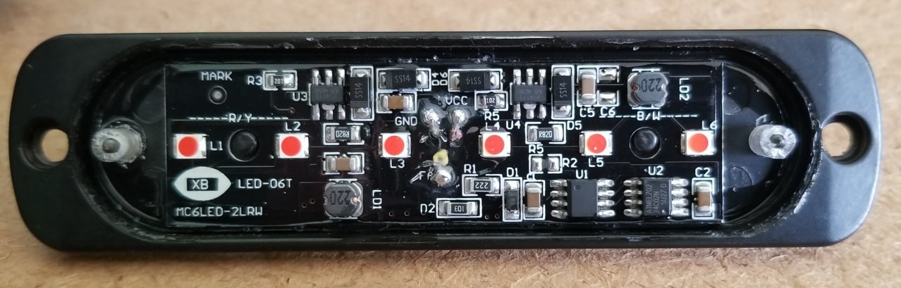

    Here's a pic of the internal board in my 3rd brake light, in case anyone wants to dig around to find a direct replacement (outside of going through VO).
    ....Though I didn't have any luck finding the same thing (in red), and the matching ones in other colors were really just alibaba listings anyway.
    The lens mounts broke when trying to unscrew those, half of the LEDs were out completely, and the other half very dim, even testing directly to the solder points, so I'd suggest it's not worth trying to fix if yours goes out.
    I just ordered a few different similar options off Amazon to see which one will work/adapt best.
    Note that I was in the first batch, so maybe it has changed since.

    Interesting. The board looks like it's epoxy coated for water resistance/waterproofness even though it's mounted inside the Drifter. The solder joints on the surface mount components (SMC) don't look bad, so I'm not sure it's a cold soldering joint failure or other component. Could be a resister, capacitor, or another component.
    I think I found it on eBay: https://www.ebay.com/itm/292961061711

    It is coated, but not very well.
    Powering the individual LEDs, they were still somewhat functional, so probably definitely one or more other bad components. But I'd rather just swap it out, especially since the lens mounts broke anyway.
    And yeah, I found several amber and blue versions, even on Amazon. But no red, strangely.

    That's definitely not the same one I had, but it looks like it may just be an updated version, as it seems to match up dimensionally.
    Interesting stuff. I might have to try this out now.

    Ok, I see now. These seem to only ever be labeled as "strobes", but they're all a standard size, and can be found on all the major marketplaces.
    The one originally installed on mine appears to be the generic versions I'm seeing on Amazon/Alibaba/etc.
