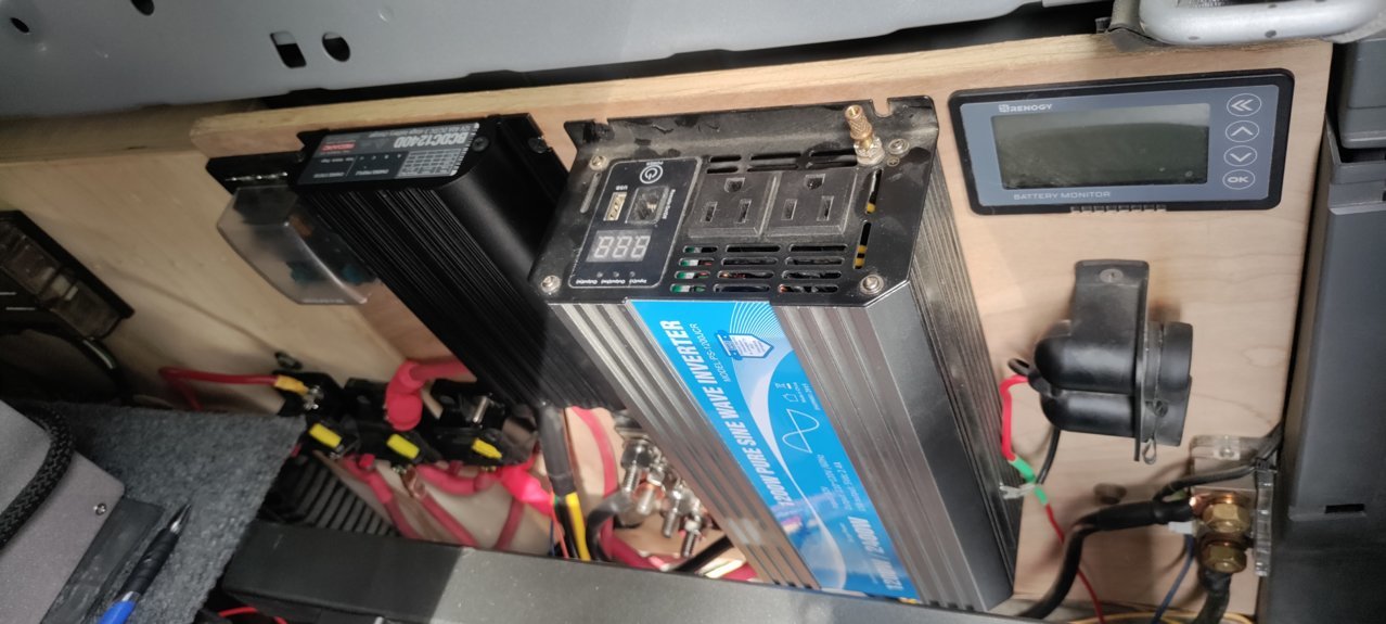

    I'm actually in the process of re-doing the wiring that Off-Grid installed for my bed power cause it all went dead from being corroded. Besides some it not being shrink wrapped very well, I think the issue most likely came from a water crossing that was deep enough to submerge that area around the rear bumper.

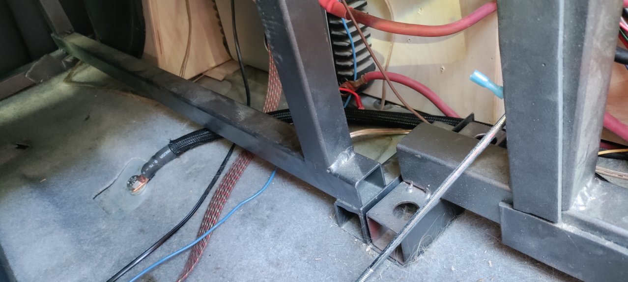

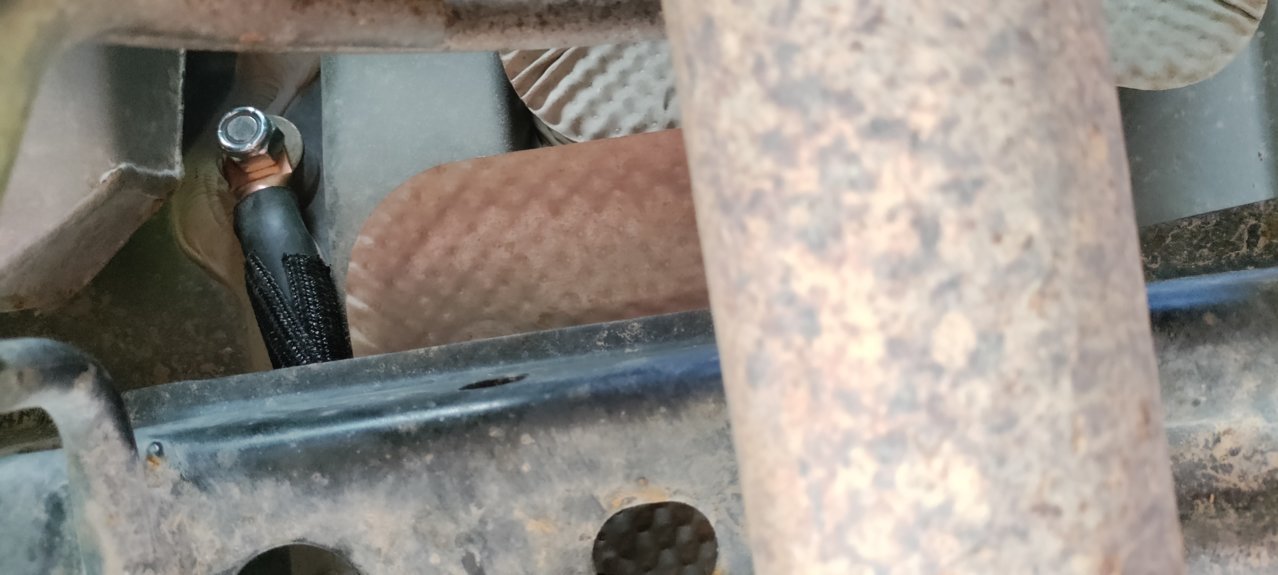

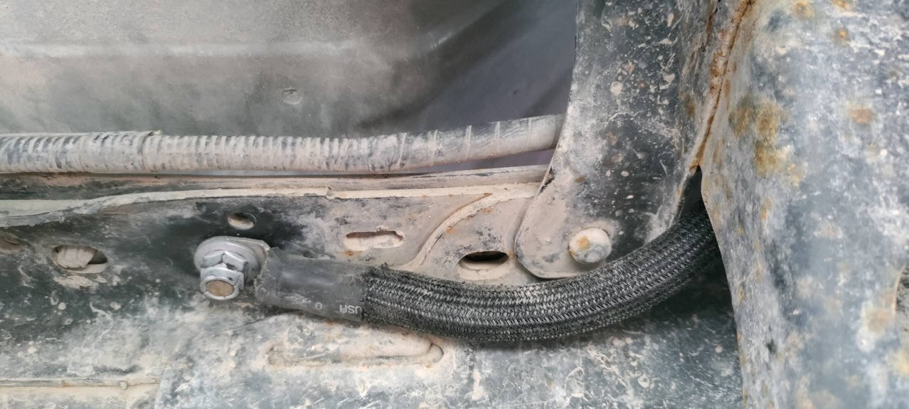

    I've been doing some glamorous work in beautiful sunny weekend weather, adding grounds and redoing my panel. Grounds seem to cause the most issues and can cause bigger problems with high loads.
    I had an old 1/0 cable. It worked out well to just cut and reuse. WTF are Toyota using M11(???!) bolts to secure seat brackets to the cab?(my passthrough to the frame) At least 7/16-20 are very, very close.

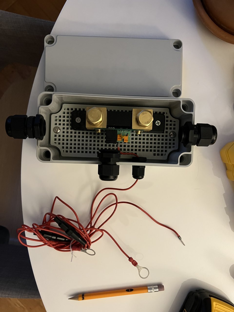

    Figuring out my shunt in the engine bay situation. Couple of glands and a waterproof box, going to VHB it to the battery bracket, probably.
    Think i might have to do some rewiring of my ground wires to make it work?

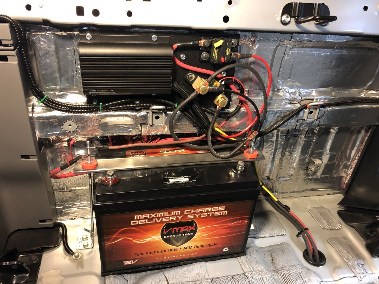

    You are correct that for it to read properly, the Victron Shunt needs to be close to your house battery as you are planning on doing. All the negatives (including the Redarc) get hooked to one side of the Shunt and the negative from the house battery to the other side of the shunt.

    That is how I have mine set up, yes. Full positive & negative runs for the system. As to whether you can work around that, I can't honestly say. It just made sense to me at the time I did it to run them both for the system.

    As answered, no because it will likely be further away and you want the shunt close to the battery you want to monitor. Your shunt knows nothing about the starter battery because its ground is taking a different path. A simple ignition switched voltage gauge would work fine to monitor the starting battery, unless you want All The Data(tm), then you'd want to use another shunt/reader.
    From my pic above, I use a negative bus bar (left of the inverter). Shunt is bottom right. House battery negative to shunt, shunt to neg bus bar. Distribute off bus bar. Tie to cab+frame ground at bus bar too.

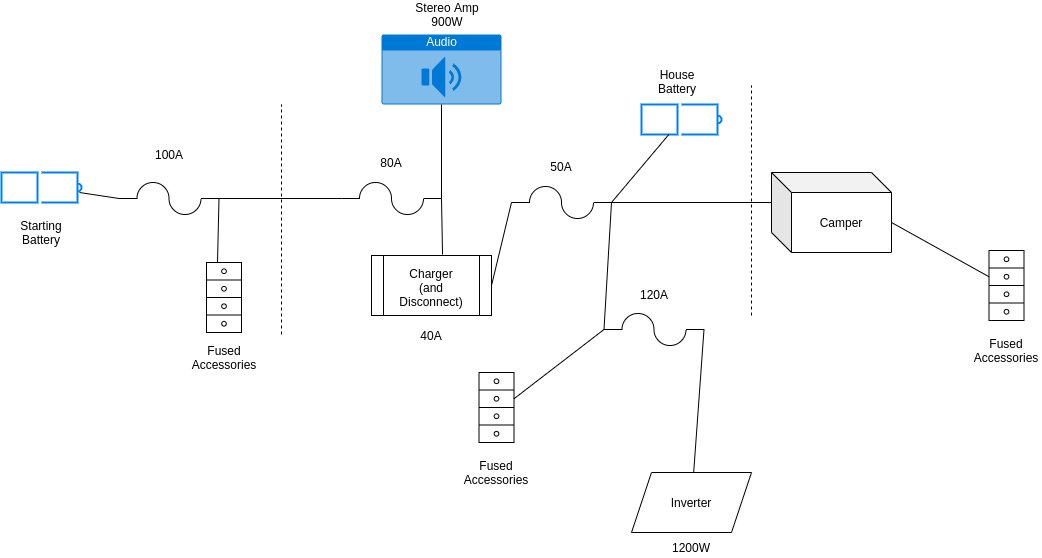

    Here's a diagram of part of the system. It is super helpful to have a print for arranging components.

    Dope. This is super helpful, thanks! This is what I have in my head:
    Really putting that graphic design degree to use here.

    Yep, that'll get the job done.
    A couple minor points to consider (if you're not already aware)
    • Ideally, you want the wiring between the BCDC and house battery to be as short as possible to minimize any drop in the voltage that the house battery actually gets compared to what the BCDC puts out. Better to be closer to the house battery, and further from the starting battery if it has to be one or the other.
    • The fuse and breaker between the house battery and fuse panel is kind of redundant unless it's like a class T fuse that provides a slightly different protection (but those aren't used as much with lead acid anyway). Redundancies like having both a fuse and breaker does add a secondary point of safety, but also creates more voltage drop and more points of complication or potential failure, so it's a trade-off.
    • Also, just be aware that a single shunt in this config mainly just gives you the net inflows and outflows from the house battery, so if you've simultaneously got 100W of solar coming in and 105W going out to lights, fridge, & chargers for example, the shunt only sees and reports that as the 5W outflow. Now, if you're ONLY discharging or ONLY charging, you'll get the info solely on the full in/outflow of course. But the reason I say this is that because lead acid batteries aren't the most efficient with the power they take in, amp hours in and out over time is not a great indicator of state of charge for lead acid. As a simplified example, if the shunt sees 200W outflow overnight, it will likely be reporting the battery is at 100% state of charge once it sees 200W of solar inflow the next day, where it might take like 215W to actually get it back to 100%.
