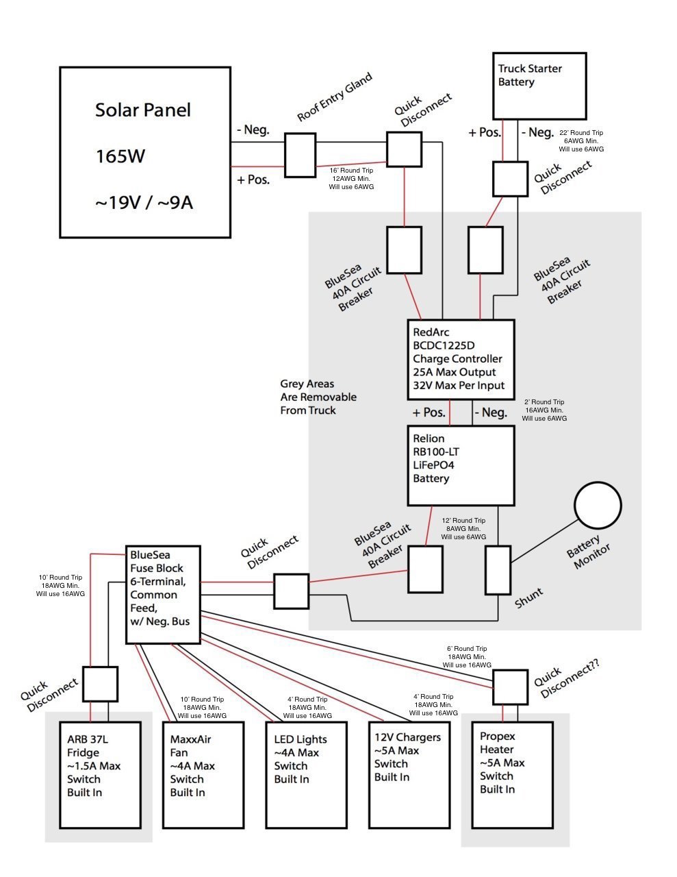

    Thanks! Appreciate the insights. Not much out there on this configuration so I’ve been filling in gaps (as I said, art degree, lol.) But… yeah, mostly aware. Pros and cons of making something that is unassuming when parked on the street and using kits.
    I thought the fuse near the house battery was odd, and thought that was why I bought the Blue Sea stuff, but it came at recommendation of Phil so I just said yeah, do it. I have a fairly minimal set up for now - but wanted the ability to scale, so happy to remove stuff over time. Next up is probably a bed mounted air compressor, then a fridge but that’s probably out a few years.
    Thanks again!

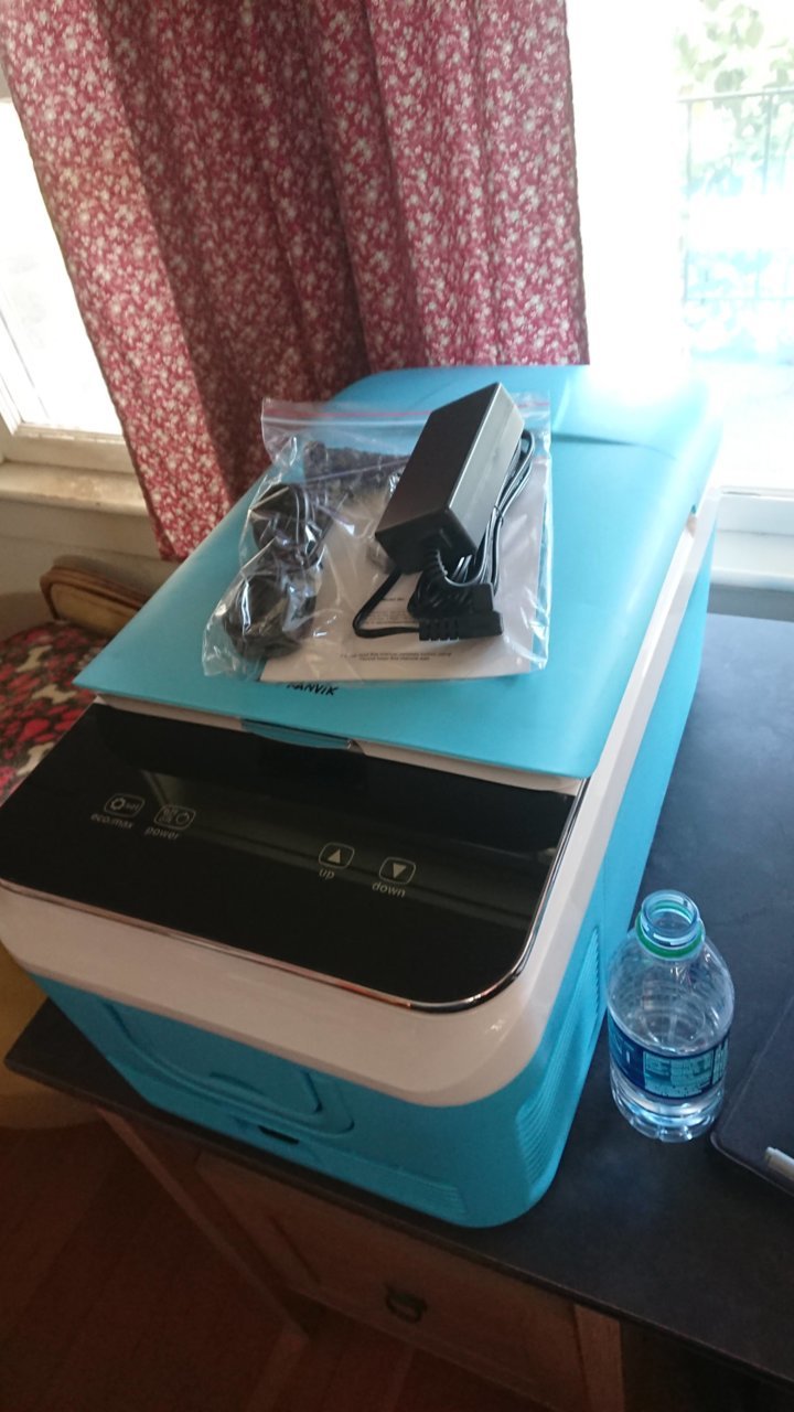

    Get something like this for only $190 (it appears to have a latching lid vs compression fit, which is what I look for) https://www.amazon.com/Portable-Refrigerator-Compressor-Electric-4℉-68℉/dp/B099F5Y2PW
    They have mini Danfoss compressors or knockoffs. I've been solely using mine instead of bringing the 50L Dometic. The 16qt worked fine for 2 weeks in Baja last trip. And the prices of the larger fridges have been obscene. Two small ones for $400 and you have a more storable dual-zone fridge/freezer setup. You may find you don't need a large one after a year or two with a 16-20L fridge.
    Here's what I have. Ausranvik, a legitimate brand but I haven't seen this model available for a long time. They make cheap larger ones now (40L for $3-400). If you dig around Amazon has a huge variety of the small fridges. Just make sure it is fridge/freezer which implies it has a compressor. Similar features as the big ones and they draw a bit less.. maybe 40Wish.

    I see. So that's actually good then - you definitely should have either a fuse or breaker as close as possible to the house battery on the positive output. Phil was right to do that for you.
    If that fuse is already there, then you can eliminate the breaker. Unless the breaker has a smaller amperage rating, then the fuse will blow before the breaker trips anyway.
    I'd say just make sure you have an extra fuse or two in case it ever blows, OR you could also just replace that fuse with a breaker instead.

    I pretty much had what @snwbrdr852 said written down and agree with him. Fuses/breakers are there to protect your wiring. In your drawing I notice the fuse off the Redarc/truck battery is on the passenger side when it should be on the driver side near the alternator/batter/RedArc. You might have caught this but it just stands out to me. Take my setup for example and consider my compressor your house battery and notice my breaker & fuse block are near the starter battery & not the compressor (your house battery). The second breaker feeds the setup in the bed with my RedArc & house battery.

    I agree with the above comment. Rule of thumb, always try to fuse within 12 inches of the battery. Your Bluesea fuse panel provides fused protection to other small circuits, but you want to protect the wire coming from your battery first.

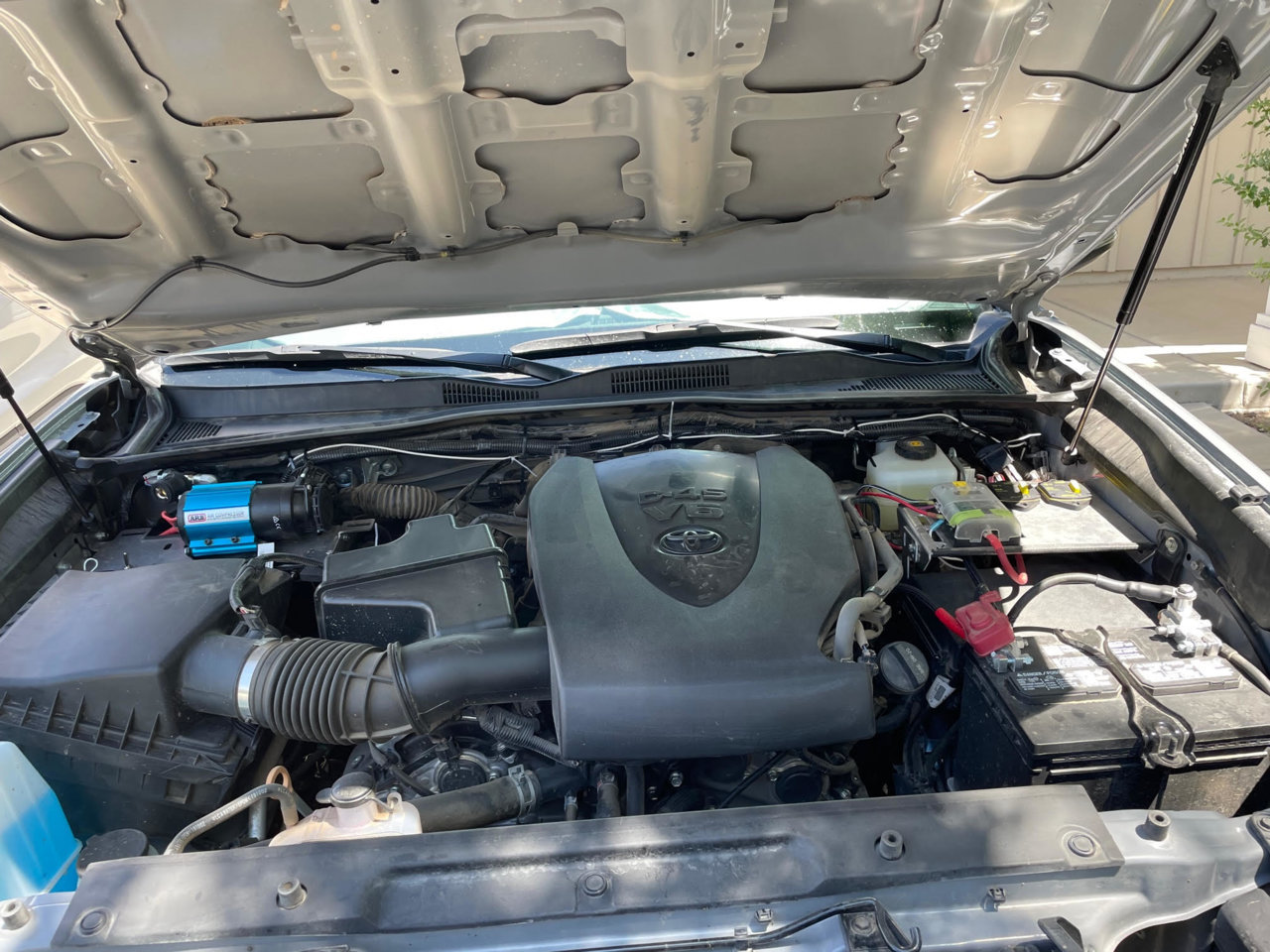

    Got some clean up (shortening the B1 wire, VHB for the shunt box) to do but finalized my shunt situation. Thanks for all the help, everyone! Just over here trying to design a solar set up that is primarily in the engine bay as to not tip its hand too much.
    To answer some of the feedback re: breaker - that was a brainfart on my behalf - I wanted an off/on switch, the local West Marine didn't have one in stock, and I needed to get down to Benecia for my install, so went with a breaker for off/on to control all power in the bed of the truck thinking it did the same thing with added benefit, not thinking about dropoff. I wanted the ability to kill stuff quickly - in case of emergency or otherwise. Didn't think about the dropoff at all until you all pointed it out, but that's an easy swap out.
    Kept the fuse block near the battery, as well. Did end up dropping B2 to solar fuse as I was unable to discern any difference with that configuration. But maybe I did something wrong.
    All in all, I'm happy with how clean the install is going to be when finalized -- will post pics when cleaned up with a quick overview. Need to shorten the B1 line first, didn't have a good way to recreate the shunt-side of things for the wire at hand, so have to head to an electronics store.

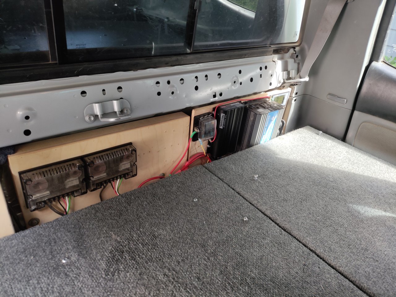

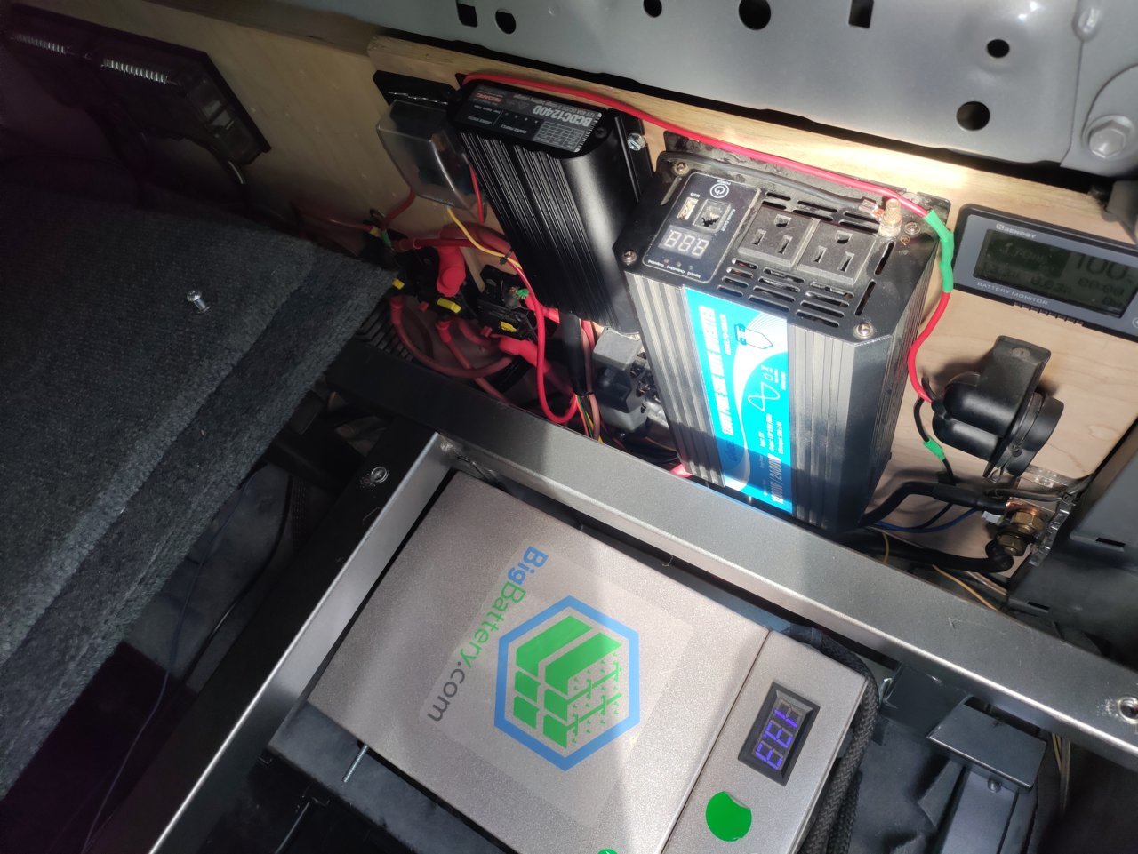

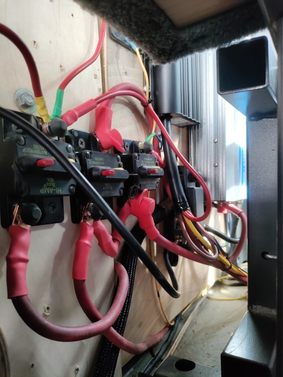

    I worked on mine over the weekend and got it functional. Still need to do some better wire routing and cleanup, but it seems all in the right place. Was able to reorganize some things differently from my v.2 to be easier to deal with, namely easy access to breakers and fuses, and being able to see all status LEDs easily.
    Modified all the lugs with incorrect hole sizes to the right ones, and reused most of the v.2 wiring with only mods to the lugs and maybe one or two completely new cables because of length. Very happy how easy it is to build now.

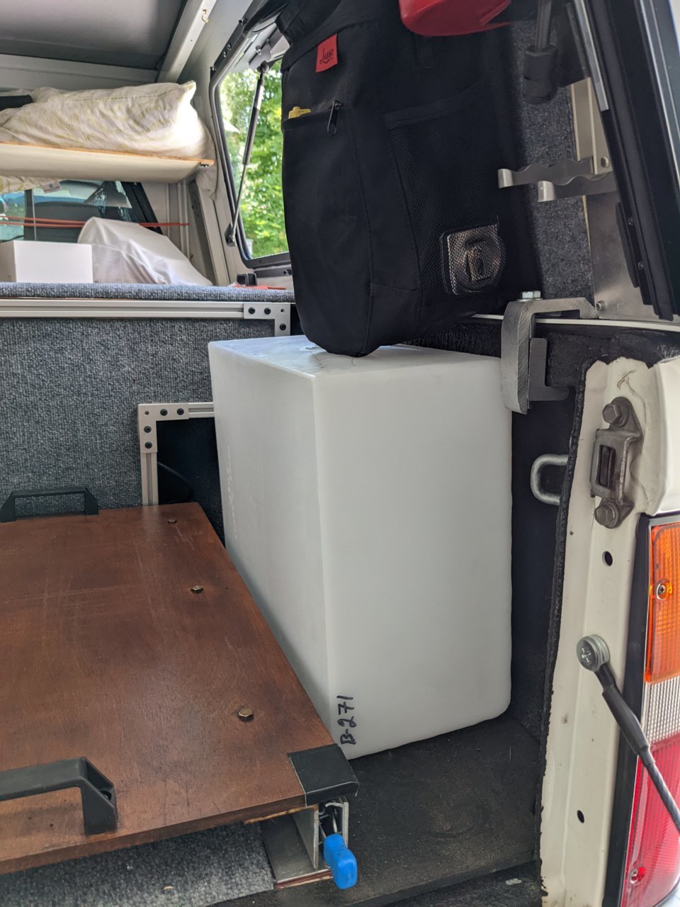

    Got my water tank. Thankfully one of the cheaper dimensions was the only one that would fit next to my fridge. Way too lazy to pull everything out and drill something to mount it to, so I'm just going to build a little elevated cradle for it, and between that, the c clamps that it fits perfectly between and the fridge, it doesn't have anywhere to go except up which I don't intend on driving in any way that would create those forces haha.
    I'm going to do a rain barrel spigot and a hose that leads out over the tailgate to gravity fill things. But in order to screw that spigot on from the inside I need to be able to get my hand in there, so I'm going to end up putting a marine inspection hatch as the lid. Hoping that seals well enough.

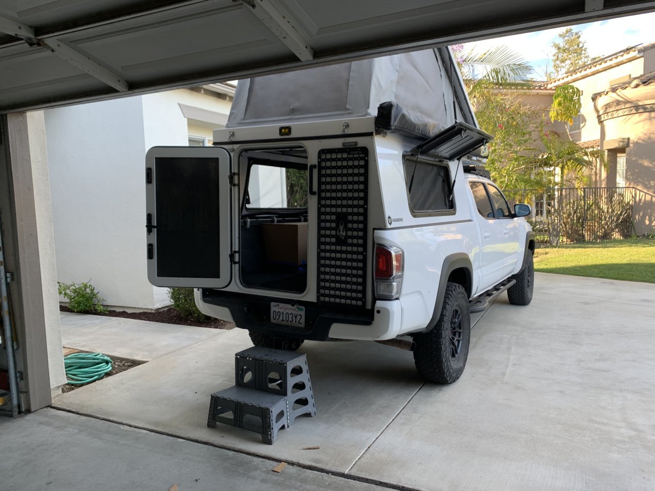

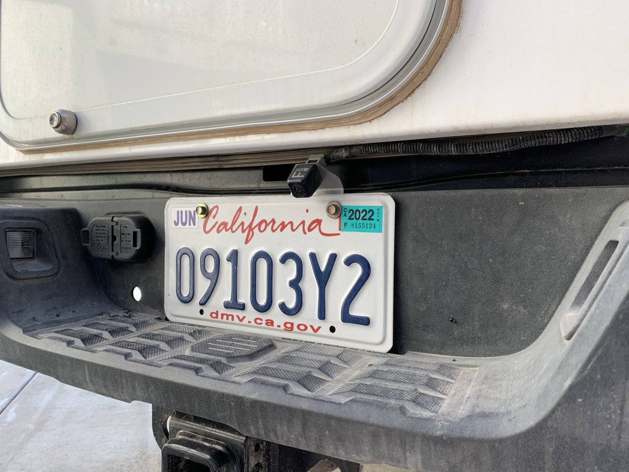

    Anyone out there with the Arctic Tern Door option? Would love to see pics if you got-em! I know @jimlangfordphotography has one and it's awesome! I have ordered one and am excited so.. need something to swoon over till then.
  14. Jun 15, 2022 at 8:03 AM
    #6494
    jimlangfordphotography Well-Known Member
    Dec 1, 2018
    #274423
    226
    2020 TRD OR LB
    Here ya go!) Working on the interior build.

    love the back door that should be standard in my honest opinion. how does it seal up against the bed where the tailgate should be. any pics?

    Love it so much Jim! Can't wait to see the inside!

    These are the best I have. Looking back I should have taken more of the sealing surface and the lower brackets.
