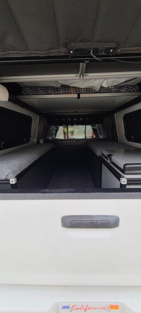

    Maybe by lid he means the roof?

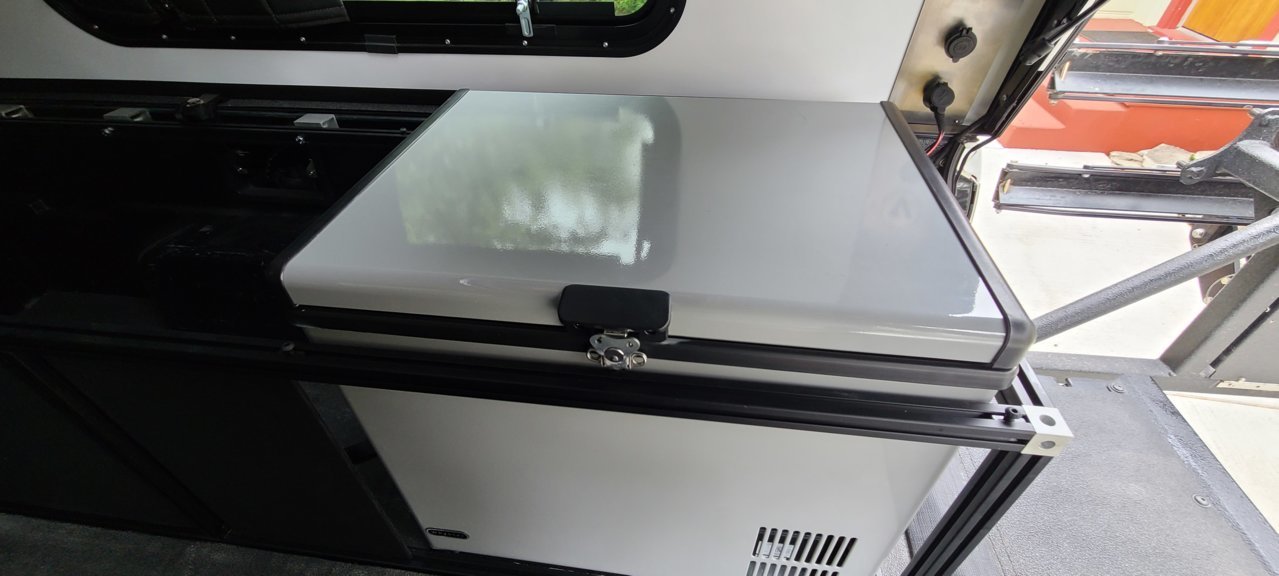

    Whatever the case, I use your method (thanks for posting the picture!) using my homemade bed extension panel in the same way. Been great to have the fan running when I'm working on little interior build details in the driveway but don't need to pop the tent up.
    Heavily borrowed from the build Jerry did:

    Not sure if I missed this, but how did you make your bed extension?

    Might have to pull everything out and do this. Foam board I assume? Seems pretty straightforward sans the cutting out Window hole. Adhesive to the side panels?

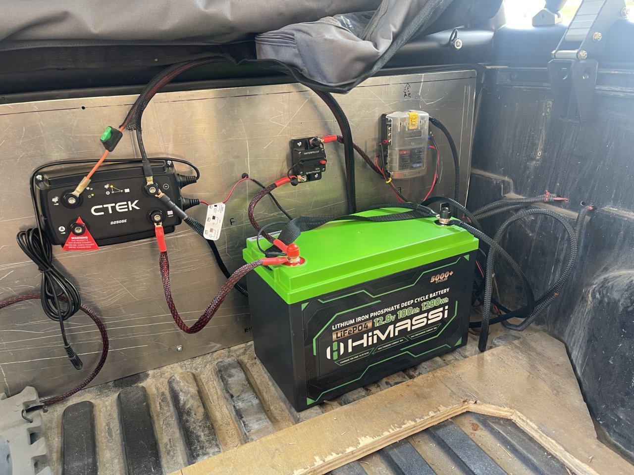

    your head and my head work very similar. And I know nothing of electronics.
    I used a CTEK D250SE (instead of BCDC), and different batteries - lithium/standard. Also I have a different camper :anonymous: but great minds think alike?
    Ive also cleaned up the wiring, attached the temp sensor to the battery, and made a battery tray.

    I just made a rectangle out of spare 80/20 pieces I had and skinned it with 1/4" starboard HDPE sheet leftover from the bed storage build.

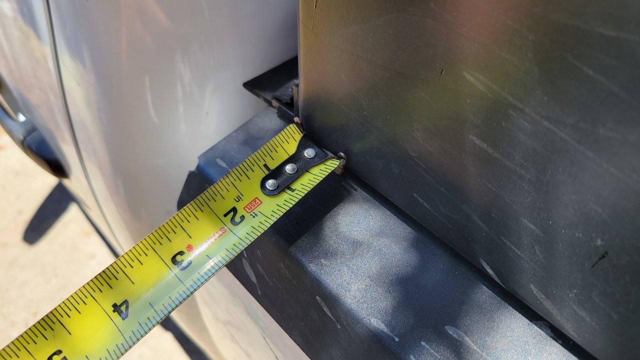

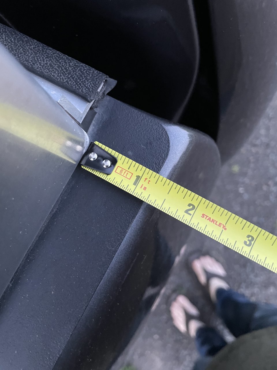

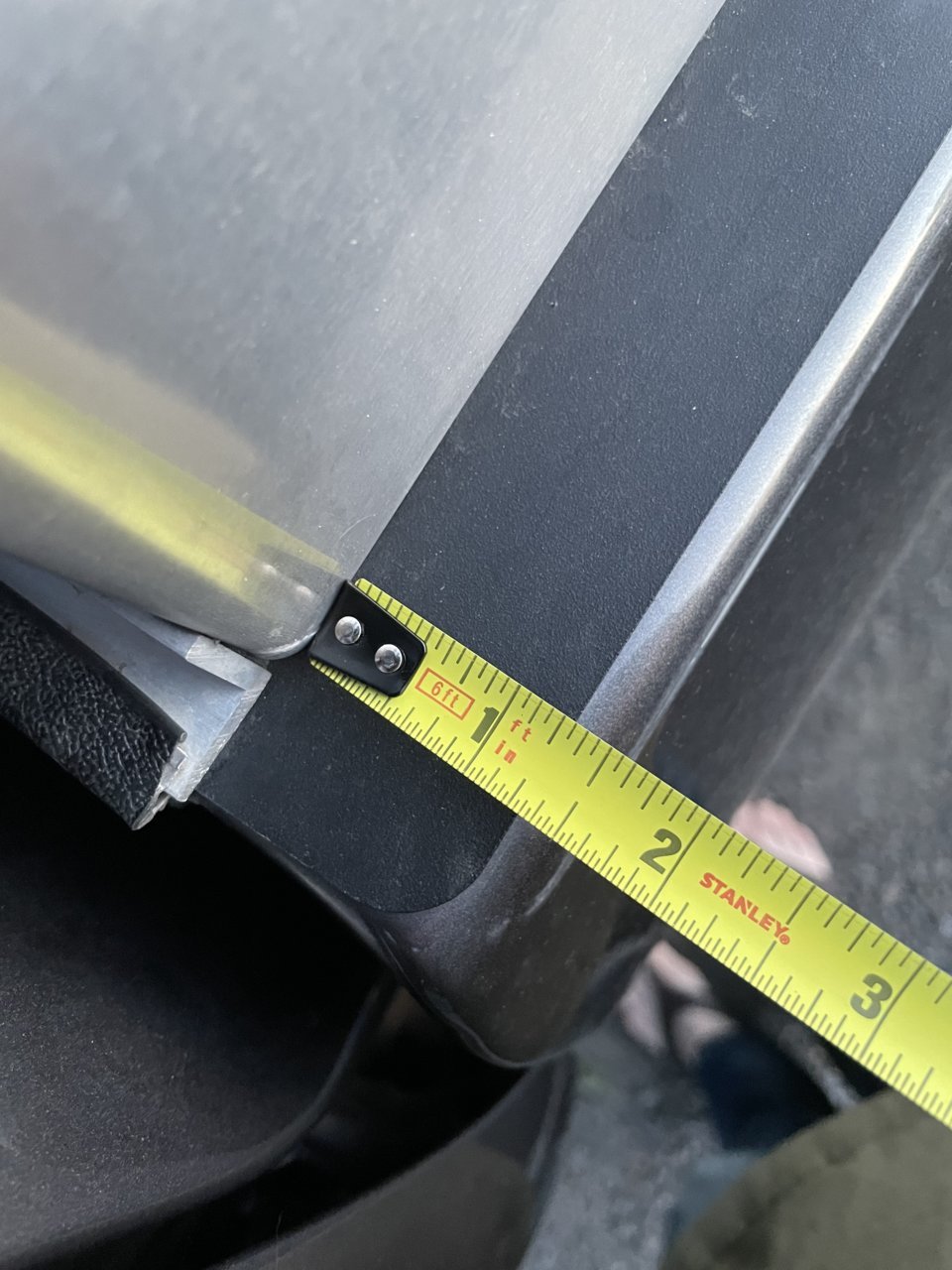

    Could someone with a 2nd gen 6’ bed measure the distance between bedrail cap and Drifter for me?
    I have about 1 1/4” on both sides. Some have thought the camper is mounted off center, but the distance is similar on both sides. I am now wondering if some of my leaking in the corners is due to very little coverage of the drifter on the bedrail cap (only 1 of the tree bulb seals).
    Thanks.

    I'll check when I get home in a few minutes

    Driver
    Passenger
    I have the bed rail caps provided by VO

    Washington
    2015 Tacoma OffRoad w/ Drifter
    Thanks! Yes, I am using the KB Voodoo aluminum rails that VO sells. And it looks like you have a 1 1/4” space in both sides as well. I am going to replace the triple bulb seal and the bedrail cap seal and hope for the best.
