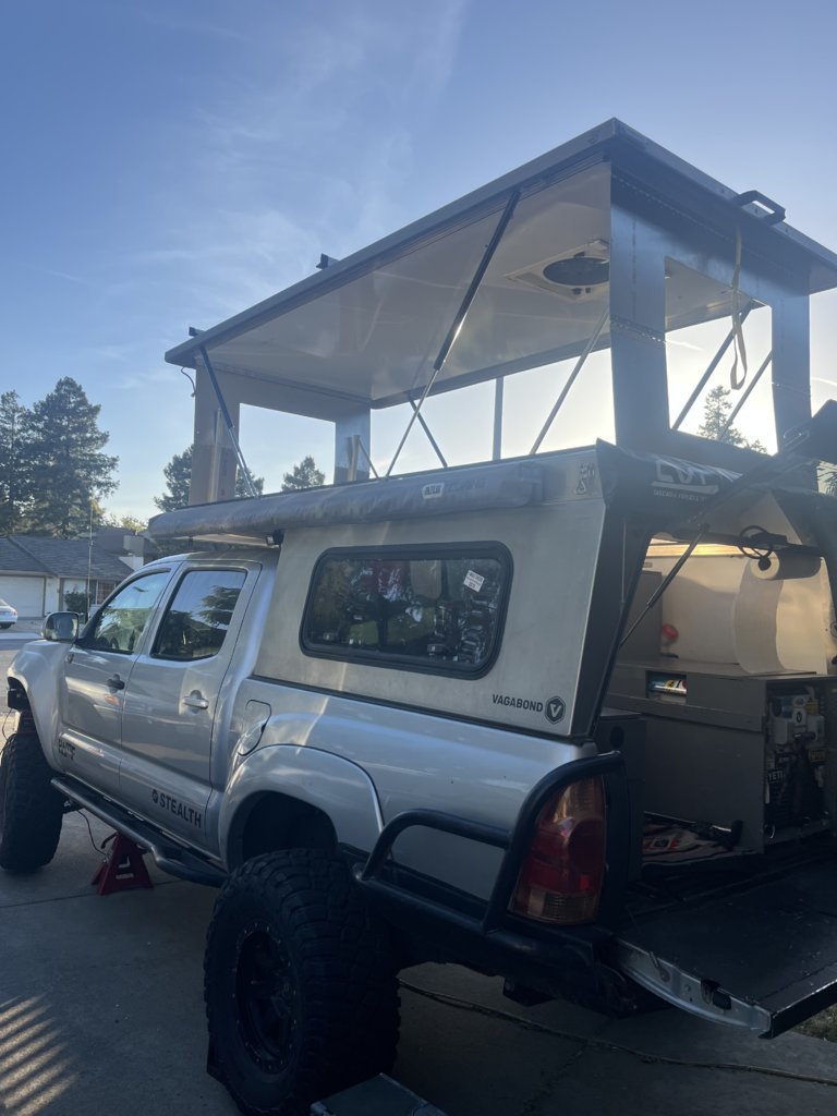

    Been doing some things....
    I decided to finally make a bed platform lift. The long in short of it is I made a frame out of aluminum angle and strapping riveted together, cut down the existing bed platform to make it a few inches narrower, then bolted it to the frame. I screwed the hinges to the front of the platform, and bolted some aluminum angle to the side rails to create new mounts to support the platform when it's down. A couple of 50 lb struts do the lifting. Still need to finish placing the carpet tiles, but you get the idea.

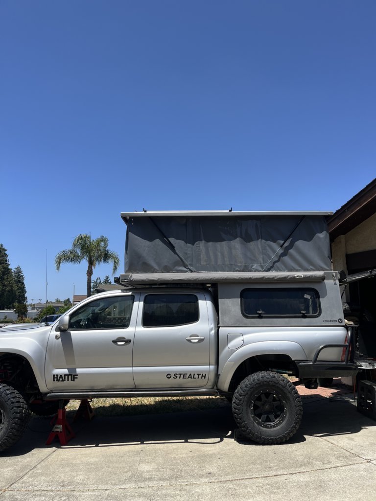

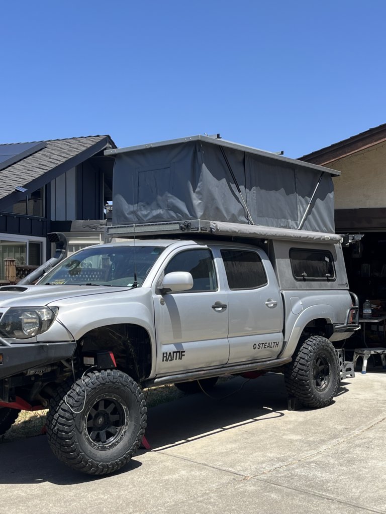

    The kids are bigger and I need more space. Decided to transform the Drifter to a pop up. Still working on the new tent fabric, but making progress

    Almost there. Just a few things to work out

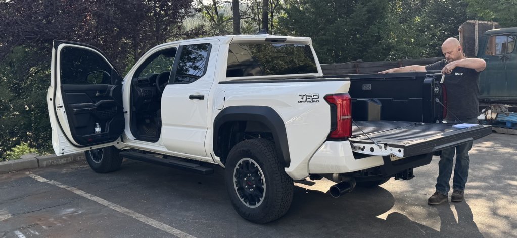

    Day one of the BAMF Drifter build, very early stages. Met Jerry at the new BAMF location; he began by ensuring the drifter will fit our new 4th Gen truck…good news, it does! Can’t began to thank Jerry enough for jumping in to get the build going after years of disappointment.
