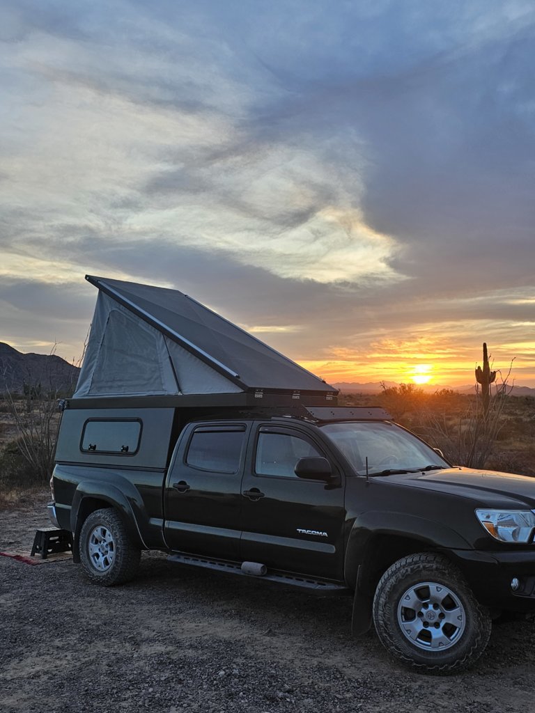

    Here's a pic of mine, since I haven't shown it off yet :) I live in it full time, when I'm not away for work.
    rob1208 likes this.

    2014 TRD Frankensport 4x4 AC AT
    Partial list: Vagabond Drifter 3rd Gen OR rear axle 4.30 gears Bilstein 6112s and Tundra 5160s.
    I also lived in mine for awhile. Would love to see how you have configured the interior for full-time living.
