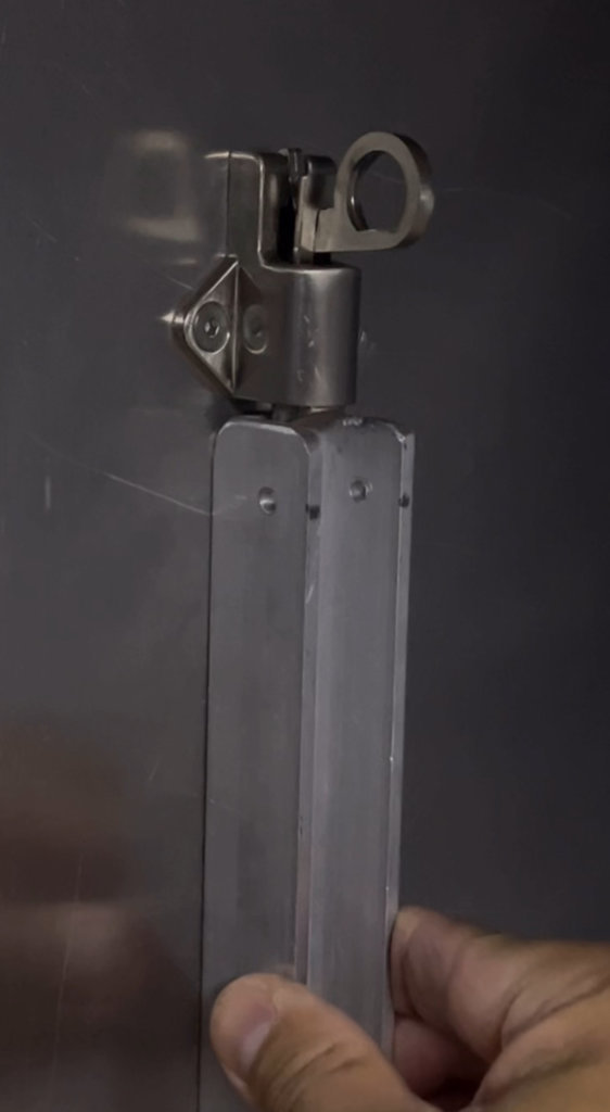

    But yea for the aluminum panels with the hinges, I also added a u-channels to each side of the panels to fully open the tent and spring loaded latches to keep them locked in

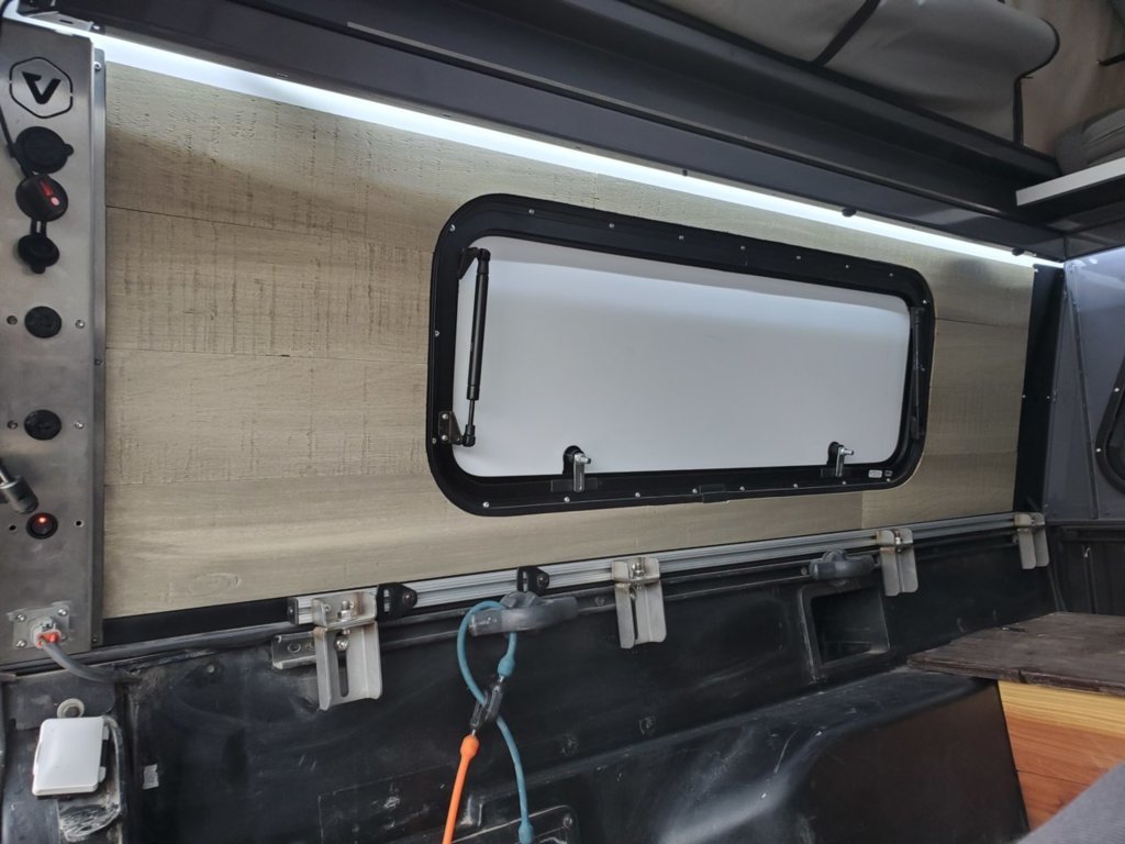

    Btw I’m looking at upgrading the clamps that hold the camper down and was wondering if anyone has done something to upgrade. I’m leaning toward what @NYCO has on his camper that he got from Iggy (stole this pic from his build page)
    Anyone else upgrade to something else?

    I need to. With a short bed and 4 clamps per side, I have to pull my camper back a half inch after going off road as self-migrates towards the truck cab.

    yeah a full length bar across the bed rails would hold a lot better. I don't think you need extrusions it could be a bar of .250" aluminum clamping down evenly on the bed rails.

    Interesting. I fortunately haven't had any issues with this cap migrating. My old Tradesman liked to go on adventures, but that resolved when I switched to a triple bulb seal. I've got a triple bulb seal under the Drifter as well and so far so good. I did replace my clamp bolts with some partially threaded Grade 5 instead of the fully threaded Chinesium, and periodically re-tighten. But so far so good.
    A thought for improving the camper is to add a plate to the front wall so that it overhangs the bed lip and can't slide forward. I think Alucab does something like that.
