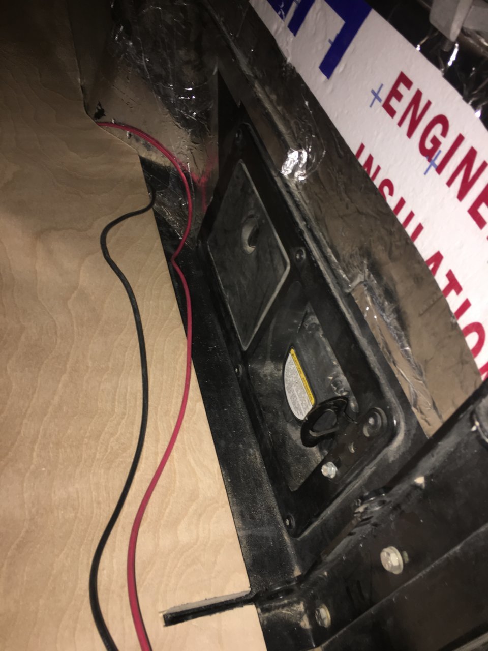

    Has anyone looked into bed rail caps like these from Voodoo?

    I had given thought to securing the camper directly to the bed rail using this as a flat washer of sorts to get rid of the camper c-clamps. Still mulling over how to access and drill through the bed cap itself.

    That was my thought as well. What does the channel on the Drifter look like? I was thinking of asking to have mine drilled during production to make it easier.
