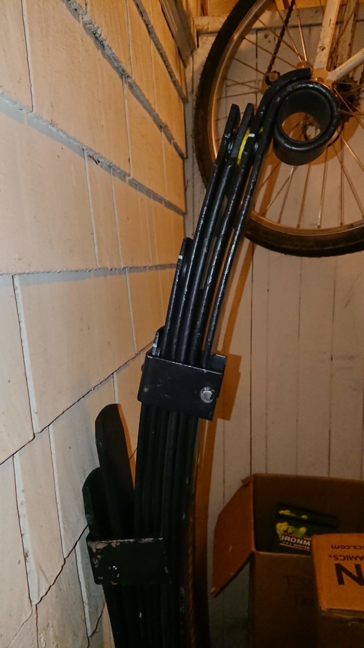

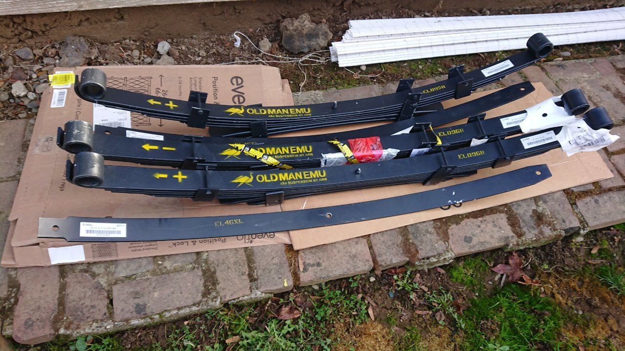

    Last sunny day for what looks like a long while (finally!), so I put the extra leaf in my HD packs to get ready to come down for delivery in a couple weeks. ARB misdelivered medium packs in error but it was interesting to have them side by side. They show no unloaded height difference over HD btw.
    Thicc pack. The longer center pin will take at least one more leaf if I need it. Depending on how drawers work out and the water tank full, and possibly an LRA tank from Cruiser Brothers, I may do it.
    OutbackHack likes this.

    My 096 pack was W shaped with a bed rack and RTT so be mindful when adding stuff, 660 pound rating seemed quite a bit off.
    Custom springs or bust.

    This is now a "097" and can be an "098" if needed. Unfortunately Deavers or Alcans are too far out to get in time for my build schedule, so I went with this option.
    The Deaver II measures 2 3/4" with 8 leafs. The EL095R is 2 3/8" with 6 leafs. The EL096R is 2 3/4" with 7 leafs. This setup is 3" with 8 leafs, which I guess puts it in the Deaver stage 2-3 range, and with another leaf would be Deaver 3+. I think the game is about leaf thickness and pack composition. All Pro has a 2/3 length leaf at the top of their pack that they say helps with wheel hop for example.
    Portland had an ancient (they made horse buggy springs in 1922) shop called Benz Spring that I was going to consult on a custom pack. Even more convenient, they've moved near me to Salem. I figure anyone in the game that long has to know how things work.

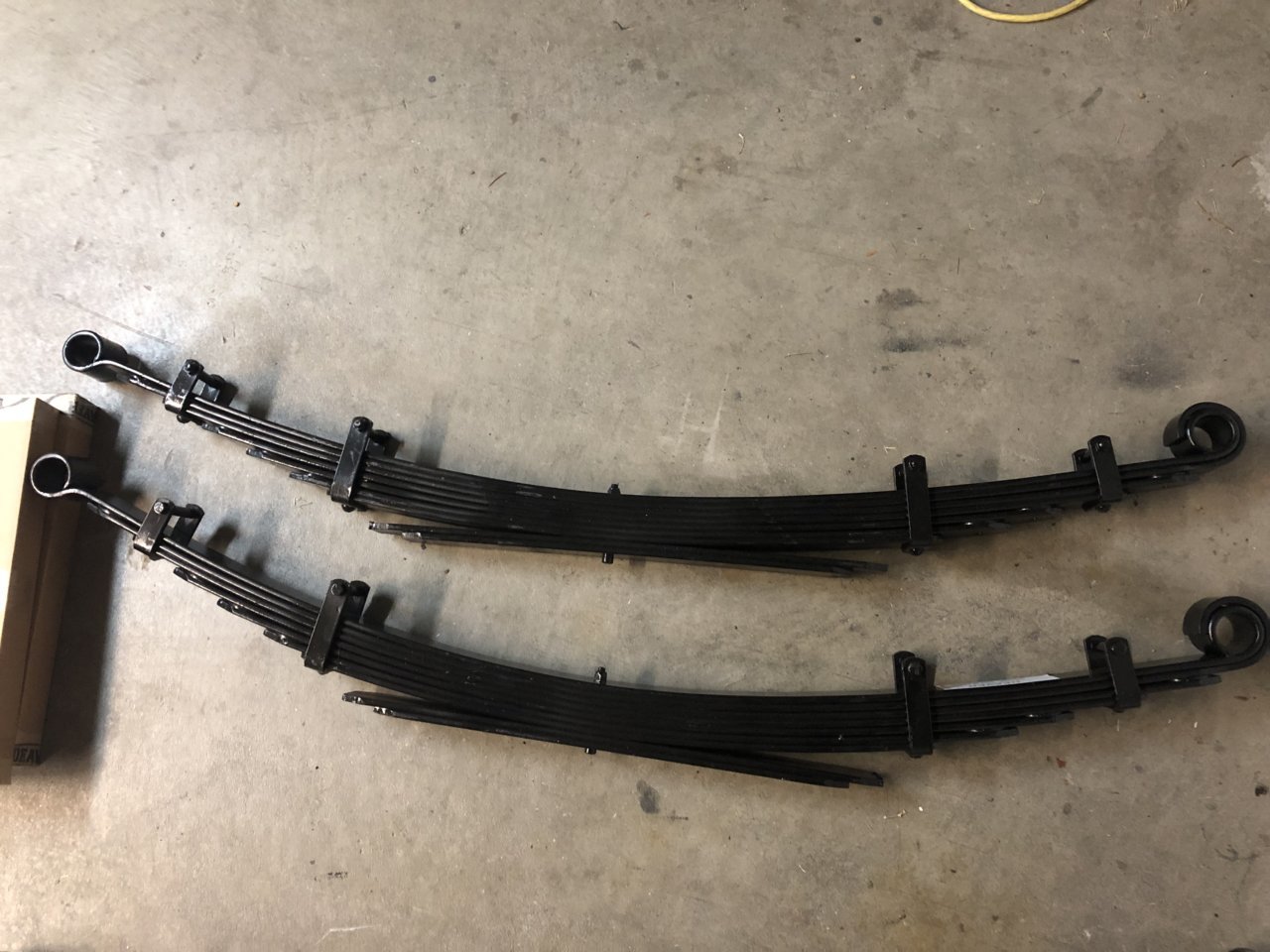

    Got my leaf pack too. Custom deavers ;)

    Mind sharing the specs? I guess the weight they’re designed to carry is what I’m wondering

    Mine will be designed to carry the 800-900lb constant weight rating and maintain the lift. Will be stiff as hell should i ever get ride of the drifter /etc. I'll probably transfer all this kit over to a new tacoma here in a year anyways, and put this one to bed.

    1200 over stock
