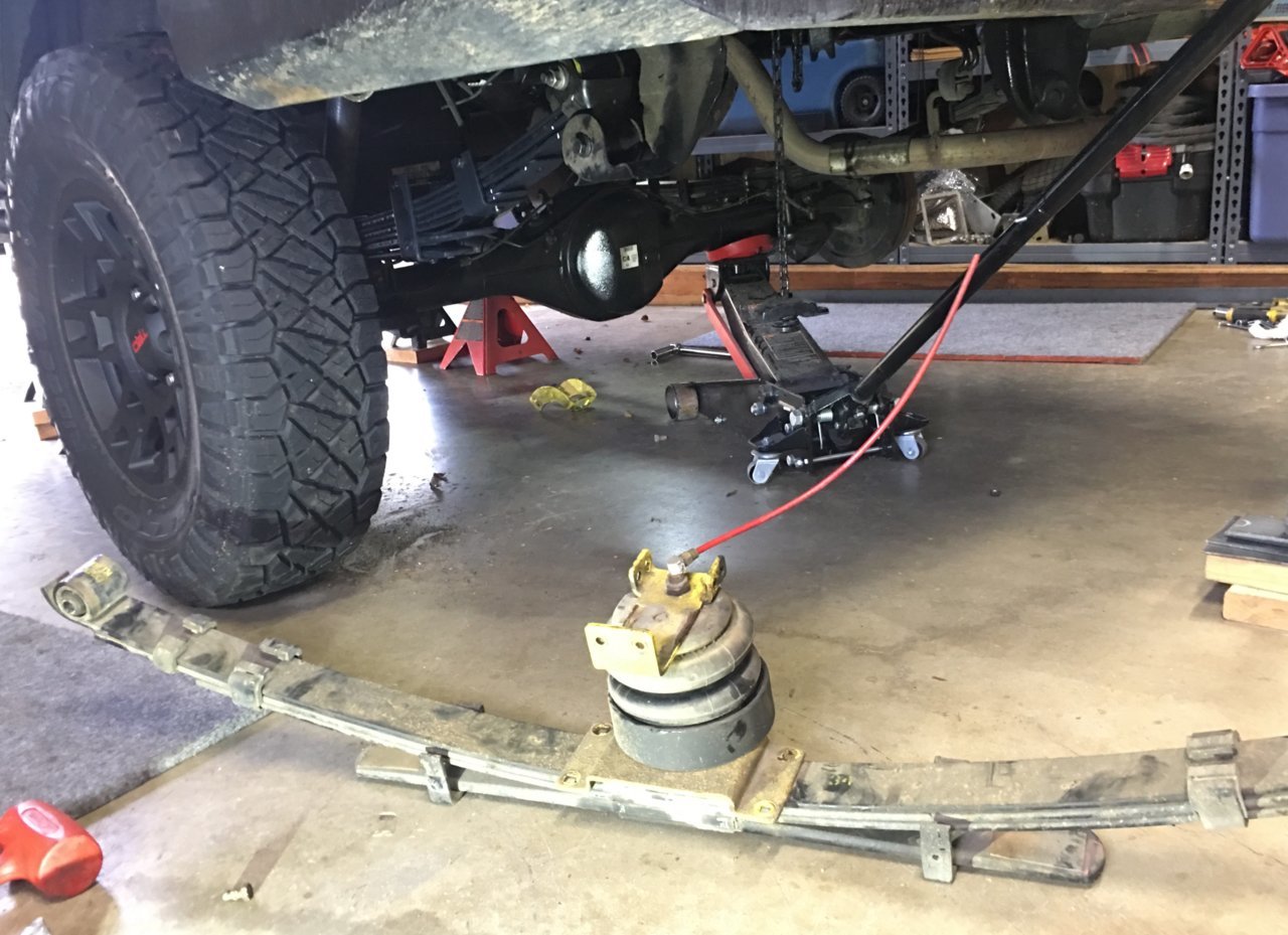

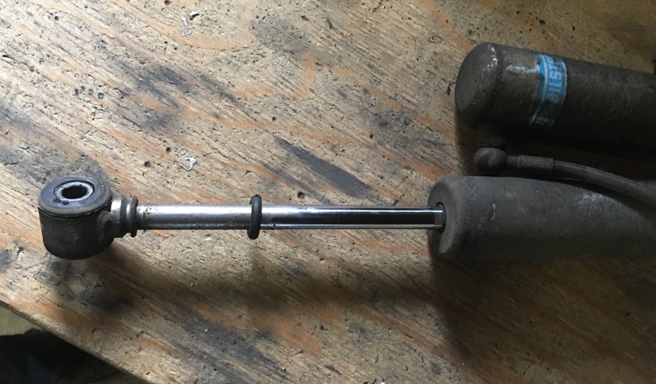

    Finally upgrading springs after a year of carrying the camper on the OEM springs w/ airbags. They’re a decent bandaid solution if you drive slow and stick to forest roads like I do. The biggest problem I had with them was limiting travel, can tell by the shock shaft that I was losing 2-3” of up-travel. The adjustability between when the camper is removed or mounted on the truck is awesome, but ride quality is shite.

    ah you had them attached to the frame and the springs which is why you lost the travel. Daystar cradles are the way to go they still allow the articulation. But they are a bandaid solution.
