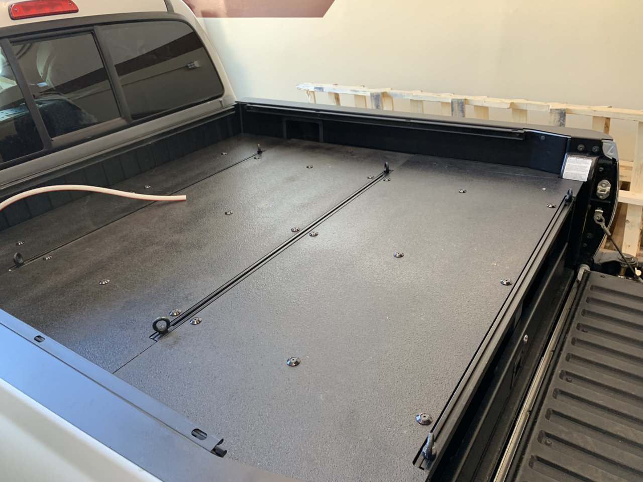

    Hey @Iggy, did you ever make any progress on mounts for the HS2000 and HS2211, for inside or outside of the bed?
  8. Dec 13, 2018 at 12:32 PM
    #968
    Iggy
    Iggy Well-Known Member
    Feb 2, 2012
    #71971
    4,016
    Northern CA
    09 4x4 Off-Road Access Cab
    Check out the build
    I have the panel mocked up I just need to cut it to make a test fit.

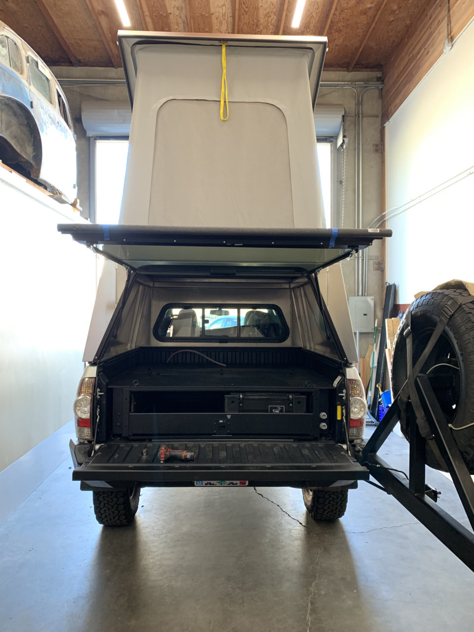

    Check out the build
    @xplorn with my old drawer setup. Turned out nice for a shortbed!

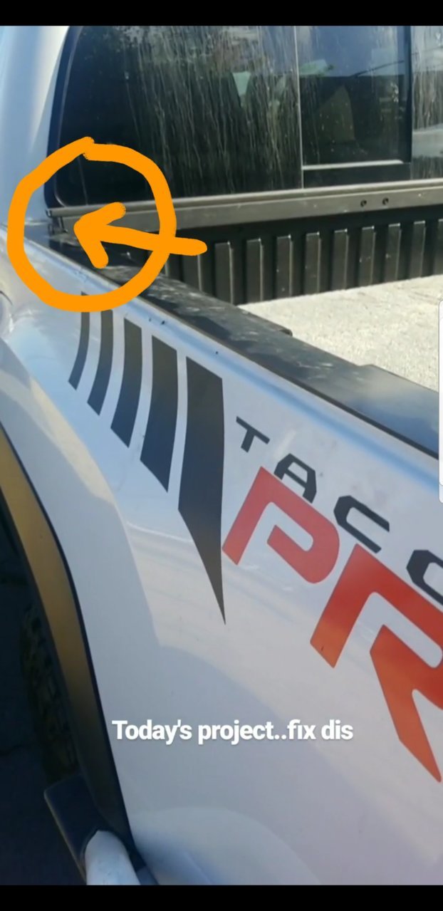

    question to the 3rd gen tacoma/vagabond owners. There is a gap between the voodoo bed rail cap and the back of the bed (orange circle). How have 3rd gen owners been filling the gap?

    I filled it with expanding foam pads so they wedged themselves in and have stayed put. My bed is water tight.

    I just used some painters tape to make "walls" on each side and underneath, and then filled it with the same silicone I used to seal under the bedrail caps. It's been perfect so far (~6 months).
    As far as the skirt goes, it ended up flapping EXTREMELY loudly on my '17 DCSB at high speeds (~75+) or in heavy crosswinds.
    So I just took it off, and never looked back. I haven't had any issues with water intrusion or anything, especially with the sealing I did before install.
    Not sure if the design on that has changed at all, since I was something like Drifter #10.
    And I'm sure that would be very dependent on minor variations from rig to rig (roof rack, cab type, etc). But Iggy did mention that with my sealing, combined with 1 or 2 small differences in the 3rd gen design in that area, that it probably wasn't needed anyway.
