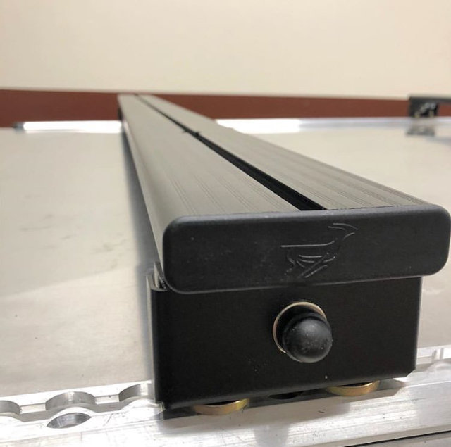

    Search the Frontrunner website using “Foot” and “Slat” as search words. You will find all of the foot pack heights and crossbars.
    Footpacks are sold in pairs and bars are sold individually.
    The end caps are sold in packs of 4.
    You’ll also need the 3/8” L-track stud fittings and will have to drill out the holes in the feet from 1/4” to 3/8”.
    LMK if you have any questions! We’re a Frontrunner dealer too... ;)

    This looks great. Makes me kinda wish I had gone that route on my shell/topper instead of the Yakima Tracks.

    I'm looking at replacing my Yakima tracks with this system.

    For me if I needed to add more track nuts it's kinda a pain in the ass to take the end caps off and shimmy the nuts in place.

    You have several different fasteners that are easily adjustable for one. It's cheaper. The connectors aren't lockable but there are ways you can lock stuff down to mitigate that. I think the connectors are also quicker to take off/put on.

    I like the 90 angle idea, sets the solar panel in there perfectly, low rise, and offers protection.
