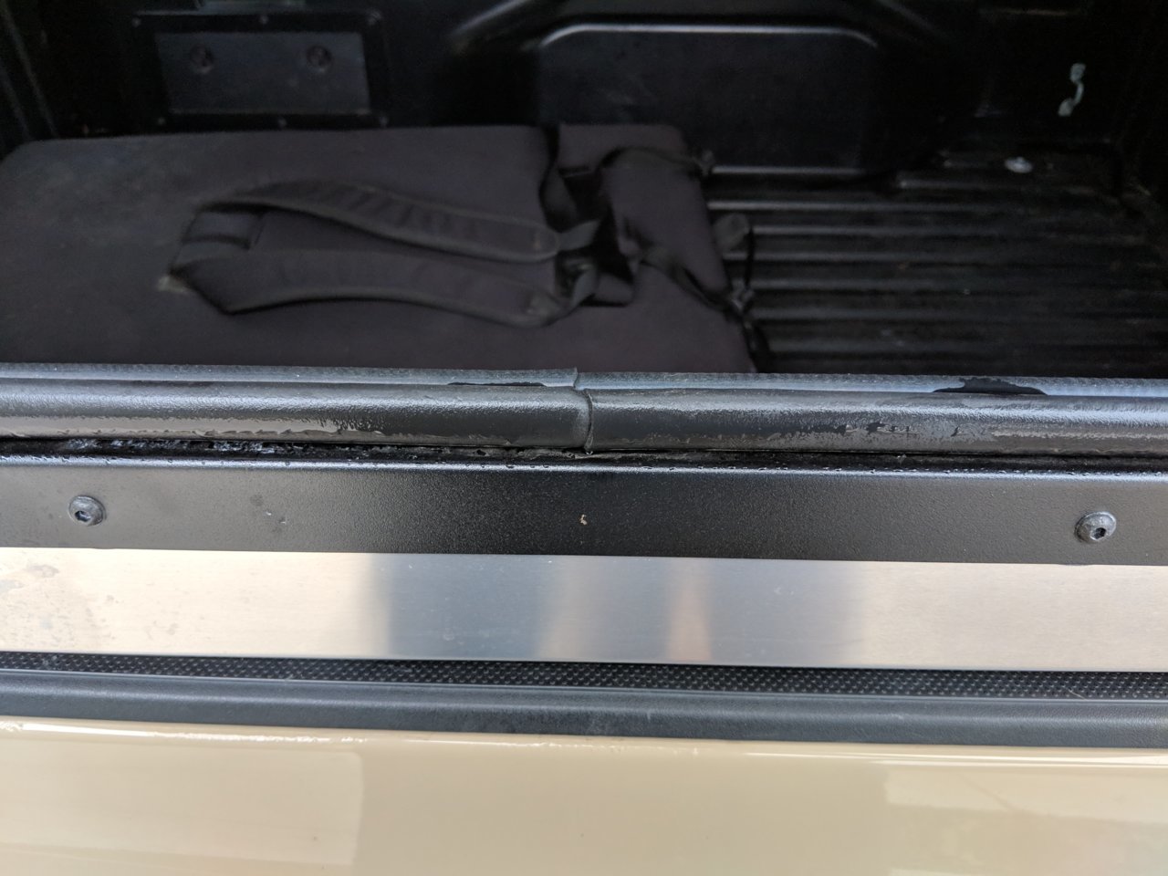

    The only other spot wasn't any part of the drifter or drifter/truck connection, but the Frontrunner door seals. Water worked its way through where the seal comes together in the bottom middle of each door. Happened on both doors. Slight drip, no stream of water or anything. I haven't fixed it yet but shouldn't take more than a dab of rubber sealant on each joint.
    edit: I also haven't played with adjusting the latch pressure on the frontrunner doors, which is adjustable.

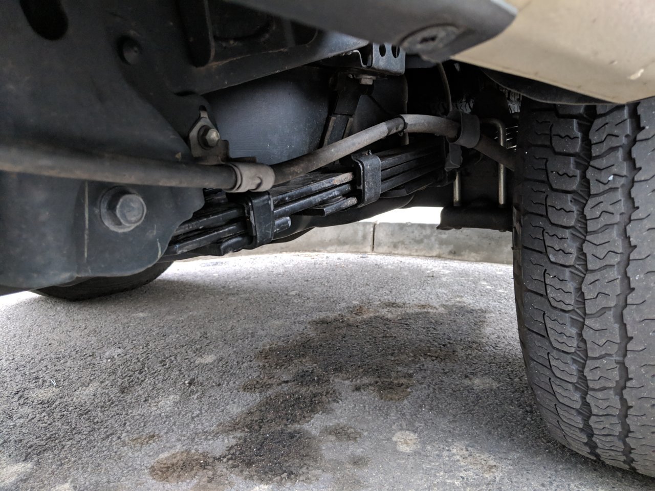

    Just for some reference to you and anyone else out there looking at the Drifter that's currently stock. Here's a quick review of what putting a Drifter on a stock 3rd gen long bed is like plus some other musing about camping in the heavy rains of the PNW.
    • You will want to build up your rear suspension at the very least. Photo is the stock rear springs with the drifter only, empty bed after plenty of settling and 1000+ miles traveled. Also i've noticed i lost almost as much in the front suspension as the rear in terms of compression. Truck is still sitting level! Full upgrades all the way around is coming soon.
    • The ride, inverted springs notwithstanding, is actually quite good. And i haven't hit anything hard enough to get to the bumpstops yet.
