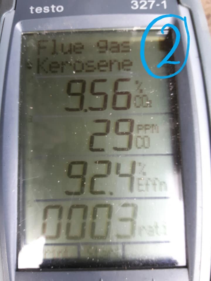

    The problem w/ using a generator tube for liquid injection like any Liquid Fuel Stove (safe for the MSR DragonFly style stove which depend on a heated burner cup to heat fuel emitted by the burner orifice) is that it's post regulation. So trying to control the flame is a function of the pressure of the fuel post generator tube and the given size of the orifice of the burner.
    My issue w/ Propex heaters is that you need a rather sizable tank (larger than 20lbs) to avoid the issue of the tank dropping so low in temp that it no longer adequately gas at a stable pressure. You start seeing problems at 7,000 feet and at below freezing temps. This situation can be adequately resolved by putting the tank inside your cabin, but if there's a leak, you're f***ed. But at least the fuel, when burnt, is totally safe.
    With regard to Fuel Oil heaters, inhalation of diesel/kerosene fumes will be an unlikely cause of death. Leaking propane or gasoline tank in an enclosed area will likely lead to death.
    Diesel heaters will run a glowplug for the first few minutes to get the oil hot enough to burn freely. Once that's done, it's really clean.
    With regard to CO, as long as it's run with a window cracked, you're probably g2g. Ask @sytfu510 his experience w/ the exhaust from a diesel heater running straight into a patrol vehicle he gets to hang out in on deployment.
    Here're some figures of a 5kw heater running.
    49539584_10156381372086973_8561192069559_e01d66d1ed415c34c6ae041ba213073b5a8d264c.jpg
    ^^^ running at max fuel consumption with the fan at 3,800RPM. These units are adjustable depending on altitude as well so you can adjust the fan speed to give it more or less air, more or less fuel at a given altitude. They're more customizable in that regard vs the Eberspacher or Webasto models (which also are in the 750-1200 dollar range depending on model).
    And like the Propex, the exhaust is vented outside and away from the vehicle. What little fumes that can make it through your cracks, will get blown away by the wind. Obv, use a CO sensor in your vehicle, but the chances of it leaking are slim. There are some bad QC issues so the units should be tested out of the vehicle before install, but the units that I've received have worked well so far.
    Just a note, all these units will emit CO2 and water from their exhaust. Generally CO2 isn't a concern because you'll feel edgy and jumpy before it kills you. It's one of the few gasses you can detect that give a very fast biological effect. Like the reason most people can't hold their breath until they pass out is that when CO2 in your blood rises, you automatically try to breathe.

    The 5kw unit is pretty thirsty at max power, ~.52L/hr. With the early generation Webasto and Eberspachers, they only had a binary setting, on or off. The reason I suspect was sooting issues regardless of size.
    You'll note that the unit draws ~80Watts of power during startup and tapers off to <13watts when running the fan only after it reaches operating temperature. It also will run the glow plug if the fuel flow is too low to keep the chamber hot. Many people have found that at low settings with the fan set too high, the burner assy cools down too much to sustain a reaction and thus the glow plug comes back on and you get really smokey exhaust, carbon buildup, and generally bad times on boats.
    I'm tinkering with fuel and airflow settings so that the unit will run the cleanest with the least amount of fuel consumption.
