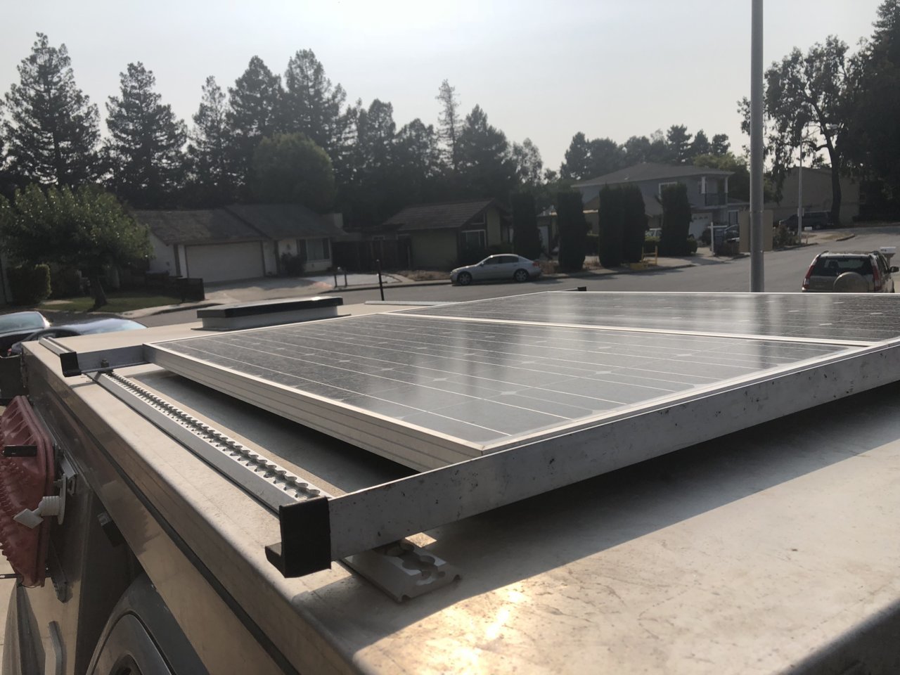

    Do you have any closeup pictures of your solar panel mounting? Which brand are they? They look clean and simple.

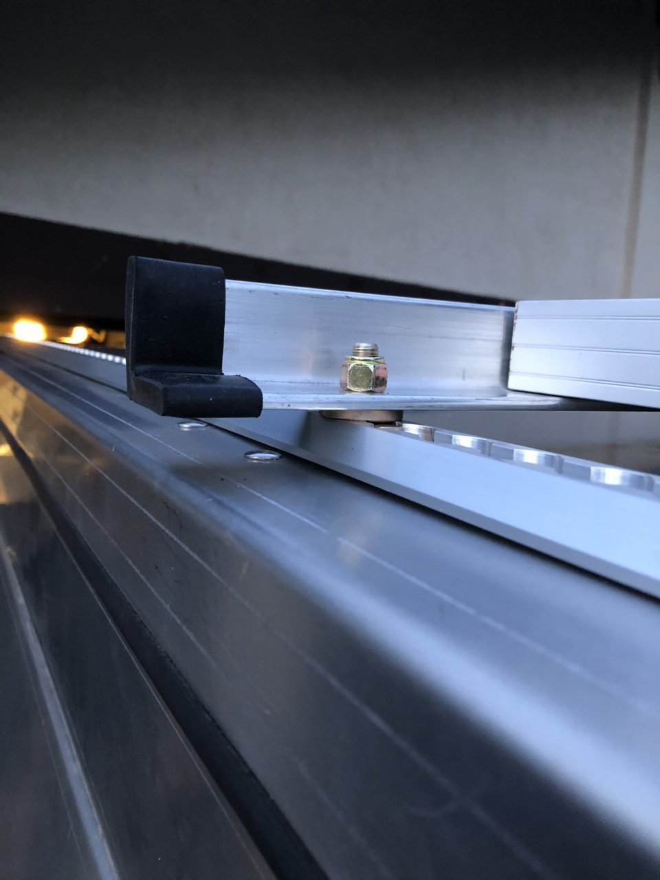

    I needed at least 2-1/4" to clear the fan, but didn't want larger than 2"x2" square tubing. Another issue was the small apex at the very center of the roof (to help with rain run off). Just sitting on the L-track, the square tubing wont clear the roof apex. So I made four 2"x2" squares out of 3/8" thick alum flat bar that sit in between the L-track and crossbars. That way the crossbars will clear the roof apex, and that anything on top of the crossbars will clear the fan (and solar panels). Also just a note, the stud fittings for the L-track are just long enough to account for the small 3/8'' thick squares and 2"x2" square tubing. Anything thicker and you won't have enough threads on the stud fittings to fasten a nut to it.
    I have two 100W Renogy Panels sitting on alum angle iron that fastens to the L-track similar to how the crossbars are mounted.

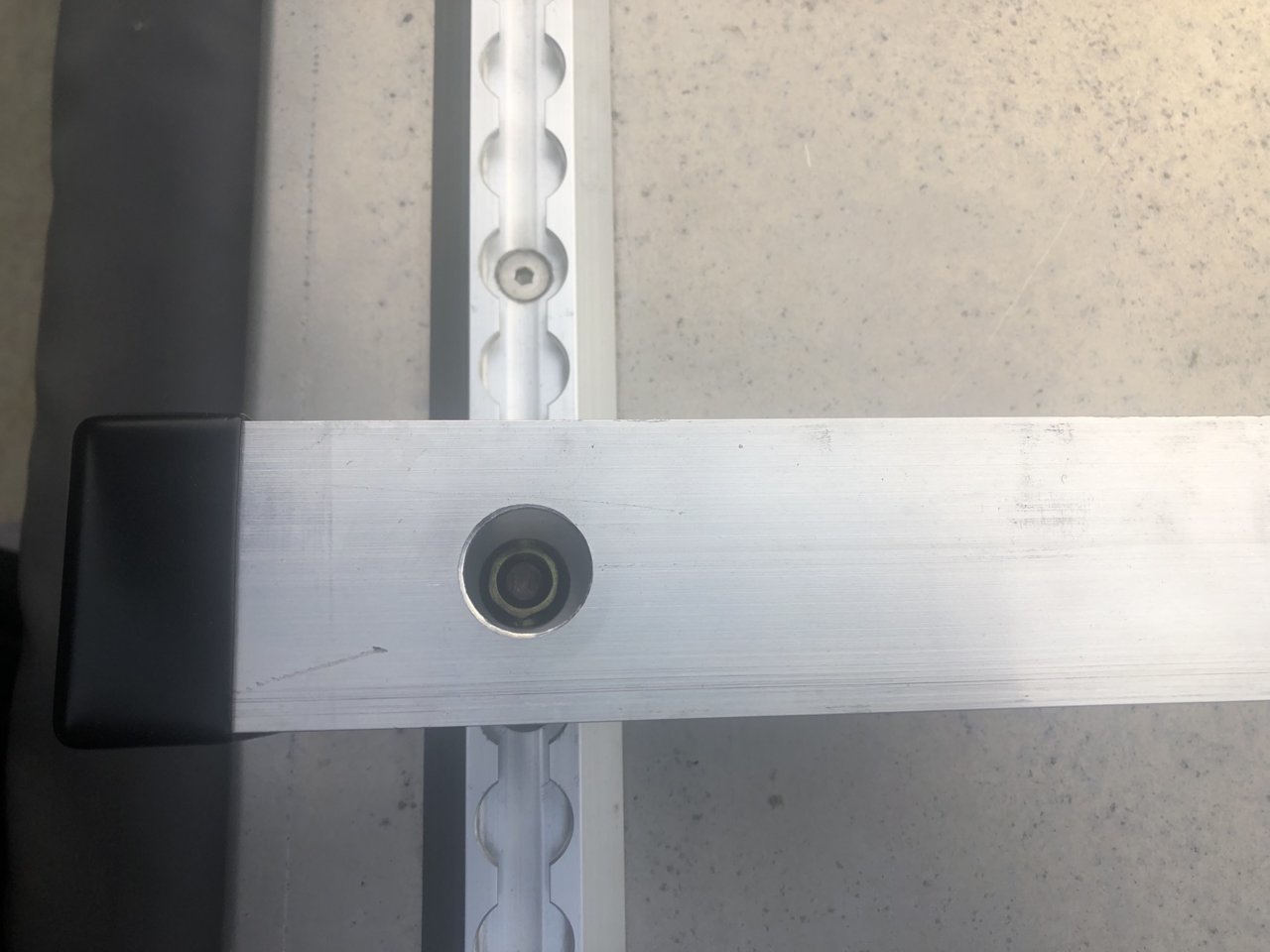

    No problem. There was definitely a better solution to this than what I was thinking, but I was up against time with this most recent trip. I drilled a hole on the crossbars directly above where the stud mounts fasten the cross bars to the L-Track. That way I can stick a long socket in there and just fasten it from the top.
    A cleaner way to do it having a longer base/spacer underneath the crossbar, with 2 stud fittings, and the square tube in the middle of them (I think I saw something like this on one of Phil's campers, not sure which one). But it requires 2 stud fittings per foot (or 4 per crossbar) that I didn't have, so I went my route for now. Looks something like this:

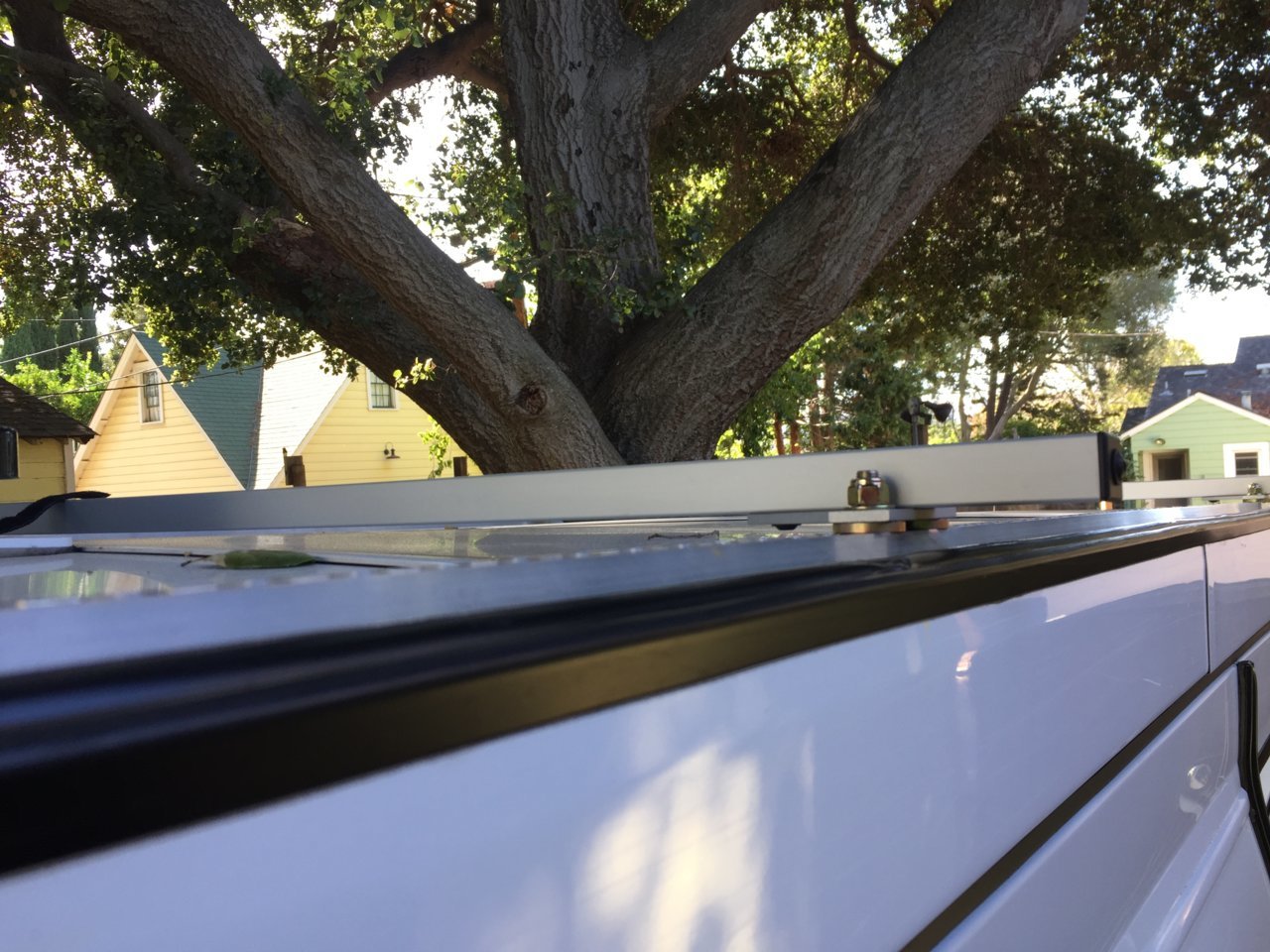

    Actually found what Phil did for his crossbars
    8D08E5B6-4CCD-415B-A22D-0F465C34E7AA.jpg 727F4C6F-0CE3-464A-B282-46052CDA1AF9.jpg

    Phil's does look pretty bomb-proof, but again, I'm a fan of the simplicity of yours. Considering they're already up there and working for you, I'd just grab some rubber plugs for the access holes and call it good.
    With my plan, I'm mainly just hoping to save a few bucks, as well as a few pounds since I've got the third panel up there already.
    And the third panel also means I'm limited to one stud per foot anyway.
