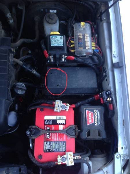

    I was lucky to pick up S-pod from @danneskjold. While I wait for it I got some time to plan out where to put it. I was hoping to get some input. Mount it in the cab, or mount it in the drifter, and use an app to run the lights while driving???

    2018 F150
    Mount it to the top of your fuse box in the engine bay and use the Bluetooth app to run stuff from your camper.
    ***I never used the Bluetooth function so can’t confirm it’s even there, was just told it was.
    Edit: I also believe you could buy a second control pad and run it inside your camper as well.

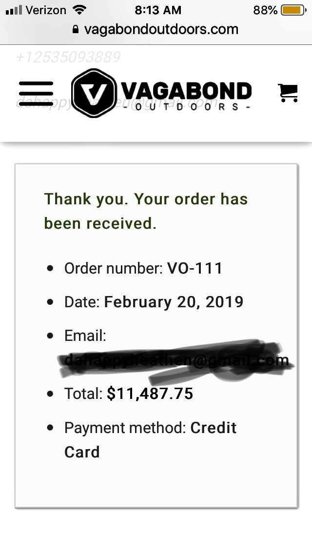

    I finally ordered my Drifter. Now the long wait begins.

    IMHO, don’t put anything on top of the fuse box. It makes it a real PITA when you are troubleshooting anything electrical. General rule of thumb, always check your fuses first and that gets problematic when its a chore to access your fuses. This particularly sucks when you’re on the trail, at camp, etc. Don’t ask me how I know :anonymous:
