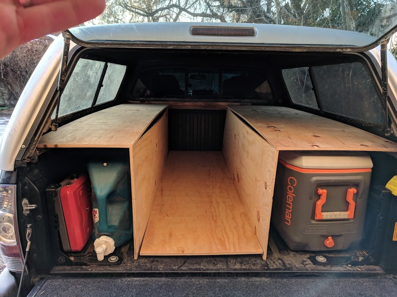

    I'm planning to do some work on my bench/cubby build this weekend. Going for something like what @Eazy.E has done with the benches/cubbies on the sides, then the middle will be a slide out table/bike platform. I mocked it up with some plywood I had laying around...
    ZV9CGTCBBAKQjnbdVzu_dIUBu3P63mKE2cEbkdNE_9100729ace1691a84a03e29f3254ed3ae6f6c694.jpg
    Questions...
    1. Is there a good way to bolt this into the bed without building a baseplate? I was thinking I could use some T-nuts and bolt it into the OEM track system, but I'm worried it will be a bit unstable without a good mounting point to the floor...
    2. Should I just wait to do this until I have the drifter mounted or will building it around my current shell clamps be compatible with the drifter clamps?
    3. Unrelated to the cubby build...I'm gonna mount a second battery under the hood with an Off Grid Engineering system. Is there a preferred way to run my wiring back to the fusebox I'm mounting in the bed?

    1. The best way is to mount it to a baseplate. The rails can only support so much weight, but mounting to just the rails won't be good long term. That makes the mounting point high when it's best to mount it at the bottom because Science :D
    2. I would wait until you have the Drifter. You never know if things will change. Plus its difficult to simulate the actual space until you have everything in place. But if you're just super excited to get the build going (similar to how I was before I got mine), then go for it. Just know that in the end you may have extra materials/items because of what you thought would have worked, but didn't. Don't ask me how I know :anonymous:
    3. I ran a 2AWG underneath my truck along the frame from my 2nd battery in the hood to the fuse box in the Drifter

    I found that the best way to mount stuff was with a baseplate. Otherwise every mounting point for your setup would be going through the bed vs only the ones it takes to mount the baseplate.
    Also allows you to have a nice smooth clean floor inside your camper.

    in addition to the above. you could make a frame that mounts instead of a whole plate. and mount things to the frame. could be lighter, will not be cheaper, may not save space. could be cool to see though

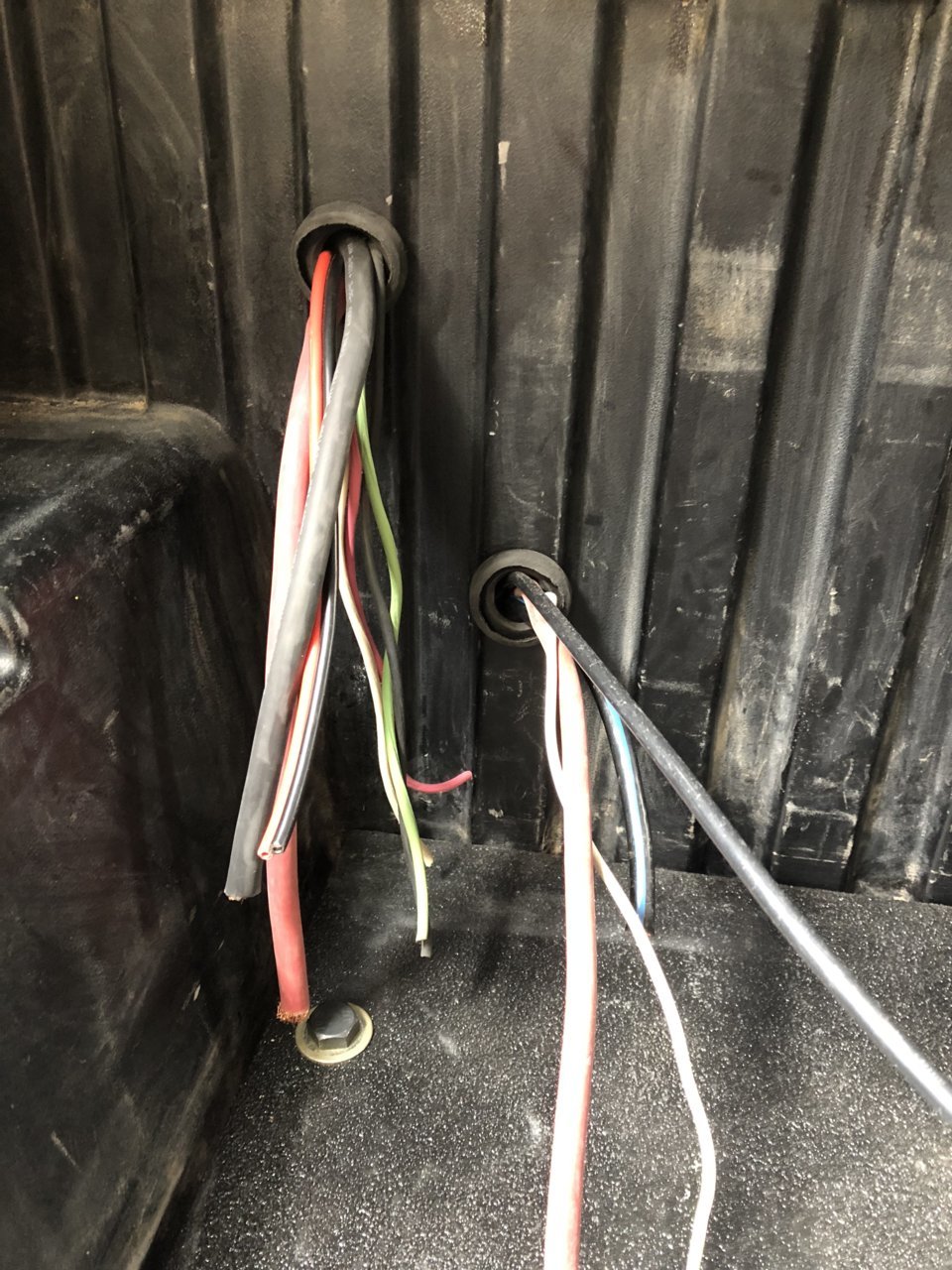

    I figured this much out...where do you run the wire up in to the bed? I gather there are a number of entry points, but I haven't gotten under there yet to look.

    Ran all the wires through 2 firewall boots
    Left has all wires for the Drifter. Right is all the wires and airline for my air compressor that is mounted in a cabinet right there (hence the lower location since the wires and airline were already there for when the compressor used to be in the bed tool box)
    Another reason to plan everything out. The cabinets were built around this

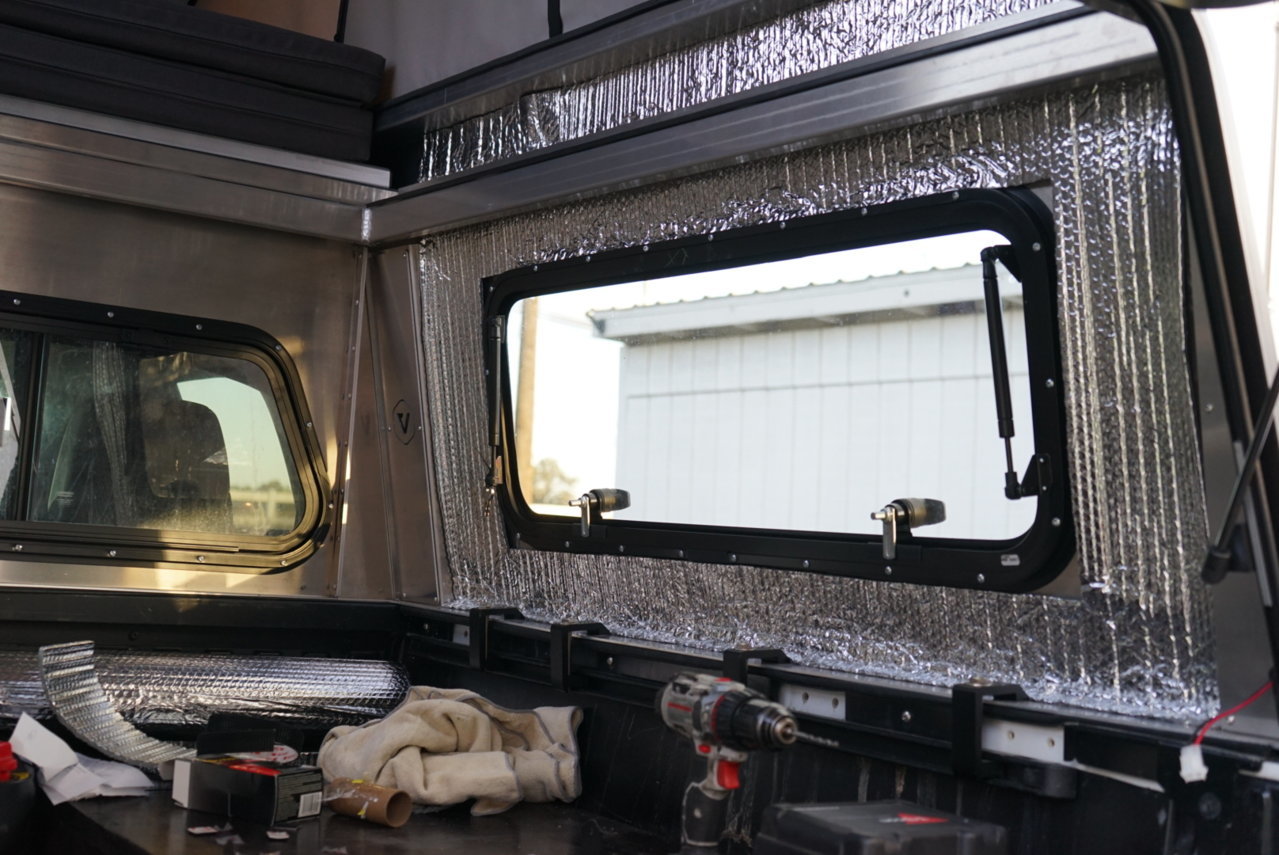

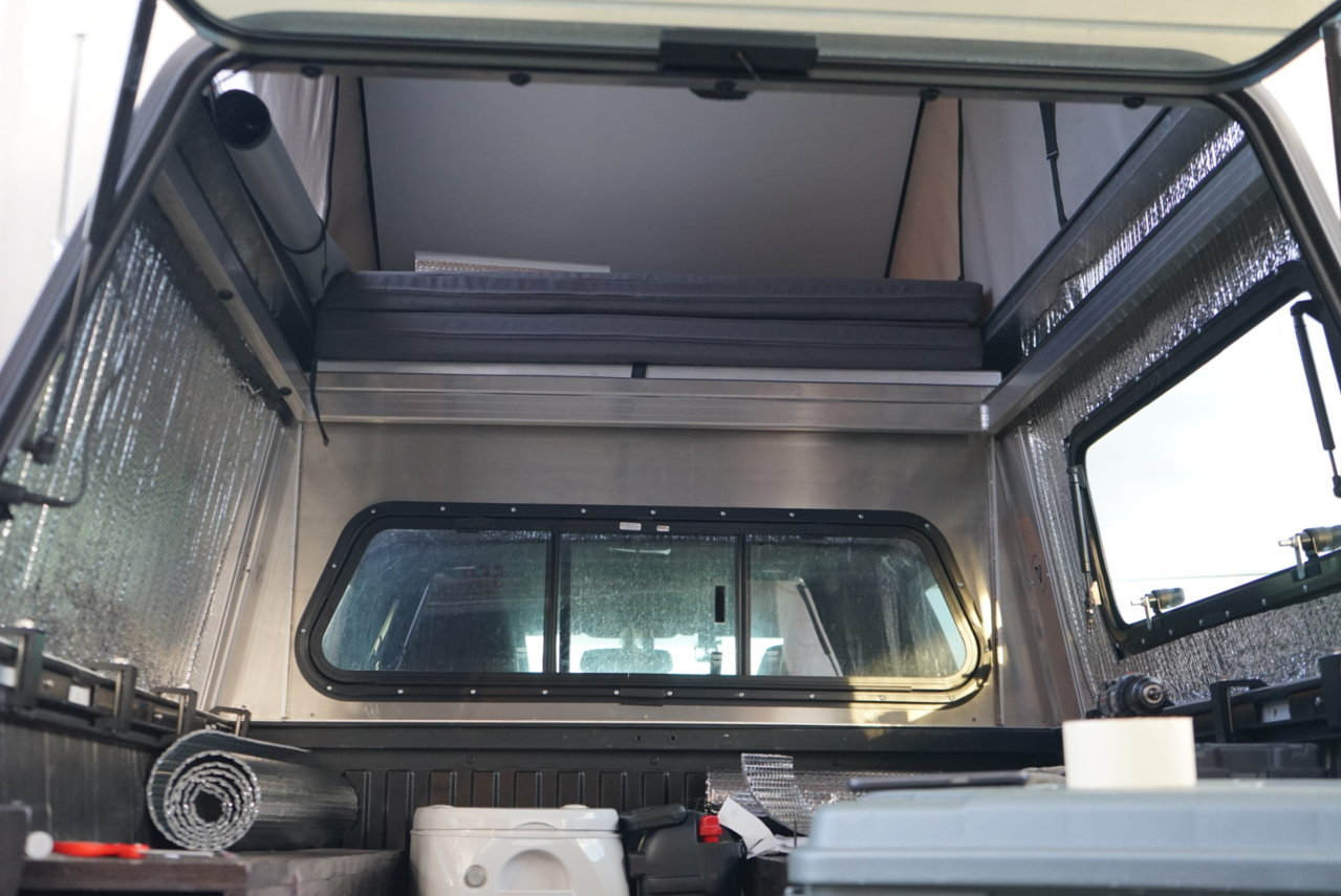

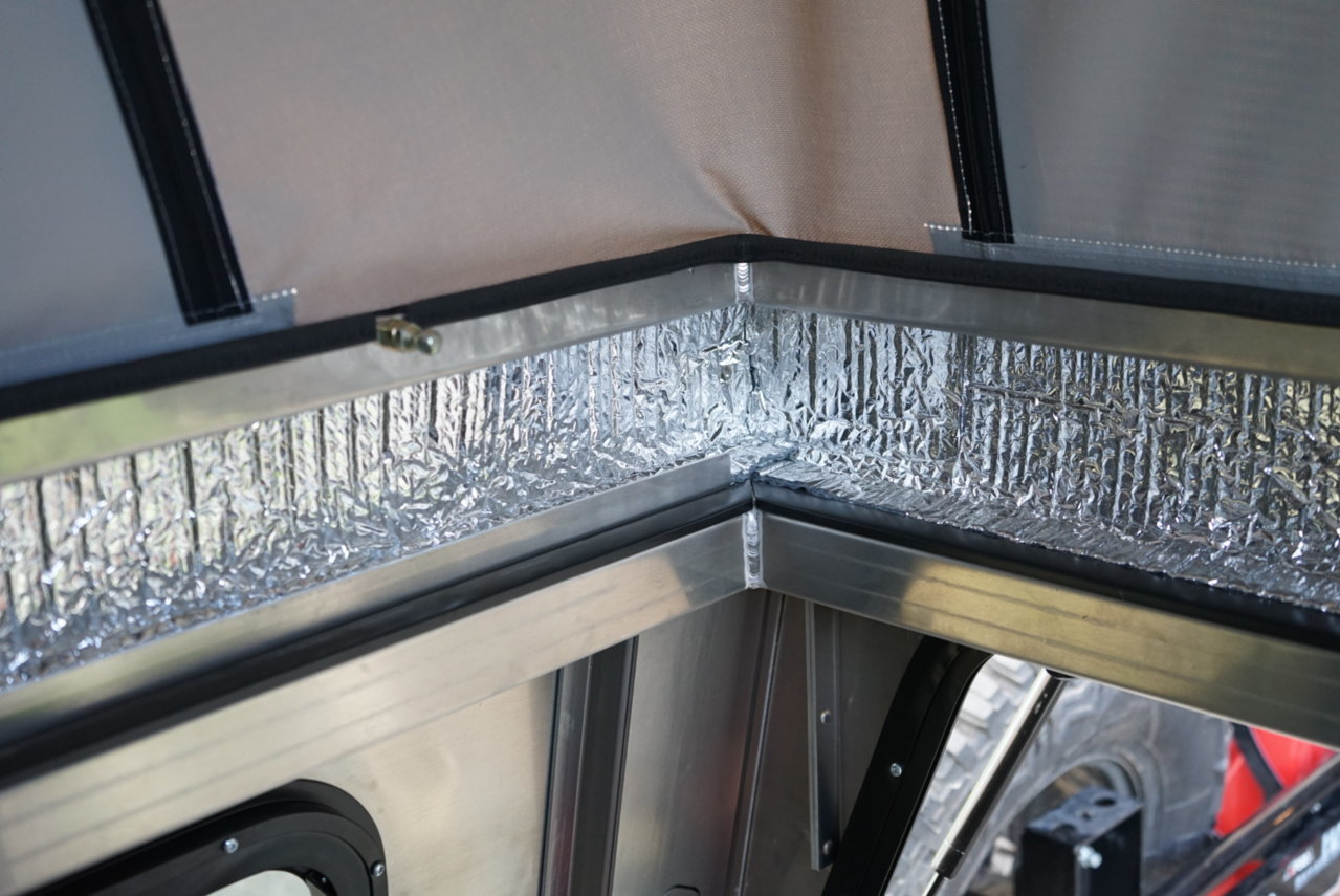

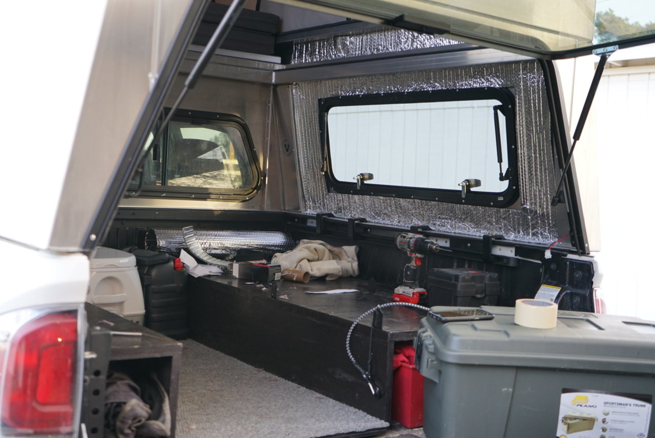

    Getting on insulating the Drifter.

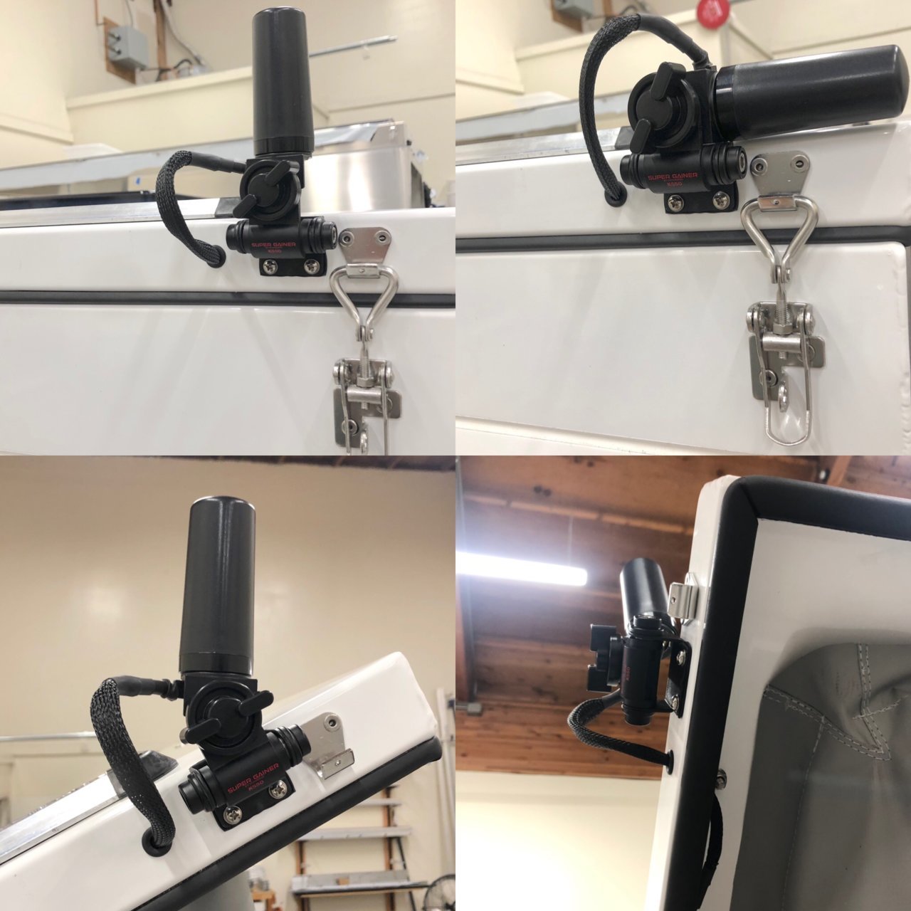

    Looking for a mount at the back of the drifter to mount an antenna, for some reason, I am pulling up a blank on this in my search. Seen it in a few of the drifter builds, anyone have a link?
    thanks

    Modified Diamond K550.
    https://www.hamradio.com/detail.cfm?pid=H0-005258
    Looked at few others, at the HAM Radio outlet in Oakland, and this seemed to work best. I had to chop/ grind/ paint the bracket to make it work.
