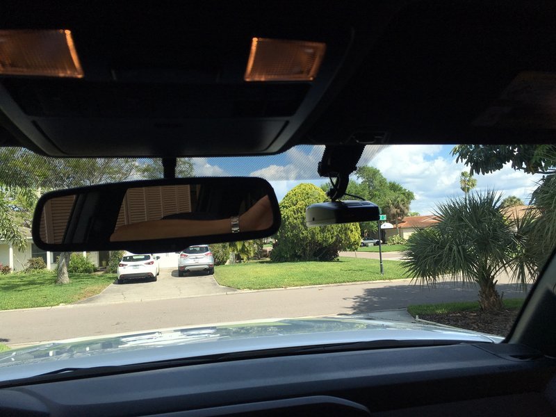

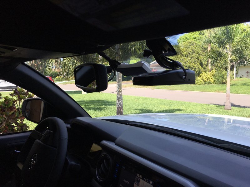

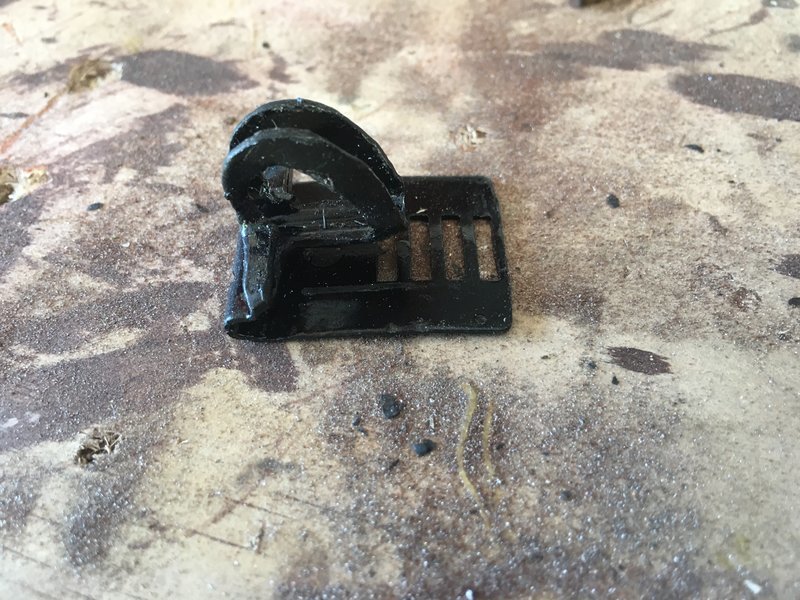

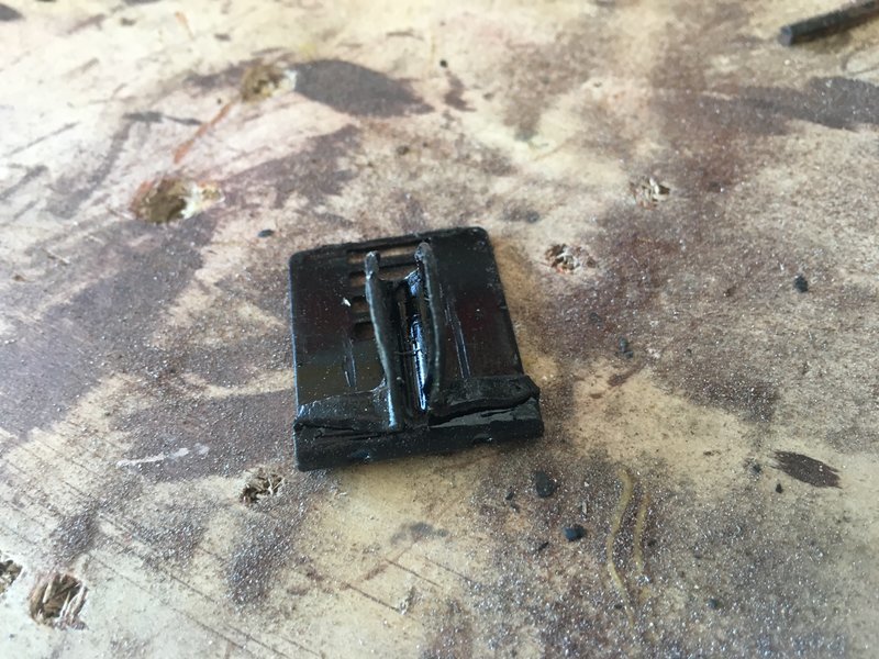

    I just mounted my Beltronics GX65 on the GoPro mount. I got an arm and clip and some other parts and had to figure out how to get the clip mount for the detector to attach to the arm. I bent up the suction cup mount that came with the detector (no need to worry if it didn't work, I had a blendmount) I sprayed it black, and it looks like crap, though once installed you can't see it anyway, half goes into the detector, the other half into the arm for the GoPro mount. I used a different bolt to go through the detector bracket and arm so I could squeeze the plastic arm down around the thin metal bracket. With everything tightened down it is pretty solid up there

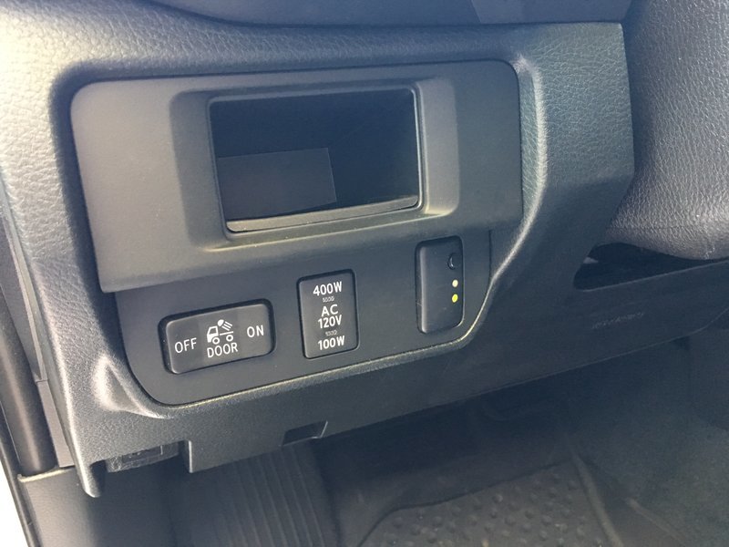

    I reused the mute button and smart cord I custom fitted into a switch blank on my old 4Runner, the only blank I had was also the only spot on the truck this button would fit. I wired it to the backside of the cigarette lighter outlet that is in the console. I am not in love with the location for the button, I may remove either the parking sonar switch or Qi charging switch and make a new button in a blank that will fit there. I don't see myself ever using parking sonar with a backup camera, and my iPhone 6S does not support Qi.

    Check mine out one post before your. My Beltronics mount should be the same as your Escort. It took some mangling of the stock auction cup mount, but I made it work in the GoPro mount.
    I did decide I didn't like it there though, and moved it back under my mirror with the blendmount I already had from my 4Runner.
