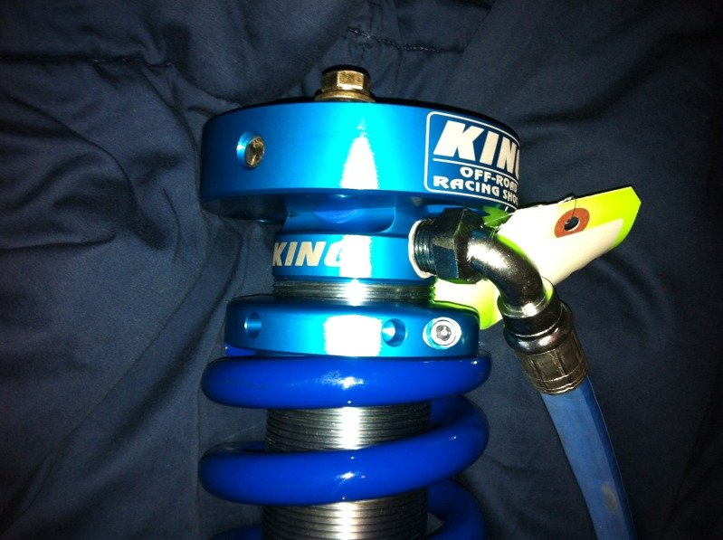

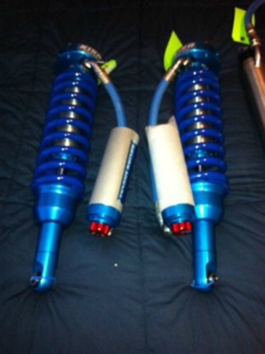

    My shocks and uppers were ready today so I went to pick them up and figured I would show them off before they go on this weekend :D

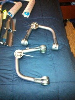

    uppers
    coil overs with 700lbs spring
    IMG_1194_49b2170a4d92912957d87ff58b7ea532f63cb653.jpgIMG_1193_4074f9f6bd14eeeff20853d47323a3f1fc3057da.jpg

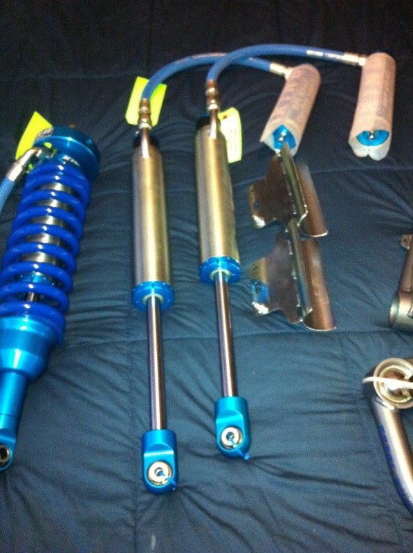

    rears
    I'm not worried about the install I think I got it, however when I look at the coil over I can help but wonder how to adjust it when its on the truck :dunno:
    I have searched but getting mixed ideas
    if anyone has any tips thanks
    and I'll post before and after when the install happens

    Nice! Looks like the top mount for the coil is on the threads..so bet you turn that to tighten or loosen the coil. How you do it..or if you can do on the truck..no idea :laughing:

    I was really hoping I could do it on the truck lol oh well

    I have LT King shocks but its the same concept. I dont remove my shocks to adjust, but you do want to get the wheels off the ground so the spring has as little pressure on it as possible. I use an allen wrench (not sure of size) that fits in the hole pretty snug. You can flip the wrench around and move it in all different angles and you can get around the resi hose. It takes a little while but easier than removing the shock IMO

    think it will be harder to do since I have the larger coil?

    Larger is in how? Like higher spring rate?

    higher spring rate

    What rate? It will be a little harder but should be able to do it

    700lbs
