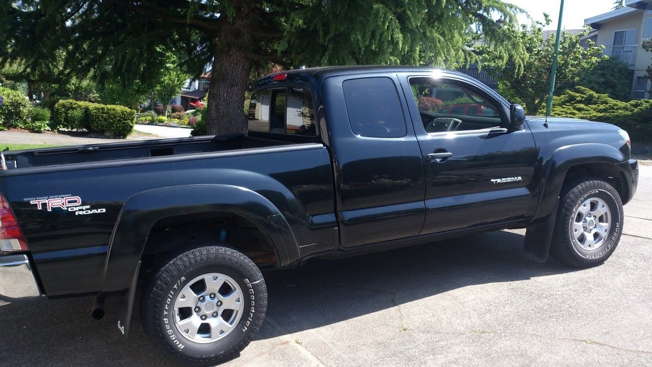

    here we have the victim truck, looking terrified

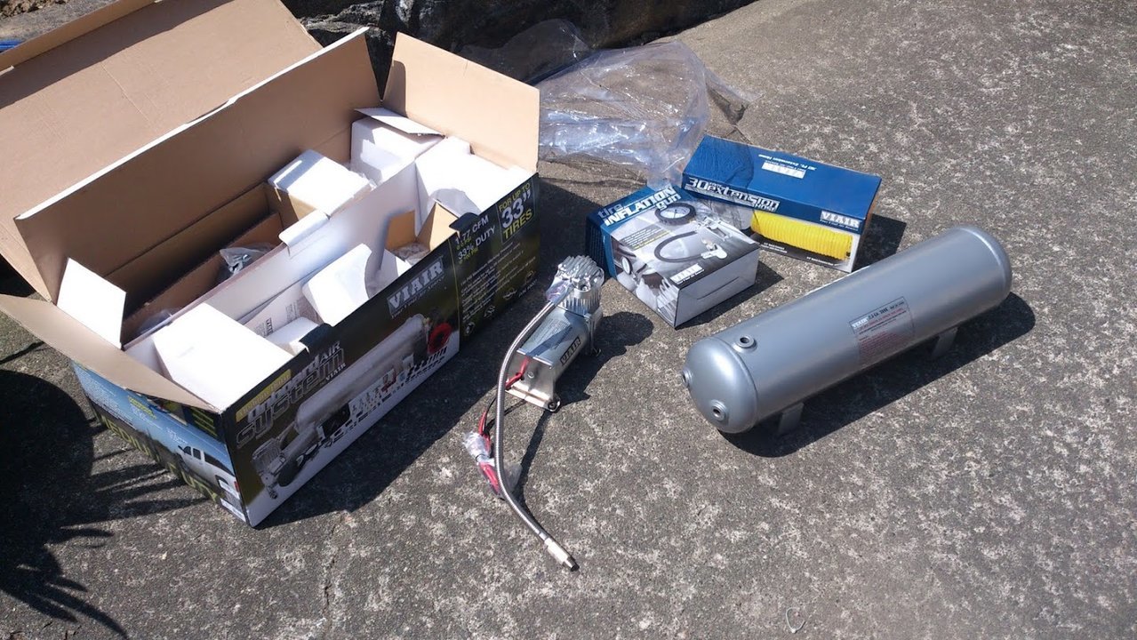

    and of course the kit skewn out in an organized fashion

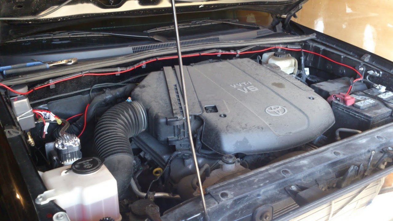

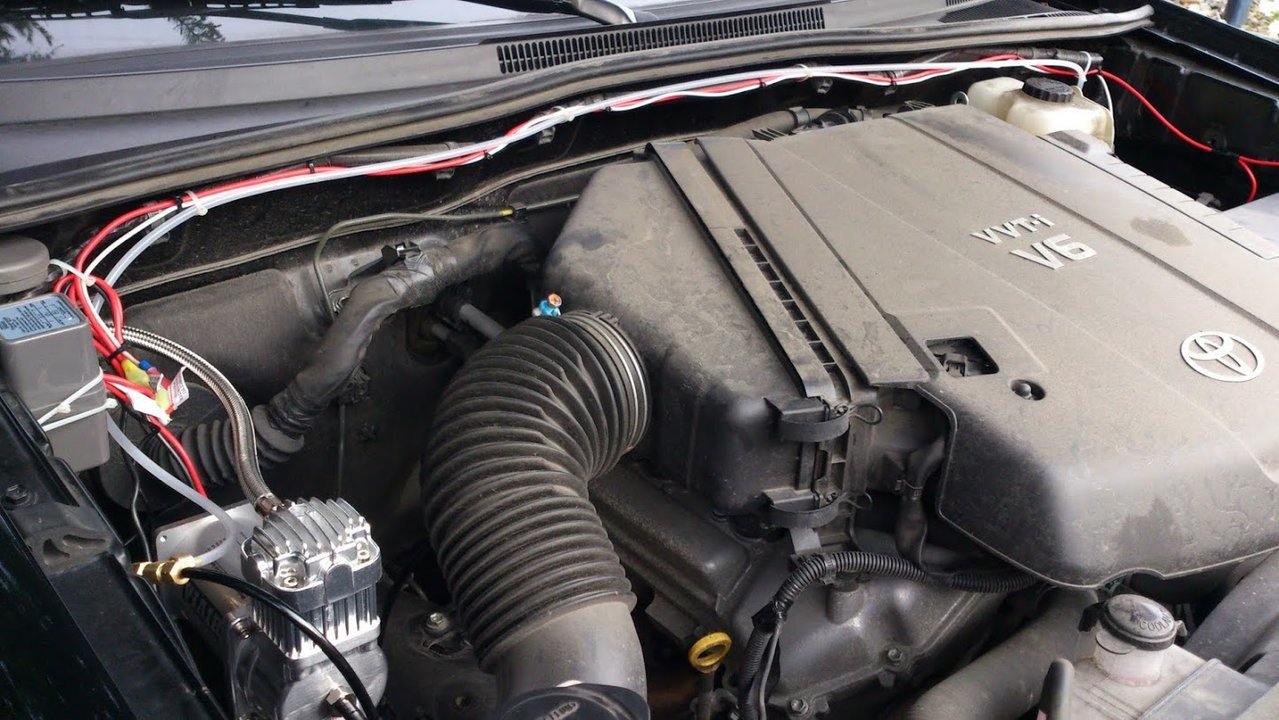

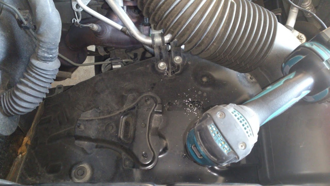

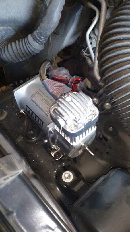

    i started with the compressor. looking into the engine bay from the front, there is a large empty space on the left side with 3 bolts sticking up off a plate. im not sure what is intended to go here, but its going to be the new home of my compressor. i started out by marking out the front 2 holes. the rear holes dont line up very well, do i drilled a new hole in the mounting plate of the compressor accordingly. my compressor is mounted with 3 bolts instead of the original 4.
    i cut up an old bike tube to use as a new rubber pad under the hole i made in the base plate of the compressor. after that i bolted it in with a combination of the original bolts and a longer 1/4" bolt i had.

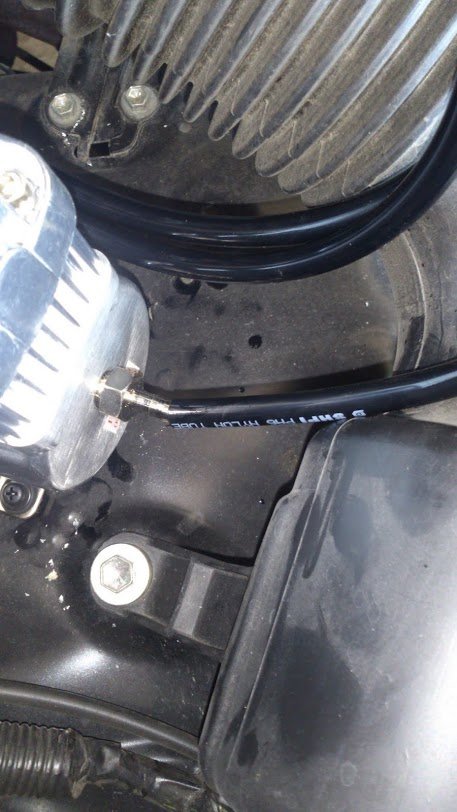

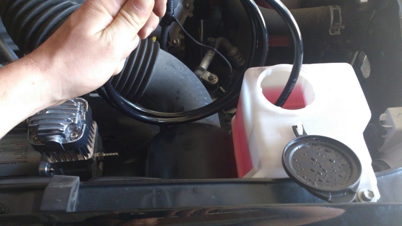

    next i ran the intake hose. it comes with enough to reach the top of a snorkel. i dont have a snorkel but i do plan on getting wet once i get a lift.i chose to put my intake filter in the top corner of the engine bay. the hose doesnt fit on without a fight.
    the dish soap is all the way upstairs and im lazy. a closer alternative was found:D
    heres my intake filter and hose ty wrapped into place

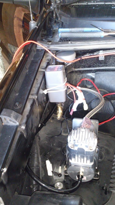

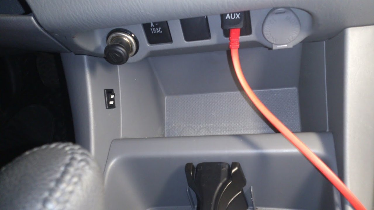

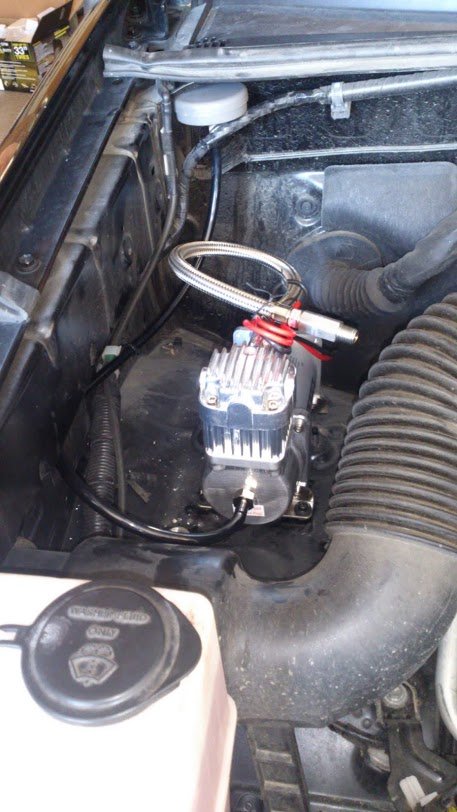

    i dont have an auxiliary fuse box yet so for now the compressor runs straight from the battery. theres an inline fuse included on a long piece of wire supplied in the kit which i ran around the engine bay
    you can also see the combination relay / pressure switch box mounted beside the compressor.

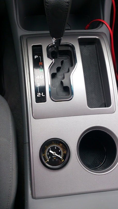

    i dont like the stock mounting plate for the gauge and power switch for the compressor. it looks home made. i chose to mount my switch and gauge separately in the center console.
    the gauge has a light in the back which i didnt install. i didnt feel like hooking it up to the dash lighting. if i really need to i can use the map lights to see the gauge in the dark. a 2" hole saw provides a nice snug fit for the gauge assembly.

    i finished off the engine bay area by adding 2 T connectors off the main output line of the compressor; one for the pressure switch / relay and one for the hose that runs into the cab for the gauge. i entered into the cab via the hole in the firewall on the drivers side. theres already a big bundle of wires there so a couple more and an air hose couldnt hurt.

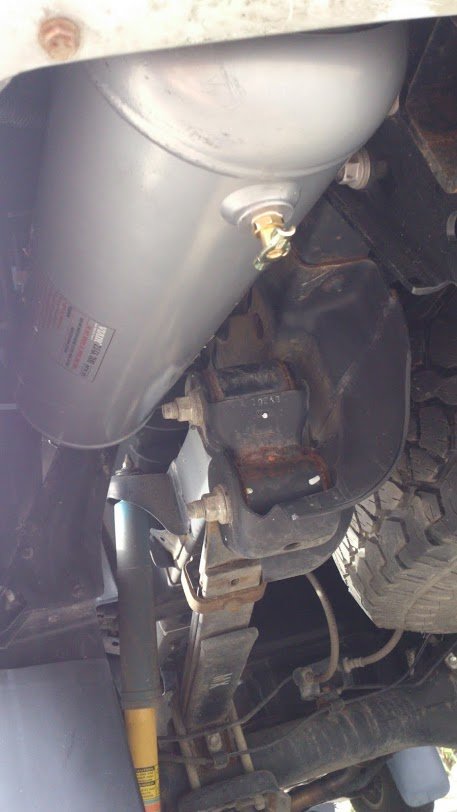

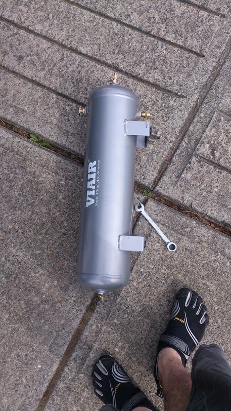

    after running the ouput hose to the rear of the truck on the drivers side it was time for the tank. i installed all my fittings ahead of time as most of them wont be easily accessable once its mounted.
    and yes, toe shoes are awesomely comfy
    mounting the tank.

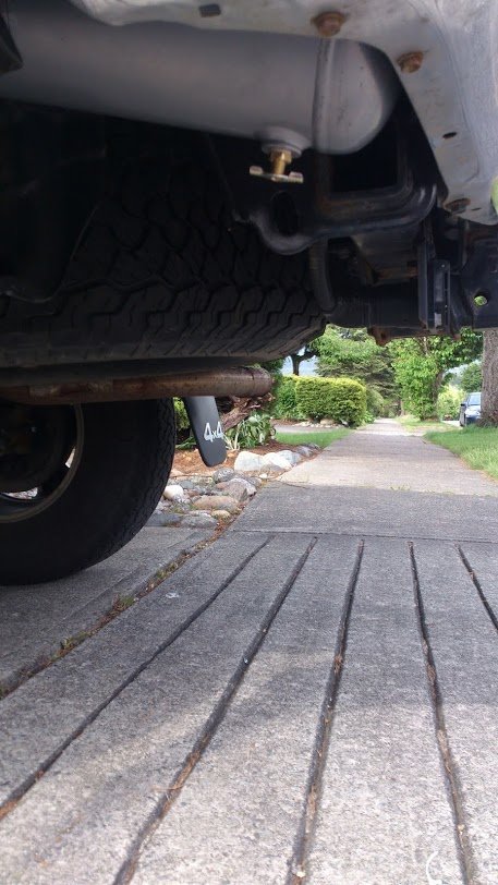

    i found a nice cozy spot under the rear driver side corner of the box. it sticks into the cavity behind the bumper a bit, so if you have an aftermarket rear bumper this might not work for you. i drilled 2 holes for bolts in the bed snd one in a plate attached to the frame. sorry no pics but its a little plate next to where the hitch mounts to the frame. i cannot stress just how much of a pita it was to bolt the tank up. i had some one drop the 1/4" x 2" bolts in through the bed as i attached the nuts, washers and spring nuts and held the tank in place from underneath. to make it easier i mounted my 2 hoses(airline in and out) to the tank before bolting it in place. it sits very close to the shackle for the rear leaf spring but i think i left enough room for it to flex without contacting the tank.
    according to the measurements on their website, the smittybuilt 2.5 gallon tank will fit in there a lot better due to its shorter overall length but they were on backorder and i wouldnt get one till june. this tank fits like a glove. but tighter. it sits just above the hitch and on an angle which is nice for draining any moisture out. i replaced the drain valve in the pic with one that is a little more low profile.

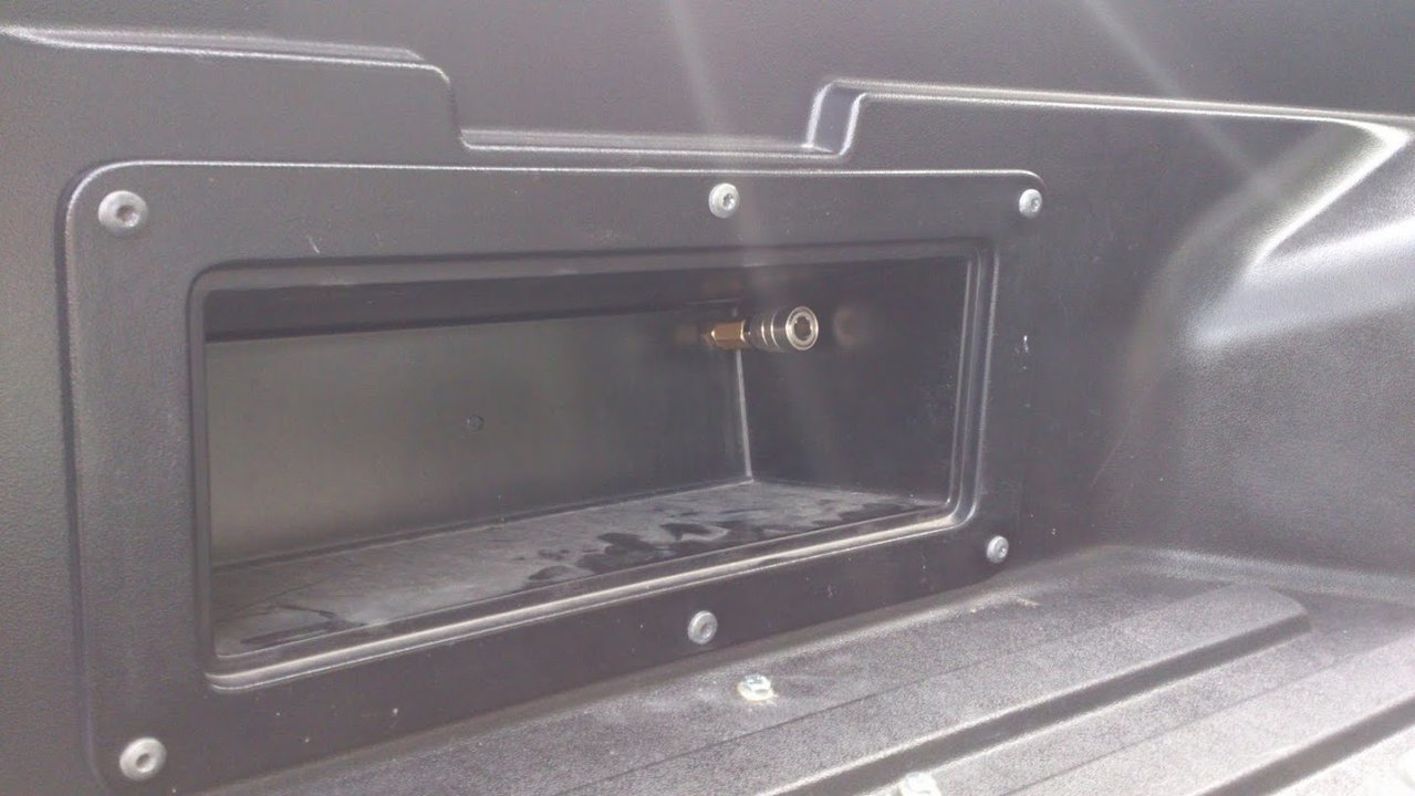

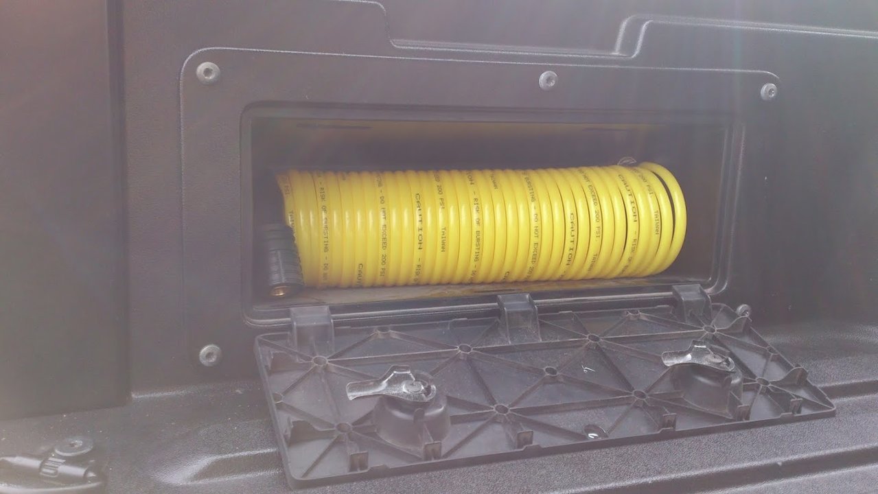

    to finish it off i installed the included quick connect in the longer of the 2 storage pockets in the rear of the bed. you can see the 2 bolts that hold the tank in place in the bottom of the picture.
    it fits a 30ft extention hose perfectly. its almost like toyota designed it for air hose storage

    Nice job! Were you using the windshield washer fluid for leak detection? I don't think it will work like soapy water i.e. dish detergent.

    @majorhavoc
    I used washer fluid as lubricant to help the hose slide on easier

    Where did you end up tapping into the power for the switch? did you use an add-a-fuse. The wiring schematics on the website says hook up to a "keyed power source". Its the last thing I need to do to get it running. Just want to know what you did to get power to it.
