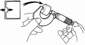

    I did a Google search and found this:
    DesertRatliff likes this.

    I don't see a shim and bucket here. Looks like you replace the lifters to spec after measuring. What am I missing?
    EM–12 1GR-FE ENGINE MECHANICAL – VALVE CLEARANCE
    EM
    (3) Select a new lifter with a thickness as close as possible to the calculated value. HINT: Lifters are available in 35 sizes in increments of 0.020 mm (0.0008 in.), from 5.060 mm (0.1992 in.) to 5.740 mm (0.2260 in.).
