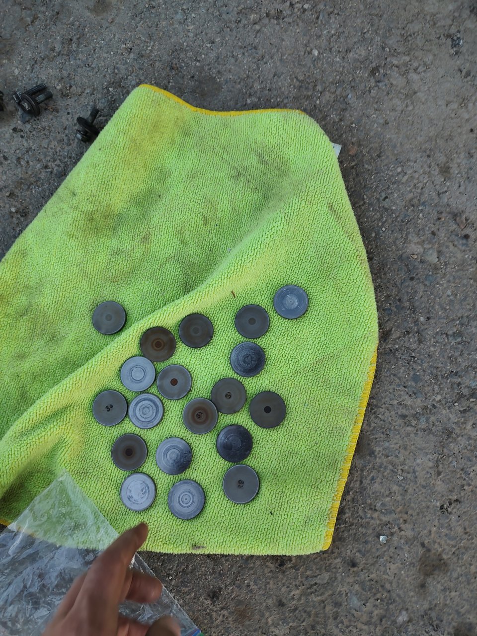

    I'd recommend looking for a pick and pull near you. I was able to score like 20 shims from our local yard for a few bucks. Had a nice assortment and managed to adjust 8 valves in my truck, and 10 in my buddy's '98. IMG_20220511_183106932.jpg

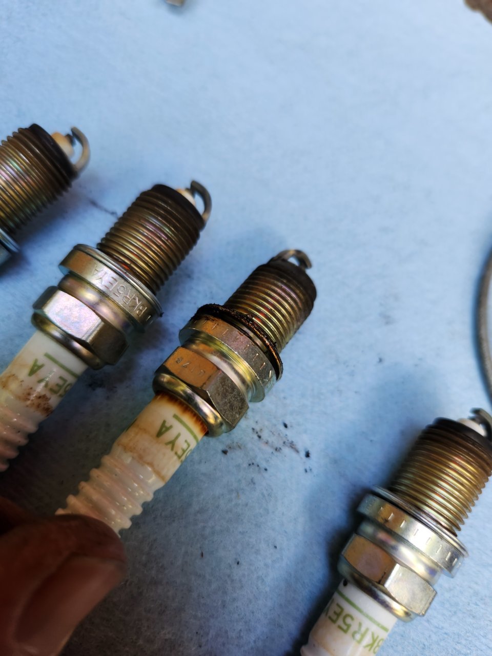

    I'm trying to rule out the big stuff before I chase coils and injectors. Check out this number 3 plug tho. The condition is only after warm up and is non existing at any rpm above idle. Perfect drive ability20230910_140711.jpg
