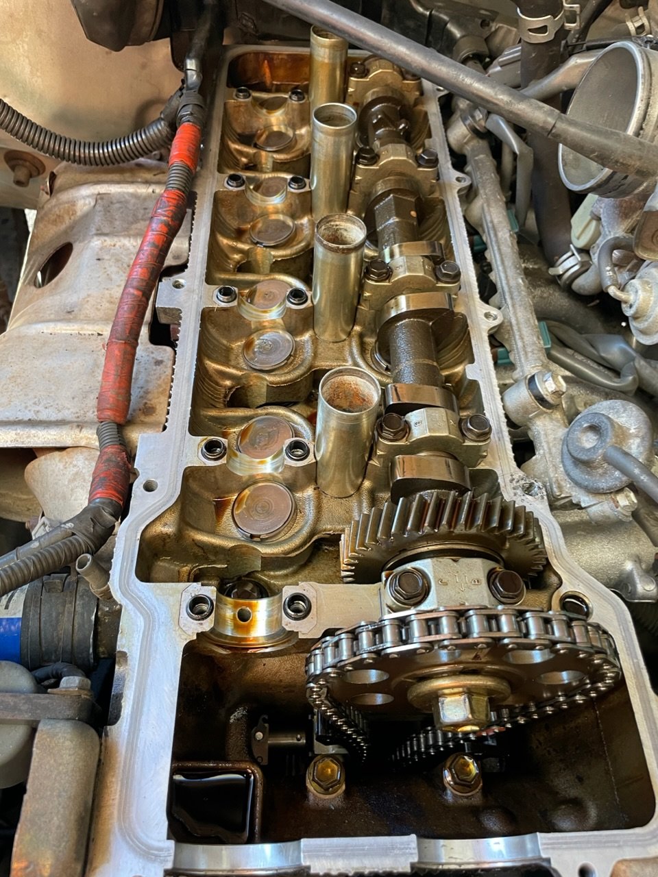

    Cylinder 1 ex.1 is at the min. Cylinder 4 int.1 and int.2 need sorted. I've put it all back together and I guess I need to figure what size shims I'll need. I guess that means dis assembly and measuring the actual shims then doing the formula. Wonder if it being that close can even be shimmed?

    Well the number 4 rear intake closest to the fire wall was a bear. Got all 3 out and measured.
    Cyl 1 e1 0.119 cyl 4 int.1 0.115 int.2 0.114.

    Got the 3 shims and one extra in case. Ordered from lcengineering and they were super helpful over the phone. I almost always call these places to order. Rarely do I just order online. Anyway, I'll wrap this puppy up Saturday. I'm also gonna inspect and clean the actual egr unit.then move on to injectior inspection. They sound fine with a stethoscope but ill try to get the waveform on my uscope for each of them. Anyway I'm pretty confident that this truck is gonna be rock solid for a good while after this and if not I'll just fix it. I would've posted a number of photos but 90 percent of the time I try to post pics it turns it into a pain The ass waiting for it to allow me so I just give up

    Ok just wrapped it up with a new valve cover gasket etc and she runs super good. I'm moving on to cleaning the egr and injectors. Thanks for the tips and motivation yall. Anyone of us can do this job. The ones near the firewall suck and if you don't have the holder tool straight vertical and not twisted right or left blocking the damn shims path into and out of the bucket your in for a bit of a fight. Otherwise straightforward job
