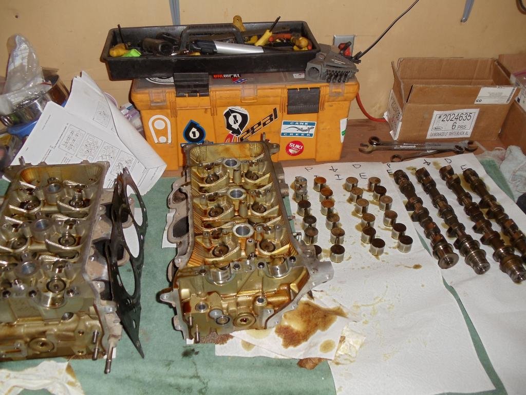

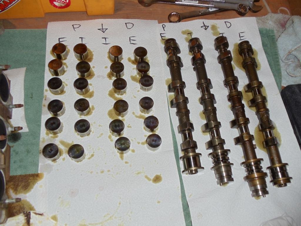

    The lifters themselves are of varying thickness, printed on the bottom of them, I thought I got a pic of the bottom when I was doing my HG, but I guess I didn't. These are the lifters and the cams, to adjust them you would replace the lifter based on the feeler mentioned earlier.
    Here is from my build discussing the lifters:

    After reading the PDF, the numbers I mentioned (37-45) correlate to the thickness per the chart, good info.
