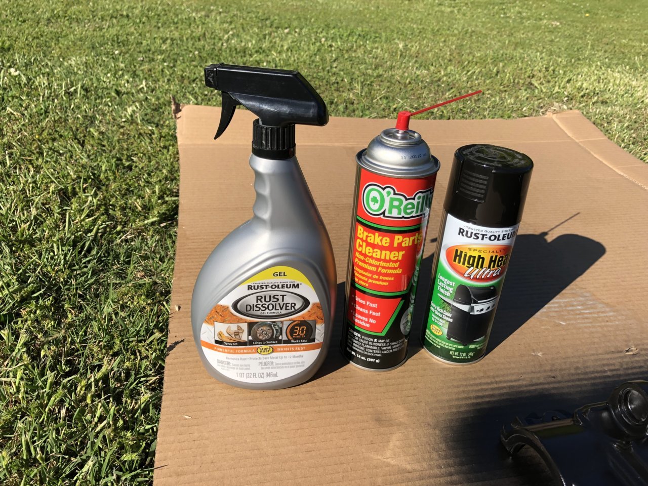

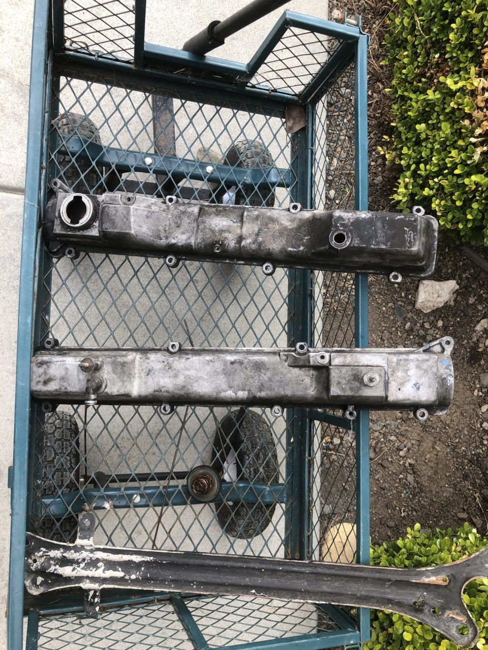

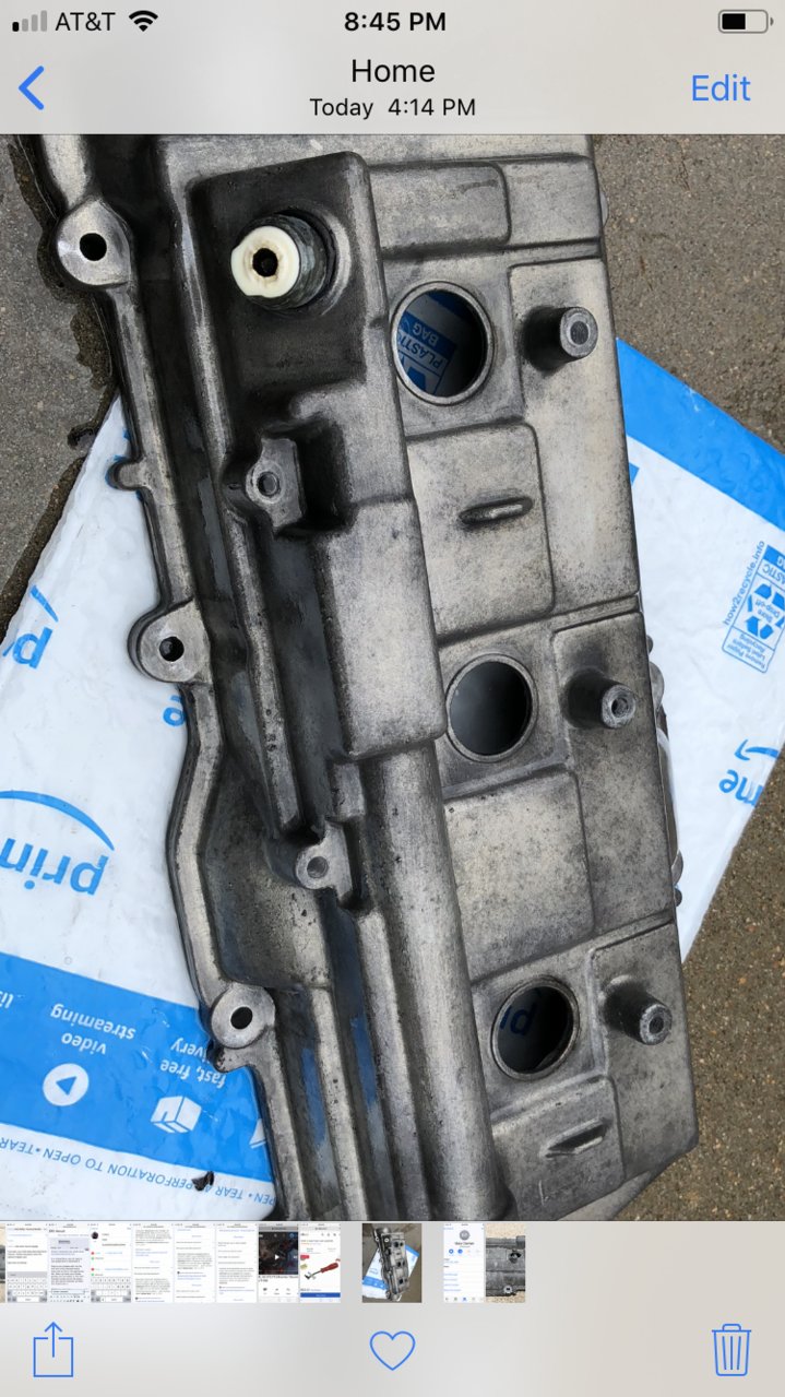

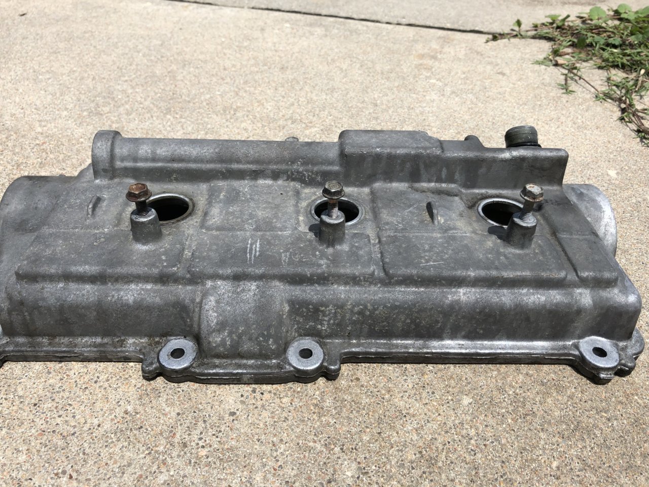

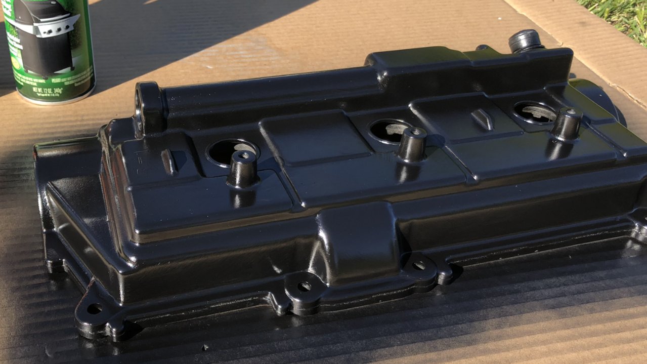

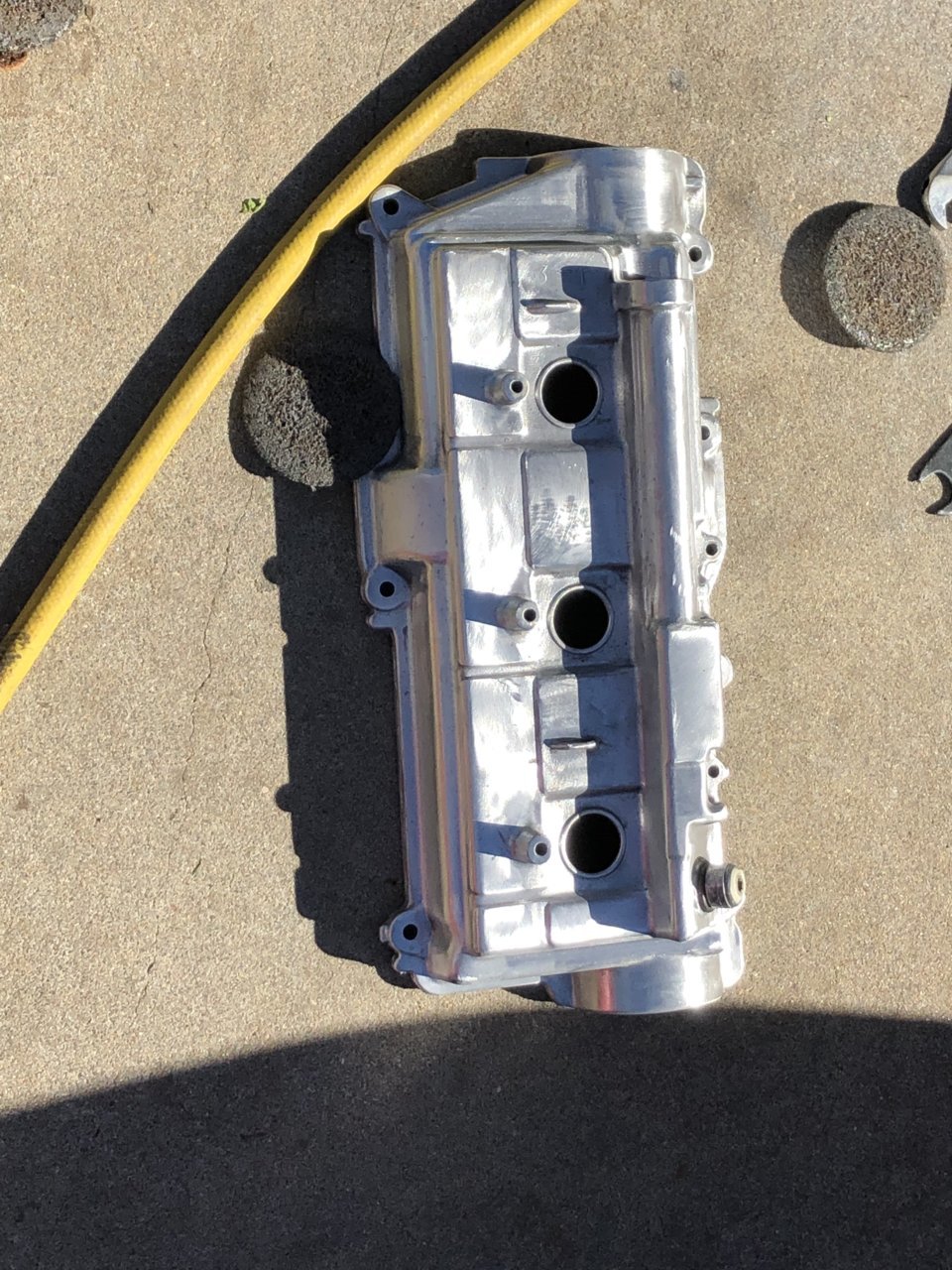

    Well between this and other ongoing issues at the house this is what I got done on the passenger side valve cover. Thank you for your replies but I ended up doing what was most convenient and least expensive. Went to Napa to see what they had... nothing, Ace Hardware... big fat nothing and finally Walmart and they had something that worked well but not brand spanking new looking. Kind of a Rat Rod patina post apocalyptic look. Anyway out came the the Dotco and roloc scotchbrite pads! Oh and my friend at work said don’t you think you overdoing it.... he was right and suggested painting it as babybluetaco suggested. So I painted it.
    High Heat paint was also an issue as some needed special prep for aluminum and some had to be cured in an impractical way. So I went with the 1200 degree, no curing instructions gloss black. Corrosion is removed and valve cover is protected and looks much better.

  15. May 19, 2020 at 5:54 PM
    Tacomasaurus Rex
    Tacomasaurus Rex [OP] Well-Known Member
    Aug 31, 2019
    #303875
    638
    Brian
    2003 Black Tacoma 4x4 TRD fully Automatic
  16. May 19, 2020 at 5:54 PM
    #16
    Tacomasaurus Rex
    Aug 31, 2019
    #303875
    638
    Brian
  17. May 19, 2020 at 5:55 PM
    #17
    Tacomasaurus Rex
    Aug 31, 2019
    #303875
    638
    Brian
  18. May 19, 2020 at 5:58 PM
    #18
    Tacomasaurus Rex
    Aug 31, 2019
    #303875
    638
    Brian
    Oh and this after using Rustoleum rust remover.

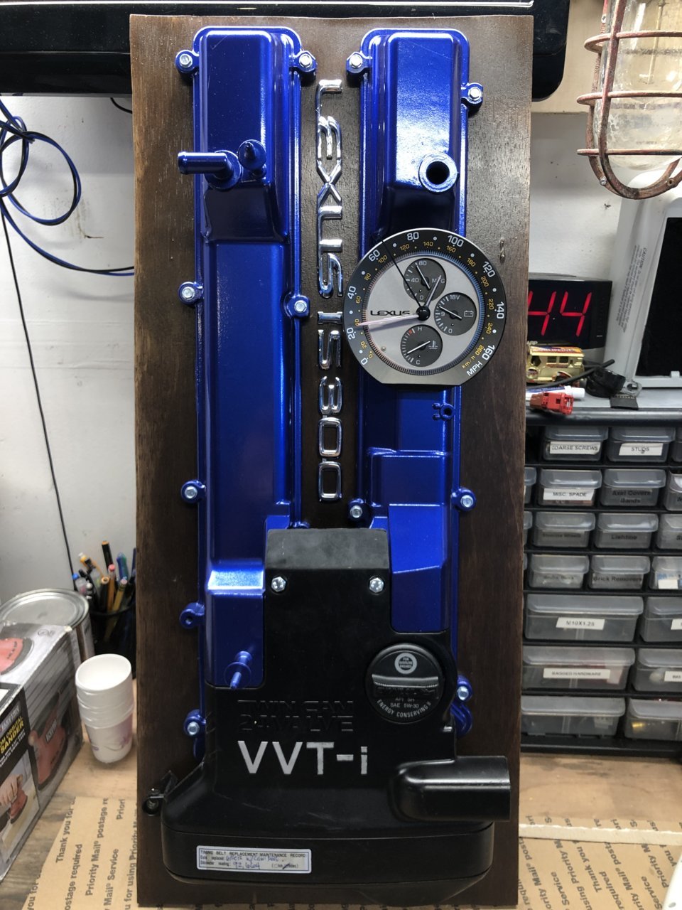

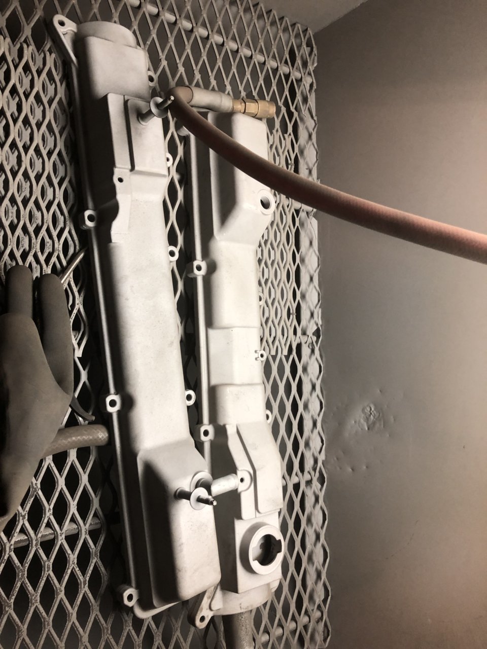

    Sandblasting is always the best option
    Here are 2JZ valve covers I just did:
    E43DD6BA-CBF9-4C48-81B6-55EFAA83E42B.jpg 5ED3DF27-FBE7-4B6C-8D6A-2F38622D8B07.jpg D5917FB1-D95F-4746-8A1F-69A9643E1553.jpg
