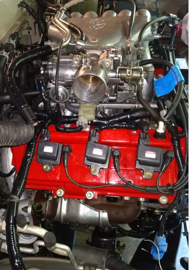

    A buddy of mine had a extra set of valve covers he hot tanked for me and then I went over with a wire wheel on a drill motor to get the scale off of them. I cleaned out the pcv port on the passenger side and the vent hose port on the drivers side with carburetor cleaner and super clean concentrate at full strength and got out all kinds of sludge. I let everything dry out and hit it with some VHT wrinkle paint. and replaced all the hardware putting them back on. It took about a week to get everything clean and preped since this was an extra set of covers. All is good now except all the stuff I took off to get to the covers is now covering everything back up. Oh well...

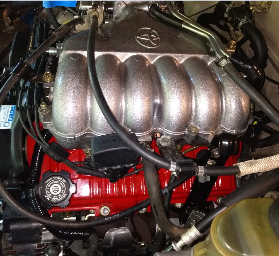

    To speed things up, I have used a 3M Paint & Varnish remover pad to clean up aluminum oxidization on valve covers and intakes. It all depends on the surface and how far you want to take it.
    This particular VC worked out using a combination of scotch brite and steel wool. I did this one 6-7 years ago. Good products to clear coat aluminum have come along in recent years that will prevent oxidization from returning.
    For the Tacoma, the VCs were powder coated in red. Then I polished the intake and throttle body.
    The intake manifold was cleaned and coated with POR-15 Glisten PC.
    This product seems to be working well for the upper and lower intake manifolds. It is a thick product. For the throttle body, I needed to use a lighter product. Duplicolor clear gloss wheel coat worked well for that application.
