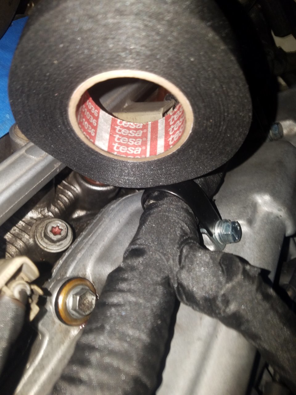

    So decided to add this info here because I couldn’t find a solution when I was changing
    my valve cover gaskets.

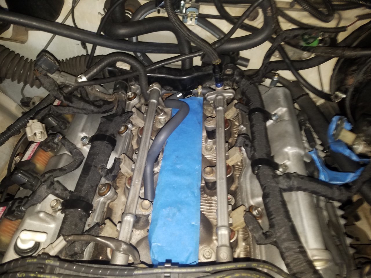

    When changing the valve cover gaskets the wiring harness gets pulled and tugged on
    trying to get the valve covers off the engine.
    The wire harnesses are now coming up on 20 some years old on these trucks which means
    the plastic is getting brittle and breaks very easily depending on how many miles you have.

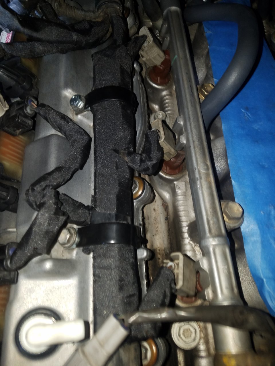

    One side of my wiring harness, the drivers side that sits under the supercharger is completely
    broken and falling apart with the added heat.

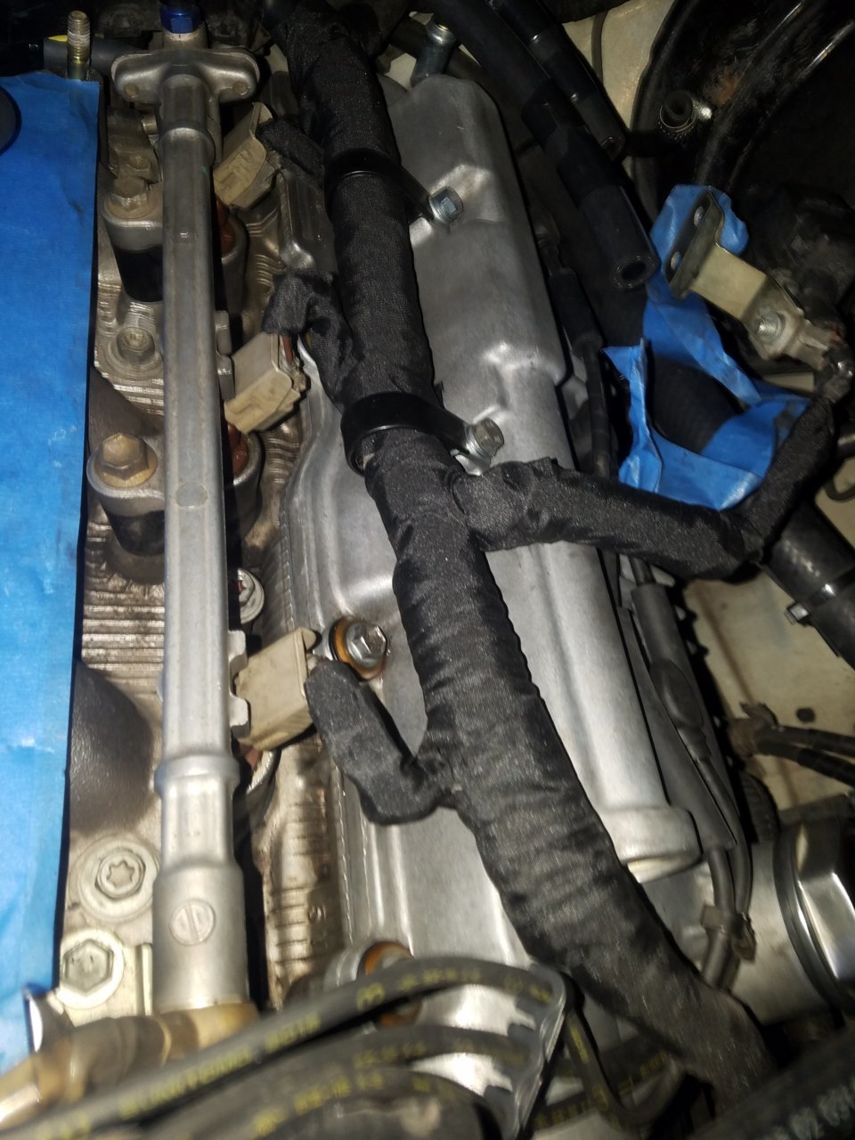

    The passage side there are cracks and the taps to bolt the harness are both broken.
    So my solution was as follows.
    The drivers side I got heat resistant wiring loom and then use the high heat resistant tape made by Tesa and taped up all the areas on the harness.
    The passenger side I taped the remaining plastic heat shield from the OEM shield giving it extra protection and strength.

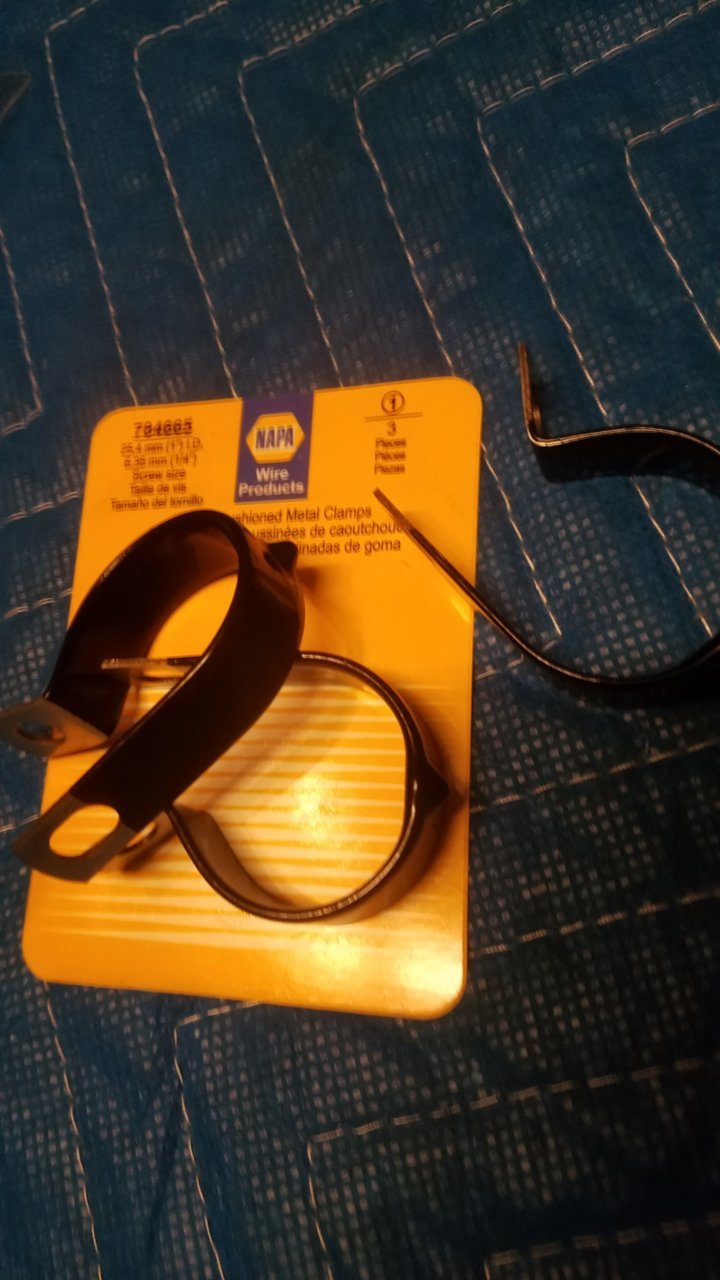

    Then I used the Napa loom clamps that fit perfectly to hold down the wiring harness on both sides as shown.
    The passenger side I bought new plastic loom wire because the original was completely broken and wrapped it with the tape.
    Passenger side I was able to wrap the original wire loom as it was still intact.
    Make sure the new wiring loom fits in the new metal wire brackets.
    The passenger metal wire bracket will need to be bent down or hit with a hammer gently after installing it to clear the throttle body lower section
    It looks great, has all the heat protection now and both sides are secure.
    The Tesa wiring harness tape is one of the best heat resistant 300 degrees ratings tapes available.
    “Tesa 51026“
    BEWARE OF FAKE TESA TAPE THAT DOES NOT STICK WELL
    Product description
    Product Features tesa® 51026 is a PET cloth wire harness tape with an acrylic adhesive. Major Features: High temperature resistance 150°C/3000h
    (300 degrees) High abrasion resistance Color: Black Main Applications tesa® 51026 is designed for the engine compartment, providing high abrasion protection.
    A comparison is black electric tape is rated at 180 degrees compared to Tesa heat resistant tape at 300 degrees. Tesa tape is NOT used for electrical purposes.
