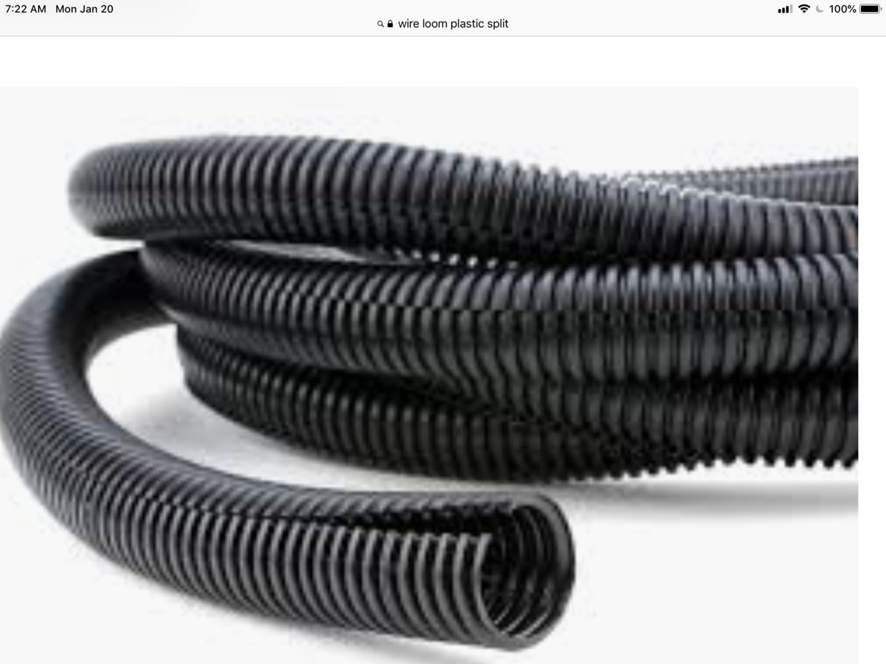

    The plastic wire loom cover on the drives side was completely destroyed.
    I removed ALL of the remaining original factory plastic harness on the drivers side.
    I bought a 5 foot section of aftermarket wire loom and wrapped it with the Tesa tape.
    Make sure the new wire loom fits in the new loom bracket
    Passenger side I wrapped the old original plastic loom, that’s why they look different

    I know its been a while since this was posted originally. Do you happen to remember approximately how much tape it took to do this? Amazon has a 5 pack but I can't see needing near that much, but don't want to get in the middle and run out either if I just buy one roll.

    They use to sell them in 2 packs. Someone must be trying to move product.

    3/4" loom fits well?

    Well enough when snugly fitted in there. I just had to get more creative when installing a one way valve on my iac for the super charger but not an issue that can’t be worked around. I don’t think 1/2 would work.
