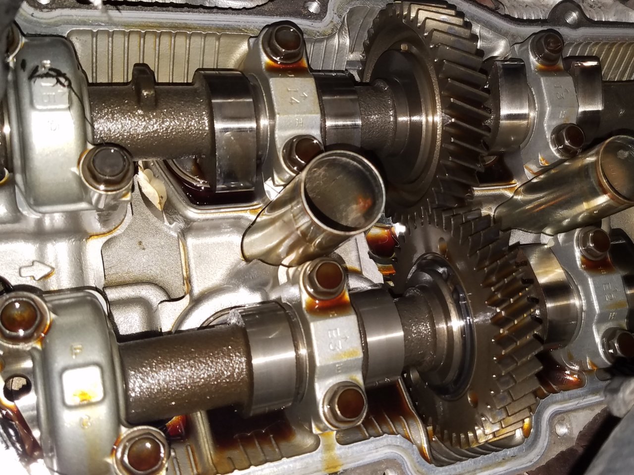

    There is a FULL moon seal under the rear most cam cap that leaks also. Had to go back in on mine to do that one. Some people just by new moons as they come with silicone seals already on them but grey RTV works fine there too.

    Would like to confirm that the full moon cam seals are replaceable on the AFT end of the head only, in other words 2 are needed for a full job. I can't tell by looking at the front if they are replaceable or not and my Chilton Manual doesn't reference itll

    Just rear. Cam seal on front where it exits to cam pulley.

    In the middle of the replacement and in regards to those full moon cam plugs I thought that I had read somewhere that the concave side faces out the back but when I pulled them the old one had the concave side facing in. Does anyone know which the the proper install?

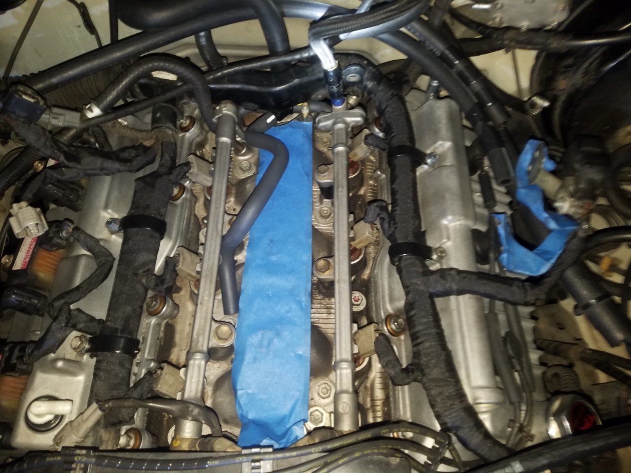

    Clean very well everything above the valve cover. Anything above is liable to fall into the engine as you pull the cover out. Tape up the plastic wire protector above the cover in case it breaks. I used metal tape and regret it as it was very difficult to remove (so difficult I left most of it on there). Maybe blue painter's tape would be suitable given the temporary nature.

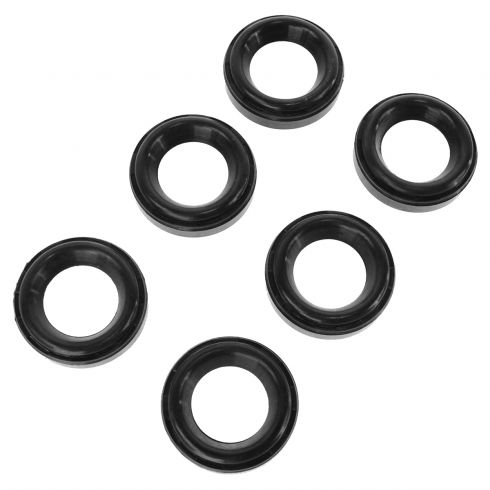

    The spark plug seals seem obvious to me which way they go, but pay attention to the old ones before you remove them. The factory service manual doesn't specify the orientation. The factory service manual does specify the cam plug orientation (concave side facing inwards).

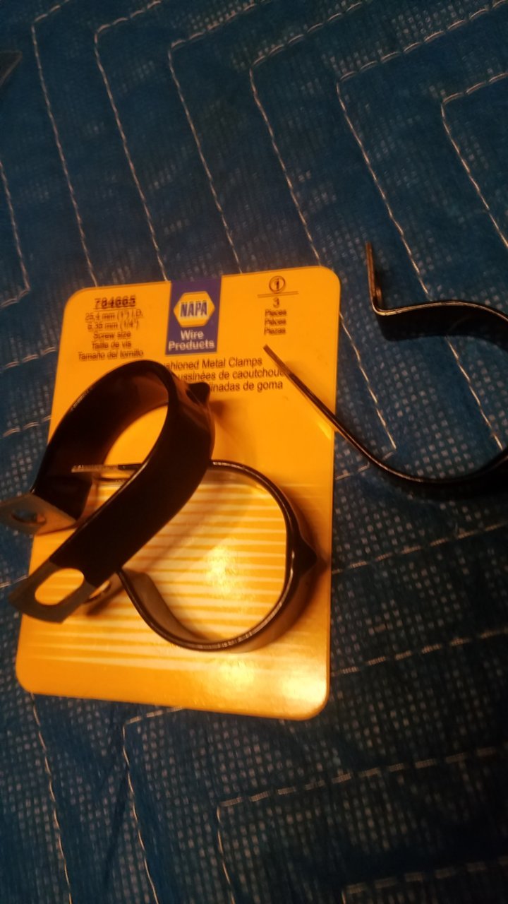

    V6 5sp,RegCab,TVS1320 Supercharger, 56mm pulley, methanol injected Haltech ECU, AC Tvs1320 supercharger,(MUST DO) every 125,000- 150,000 needs rebuild Projector headlights HID 5 speed manual Amsoil for all drive train Smaller 56mm custom pulley, (MUST DO) 2004 DESNO fuel injectors, zero ping ping, 2004 side door mirrors Dick Cepek Rims, Michelin tires LTX, ATM Pathfinders Dynopro ATM ( that last 100,000 miles) Now running Dynopro ATM mud and snow tires KN cold air intake Cat back dual exhaust with ss exhaust tip, Raised exhaust tail pipe to 2" below body line Optima*dry cell battery,red top Alpine sirius radio, 200 watt amp, focal is165 split door pod speakers Focal door speakers Subwoffer behind seat Viper alarm, Electric Locks Dark tinted windows, bucket seats corbeau lg1 Tacoma Rubber floor mats TRD fender extenders, Bilstien shocks, King shocks JBA UCA trailer iv hitch, electric brake control, Drilled slotted brakes, High carbon steel (MUST DO) EBS green stuff 7000 series pads(MUST DO) TRD engine oil cap TRD stick shift, Marlin crawl shift kit. Rear sliding window 2002 4Runner functional hood scoop cut into Tacoma hood, 4Runner dual overhead map light Gentex Auto dim + Compass + Temp, garage,rearview mirror Snow Methonal kit stage 2 Custom 3 core aluminum radiator Linex bed liner Haltech stand alone ECU, Intake supercharger gauge. Stainless steel brake lines, Custom leather wrapped steering wheel, Haltech stand-alone ECU,
    Did mine last month, just take your time, not that hard of a job.

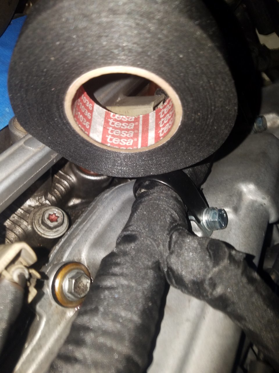

    If your wiring harness is falling apart or broken (plastic heat shield) use some heat
    resistant (300 degrees) Tesa Tape and Napa wire loom brackets.
    I also replaced the heater core hoses and heater valve since I was in there.

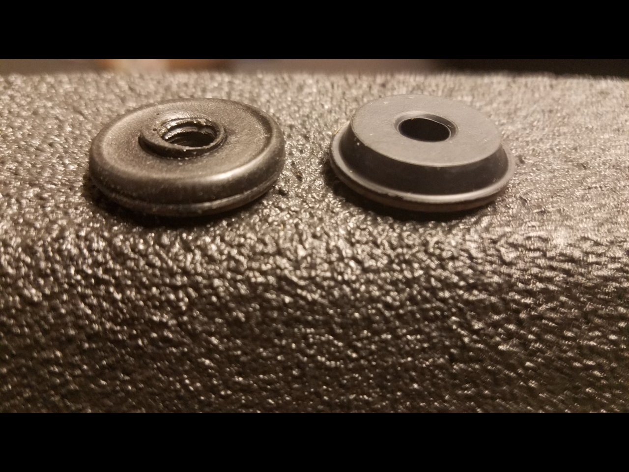

    Those valve cover bolts washers end up shrinking over time from heat and that’s why tightening them
    up sometimes will solve the leak.

    ok but that's not an upgrade. The seals shrink, not the bolts coming loose.
    edit: Look above at pictures from 1997TacomaV6 posts.

    Well, idk if it’s good or not, but that “shrinking” could simply be the squishing that occurs upon installation. If in doubt listening to the FSM (does not specify loctite) is good. Time will tell. I’ll update here in a decade if it doesn’t leak, or if it does leak I’ll update sooner.

    It is. Then after getting hot it holds that shape.
    Putting on Loctite won't CAUSE a leak.

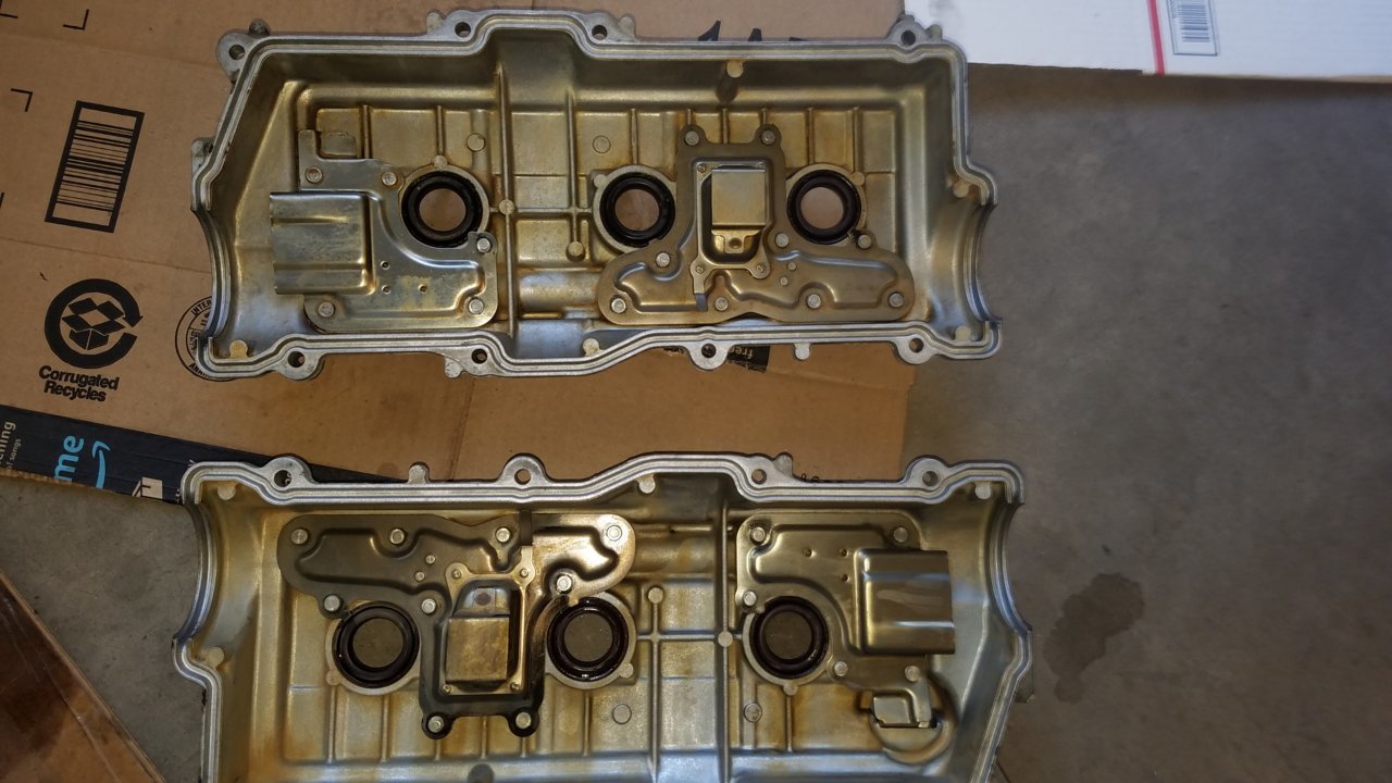

    Well I'm kicking myself now because I just put the spark plug tube seals in backwards... I just put the covers back on but didn't put the intake back together yet. I spotted it while watching a youtube video. What are the chances it'll be alright? They still make a tight fit. I can't believe I did that...:frusty:
  20. Jan 19, 2019 at 7:52 PM
    #80
    PittsburghTacoma
    PittsburghTacoma Member
    Jul 29, 2018
    #260981
    7
    Chad
    2002 Tacoma extended cab 3.4L V6
    [​IMG]The side of the seal that you see in this pic...should it be facing toward the engine or toward the hood?
