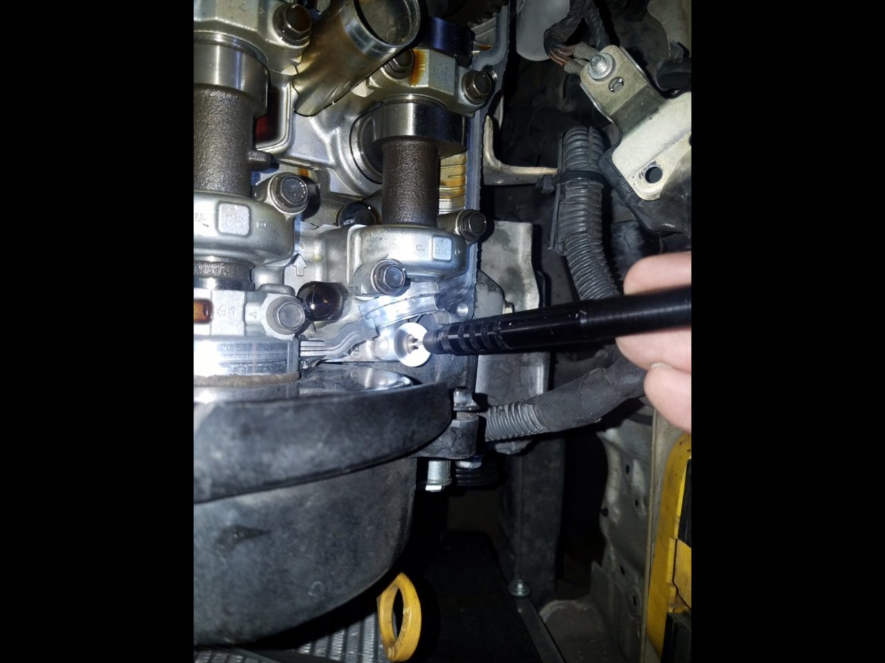

    So in the pic in my previous post, should that side be facing outwards or inwards? I didn't have to use a pick, but i had trouble lining it up to get them to slide around the tube. The seal has a slight taper. Should the flared (wider) end be towards the valve cover or the camshaft?

    I can't see the picture clear enough to tell.
    I think the wider side goes up otherwise the oil would be able to be forced out of the seal.
    Like said before, they're tricky to tell by looking which side is which. You kind of need a reference pic.
    I do just know it's harder to put them on right than wrong.

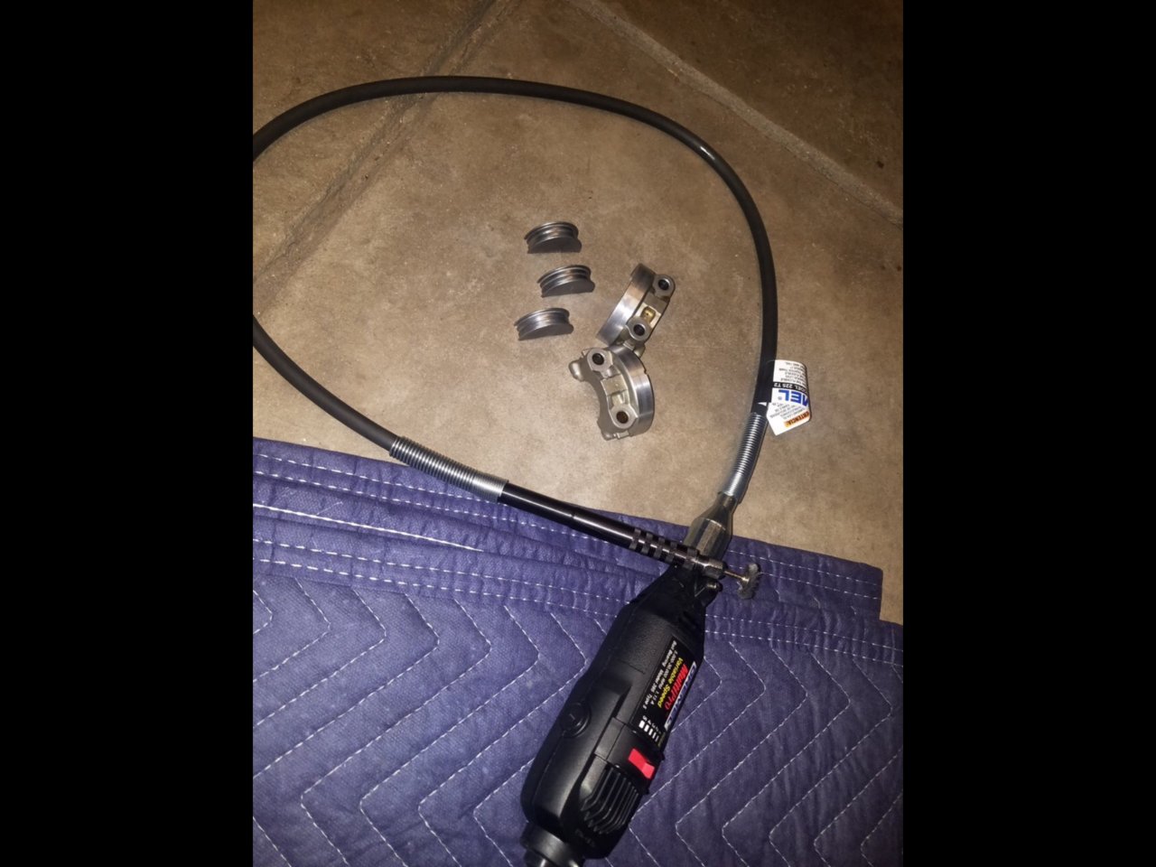

    A dremel with the cable wand makes short work of cleaning all the old gasket material off the half moons and valve covers.

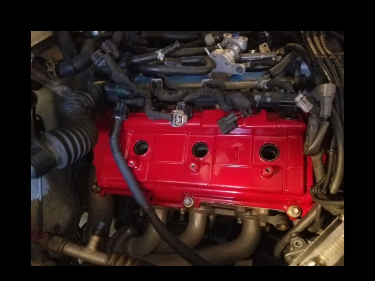

    Also now is a good time if you decide to get your valve covers powder coated.
