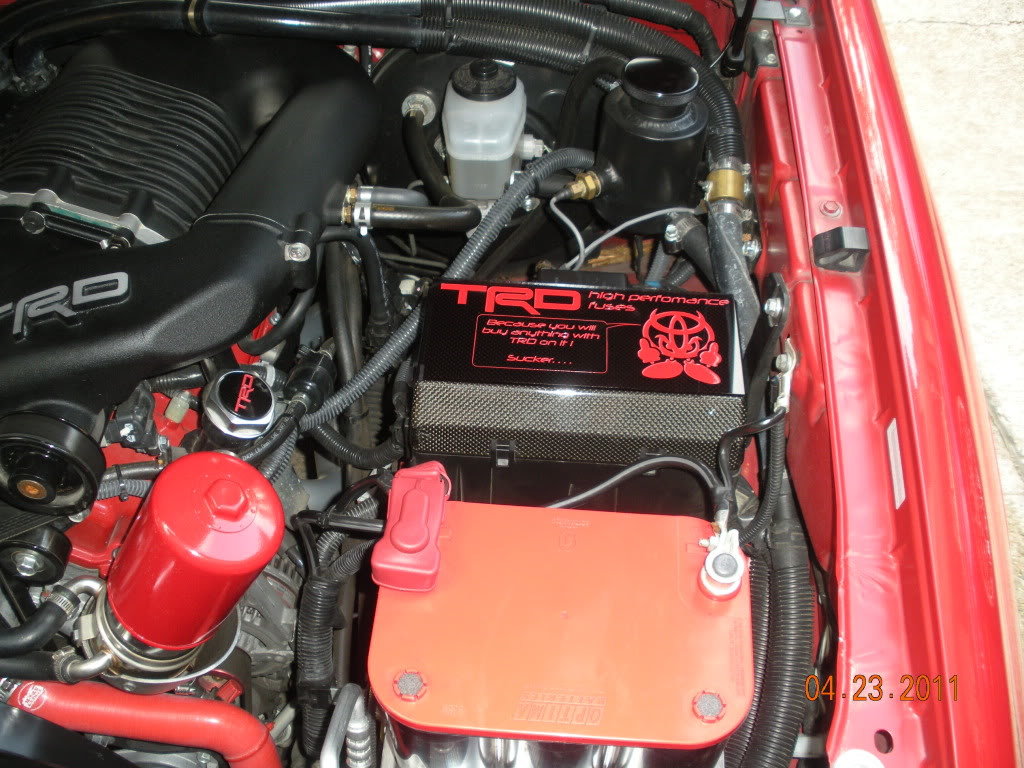

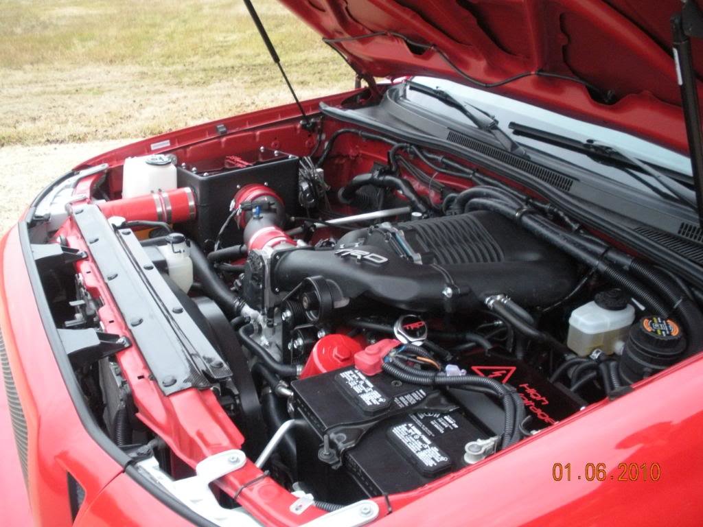

    Also if you use the Tundra filler neck, it is shorter and fits better.
    Not great pics, but I think you can tell the difference.
    Tundra neck.
    Tacoma Neck.
