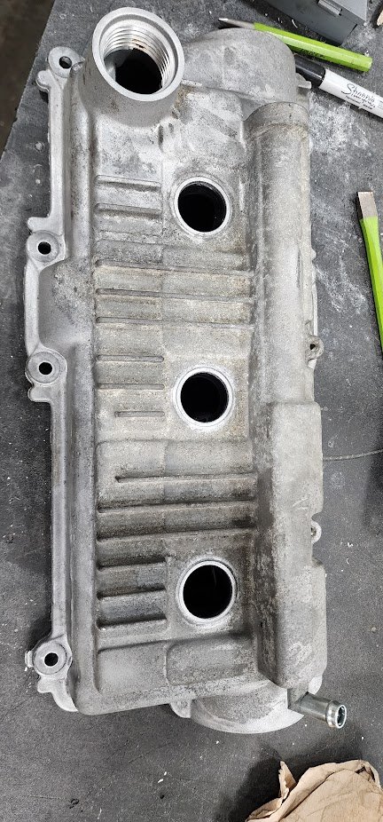

    AP1GczMj0hNRdJbCyP1fH0Tv6-FPl9P4liayEjyy_c9b4441d00ac55f9e948f3946c645b283815d900.jpg

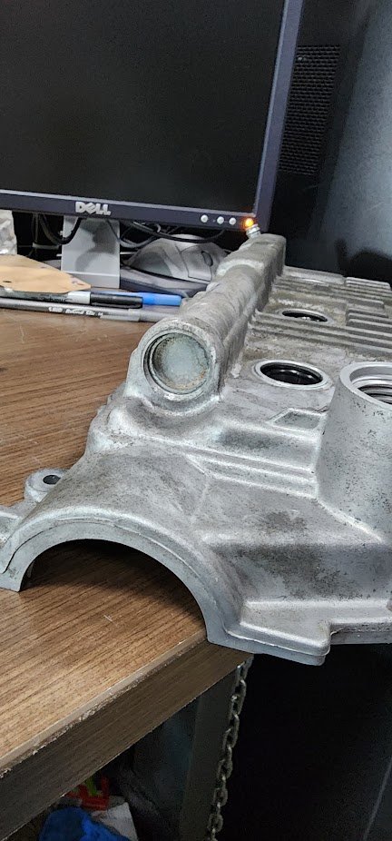

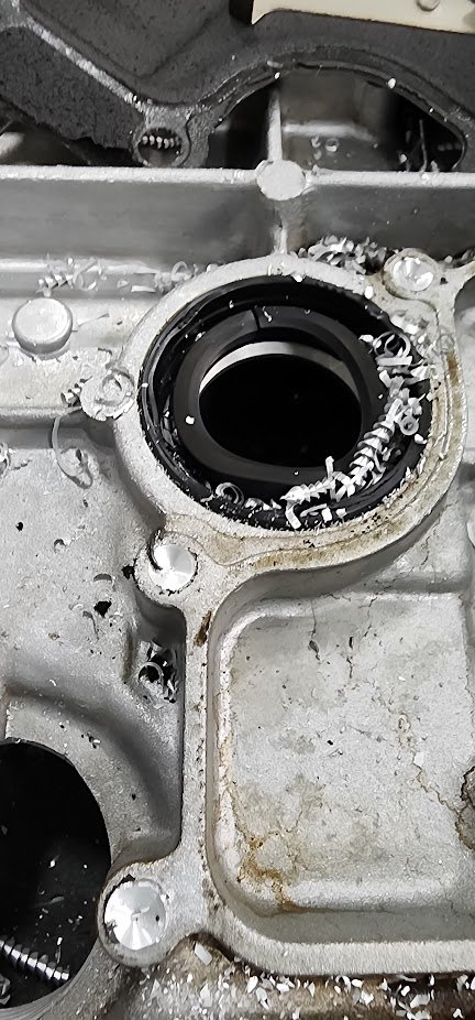

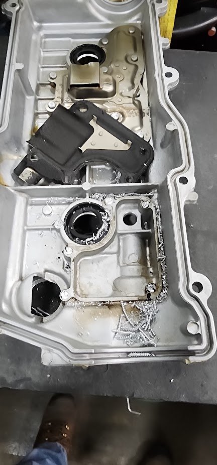

    So I got adventurous today and removed the baffles from one cover.
    Just for the record, those aren't rivets afterall. They are aluminum posts that were sonically deformed just like I originally thought. There is no hole underneath, just more aluminum. I haven't decided what I'm going to do exactly yet. Mainly concerned with the type of screw to be used. I like the idea of tacking the edge of every screw just to make sure they don't come out. So the screws will need to be SS ideally. There's enough meat there to use a 1/4-20 screw, but if I can find maybe a #10 with a really wide head that would be better. Whatever it ends up being, I'll need to pick up some 'plug' taps to make some short holed threads. All I seem to have is taper taps. Also need to find replacement plugs for the vent on the top side.
    AP1GczOZ_3DdKY5u9X7oezEbnUNB_mxPNOuDS3j3_c1893ff047852281d384177f7b058aa73191fb37.jpg
    AP1GczP7gP3TVkpNzG_rWyIBx0vRAUGL6VtV5FZE_a6e60d32438bca74046f4c7ab9ccf01cb9428d88.jpg
    A picture of the top. They looked a lot more "black" when they had just come out of the hot tank. Still you can see that darker buildup. Blasting will take care of that. I'll probably just use my fine media.
