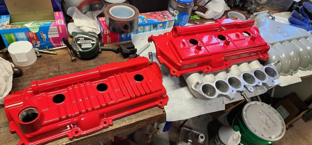

    Update
    Got em done. Had an outgassing issue with the upper intake. I was juggling a lot of parts and forgot to prebake it so i got some bubbles in the clear. Valve cover came out great tho.AP1GczO98qhUmOf2Z4zriy7g1LqkJOL_bship9gA_e0a156c80efb5f356487cc21bed58383dfeb341c.jpg
    AP1GczPfZtNPF7ASGZyAFWAv3D7ozTB61-YdSLGo_208f34cd11b0936135a38af8fd4598ce7d0f6c5d.jpg AP1GczMUY4fNEAVYUL06aJtkFx08s_uvvj72bN3P_0d8f891499d5908192604864ac359ab4146d1245.jpg
