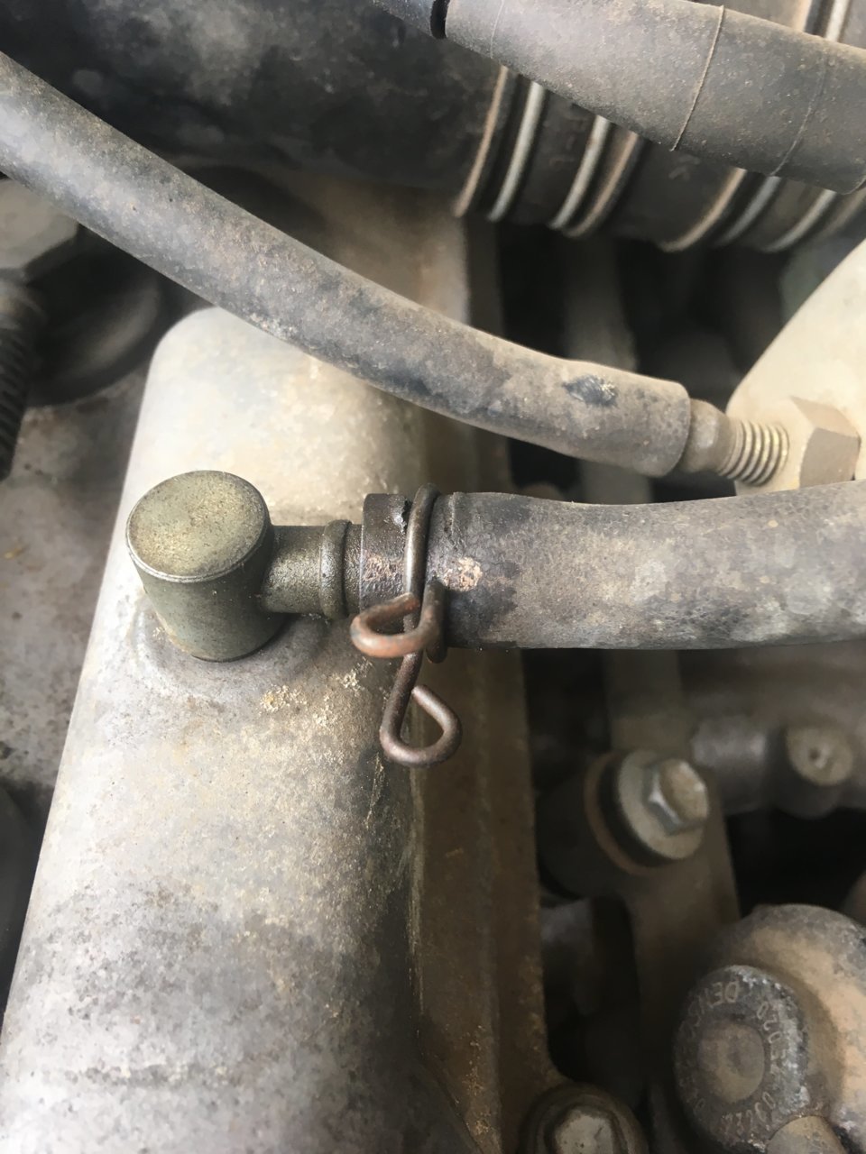

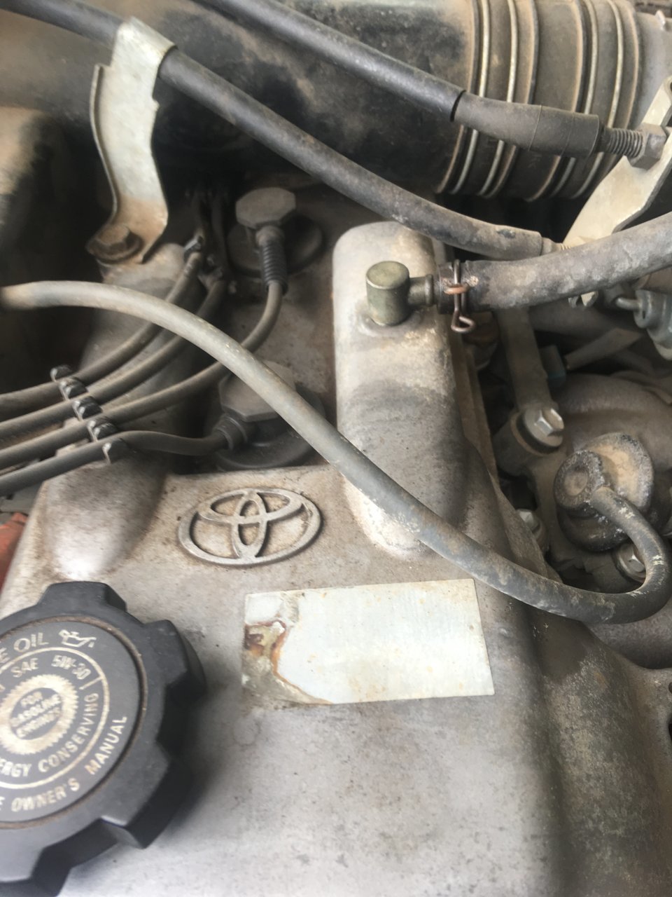

    2.7l 98 tacoma
    Trying to identify this valve. It’s on a 98 2.7l. Thanks!

    It's less Tacoma and more mod
    Its just the PCV inlet breather, it's pressed into the cover and has no moving parts or anything to service. Just a port. The one on the back of the cover is the PCV valve and it has a grommet that'll need replacing
    The inlet? It gets filtered air from the intake tract before the PCV gasses, maybe every 300-400k it'll need a wipe down haha.

    Yep, you're right, my bad, these 72 yr old eyes looking on my phone pic which is way to small,
