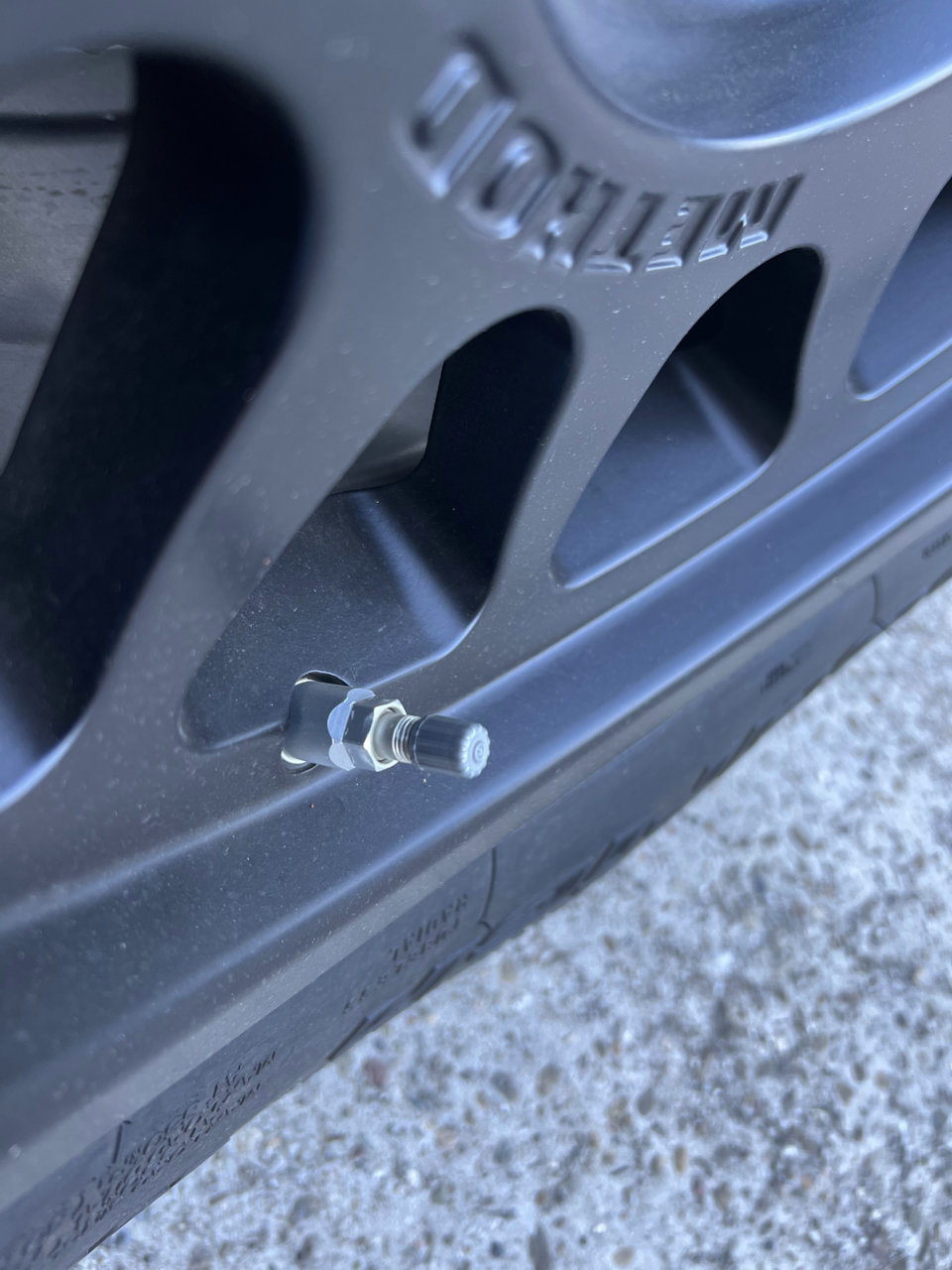

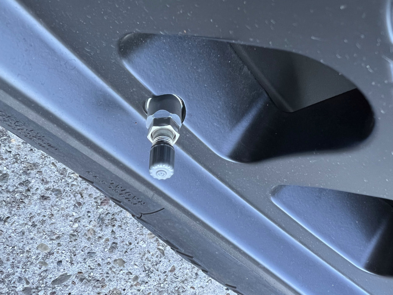

    Put Method 305s on and my valve stems are out there. Almost flush with the edge of the rim. First off-road trail and they will be beheaded by a rock. I didn't specify a valve stem type from the installer and, to be honest, they may have been from my prior wheels that had a more inboard stem location (SEMA then Ikons).
    So, what are my options? I prefer to run TPMS on my 2019 OR, but want a lower profile and/or rubber stem.

    You need banded TPMS. That way, you can run a stubby rubber valve stem. You can break the bead and replace the stem on the trail when it breaks off without damaging the sensor.

    These wheels are pretty famous for having the worst placed valve stem for a more offroad baised wheel

    I was excited to try out the Bead Grip technology. But, it won't make any difference if I lose a stem first! Banded TPMS may be the best solution.
