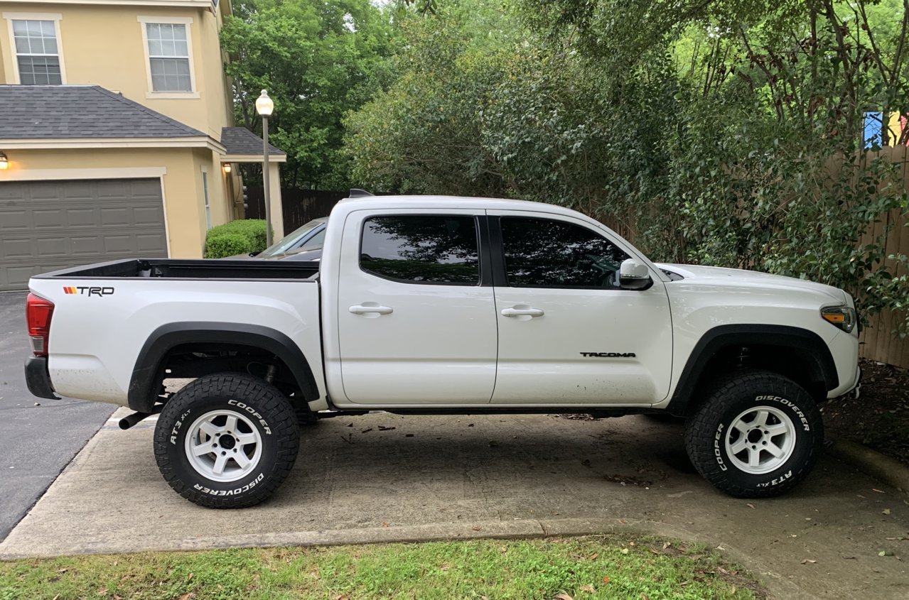

    Just switched from 5100's due to the stiff road driving. I only wheel a few times a year and even then it's nothing major so I opted for Fox 2.0's all around (just over $1k front and rear, same lift as the billies) and it's so much smoother. Rear resi, front non-resi.
    And the rear wheel well doesn't look so empty with the main shock body being on the frame and the piston on the axle.
    2.5's would have been overkill for my purposes though they are a killer suspension.
    The lift is just where I want it with the medium Dakar springs in the rear. Slight forward rake.
    (I increased preload on coilovers driver side 10 turns, passenger 7 turns. The wheels are 285/75's, no rubbing)
    Very happy with the 2.0's.
