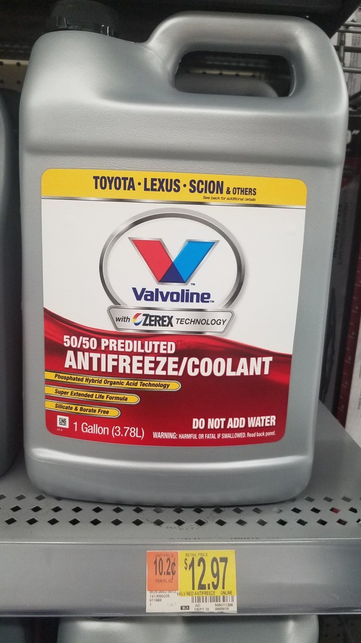

    Is it okay to use an alternative coolant instead of what they provide? Is there any risks? I'm asking because I saw a valvoline one at the store today marketed for Toyota Lexus Scion etc. Any insight is much appreciated. Thanks guys.

    Should be fine. Looks like it is HOAT. Is it pink or red?

    I didnt open it I just saw it and was curious about it since I'm due for a drain and fill on the radiator and it seems to be cheaper than the dealers stuff. I'll take a look next time I'm there. Also what is HOAT?

    I've been doing drain and refills with that Valvoline stuff from Walmart for years.

    Really? Sweet I'll be trying this then. Good to know others have used this.

    Hybrid Organic Acid Technology. It is what Toyota specs for their coolant.

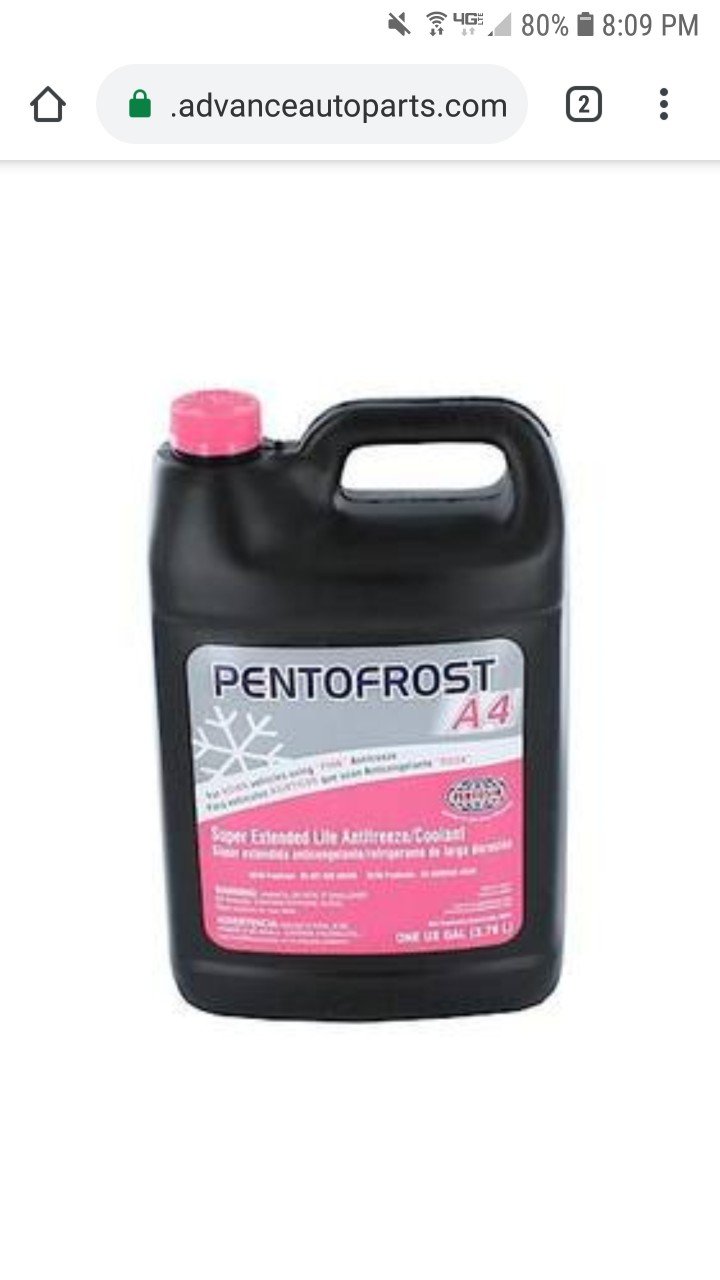

    I did a full coolant flush and used pentofrost wth zero issue.

    Kind of late on this but I wanted to update in case anyone stumbles upon this thread. I used this back in August of 2020 and It's been working fine.
