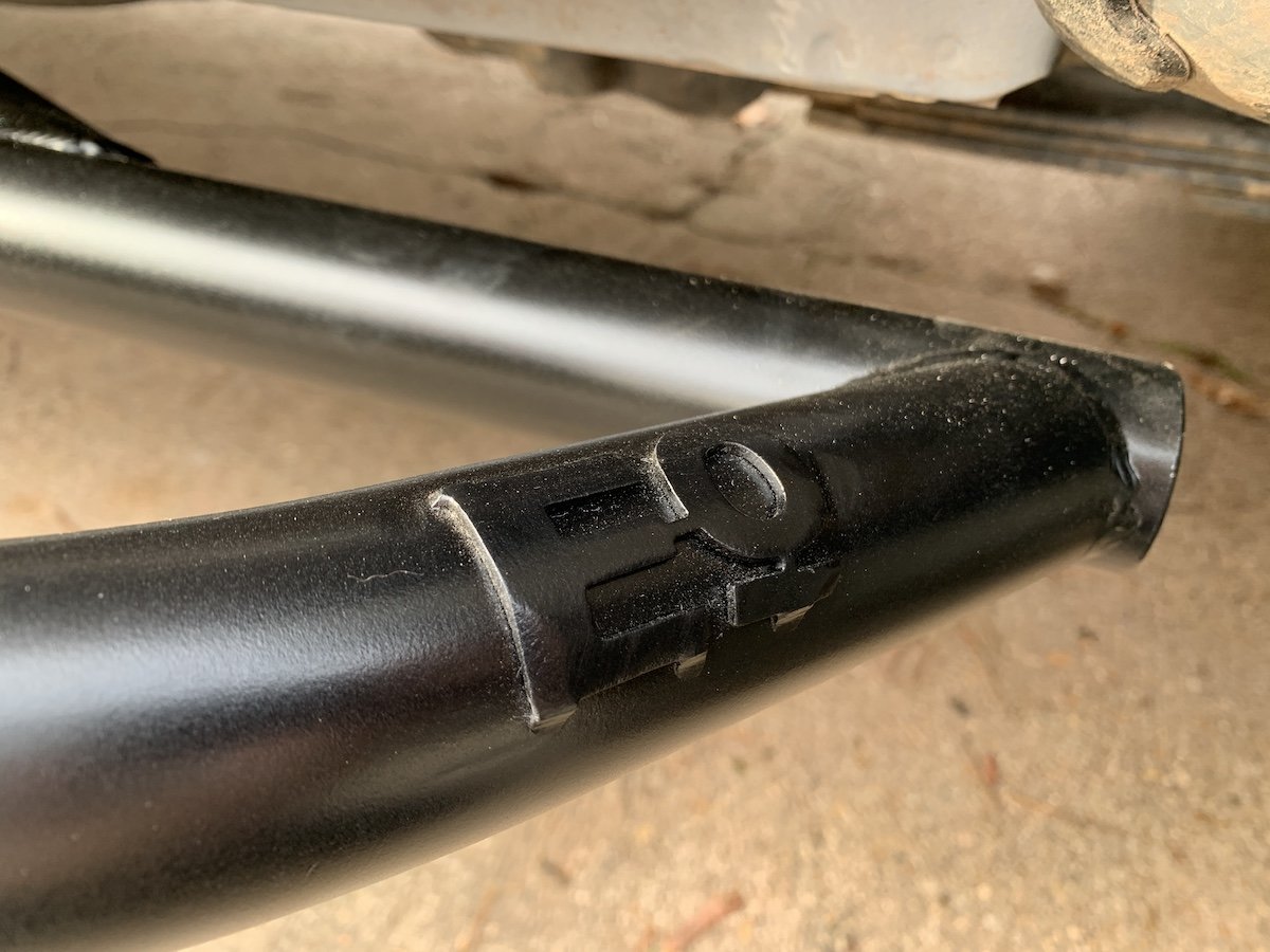

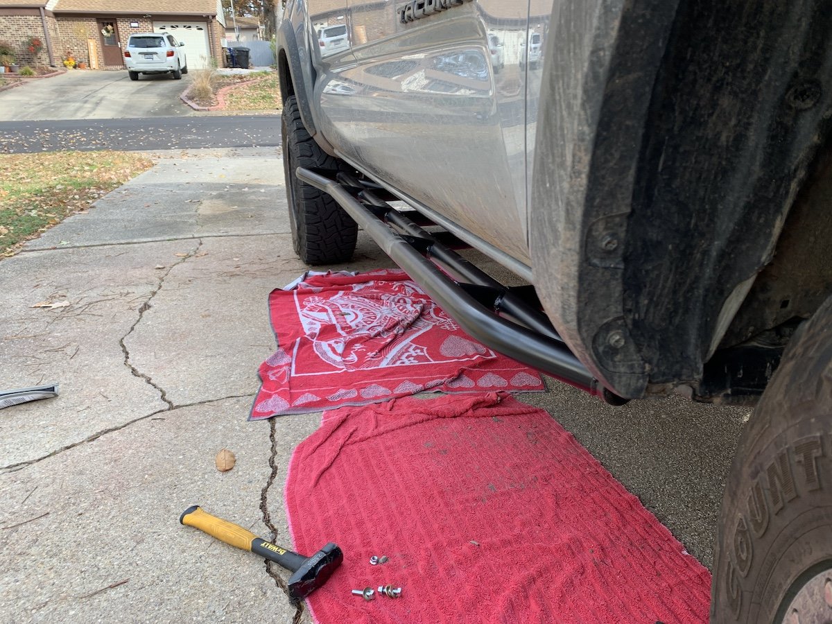

    After a 6 month wait, lots and lots of spray paint and way too many hours trying to get these mounted, I FINALLY have proper rock sliders. I cannot wait to get back out to the trails with the additional clearance!

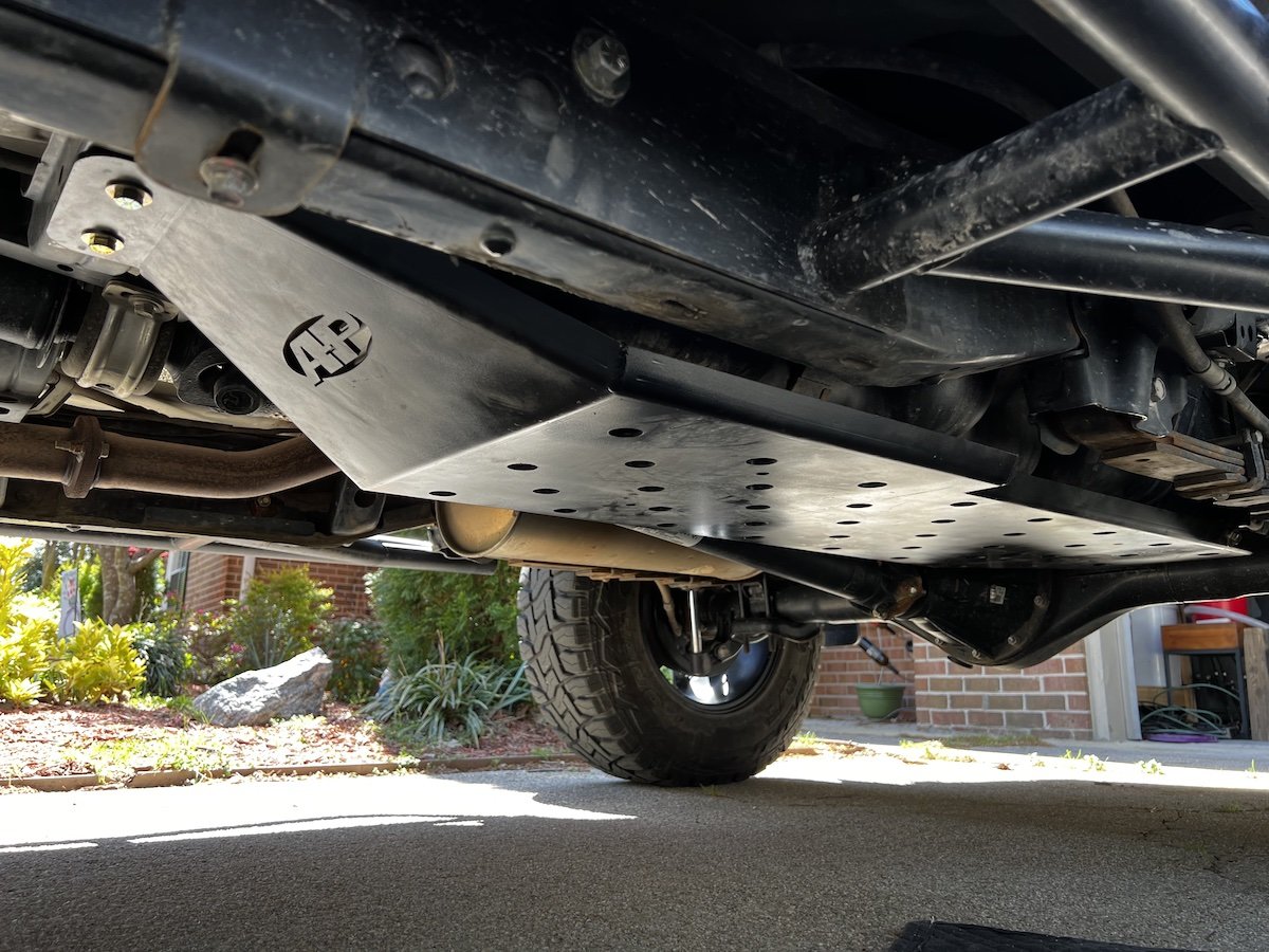

    Not a lot of updates on the build for awhile but I just didn't have the energy over the holidays to deal with mods or doing them in the cold. Things are warming up and I've gotten back on it. I spent the last few months planning the bed storage and camping setup and collecting parts. The bed will feature water, power, air and gas with a fridge, hot water heater, store and sink. This weekend I got started on the lower frame. I used 1x6 stock with dados to save some money and weight. The sides are 3/4 plywood and once I have the drawer slides in place I'll make some reliefs for weight. I'll run by and grab more plywood for the top this week. This will be 2 parts so I can remove it when necessary and was all designed around the 10g water container. With the 14" height I think I have space for an additional drawer on both sides so I'm showing a rough mock here.
    I also got tired of tripping on the fuel skid laying my garage since the fall and got that on. Finally, I added a GMRS radio last month and have started collecting parts for the 2nd battery install.

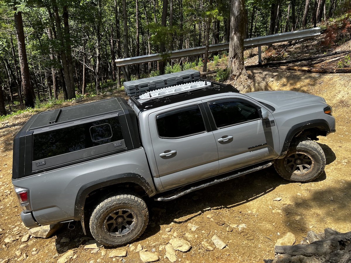

    Uwharrie didn't disappoint. There were some great trails and the event had reservations for a ride on private land throughout the day. Friday night's late-night wheeling was the best part.

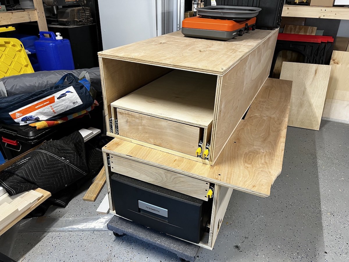

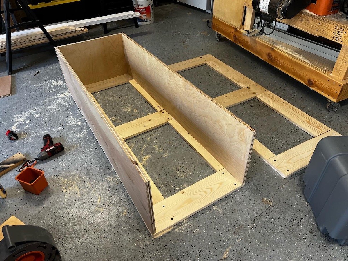

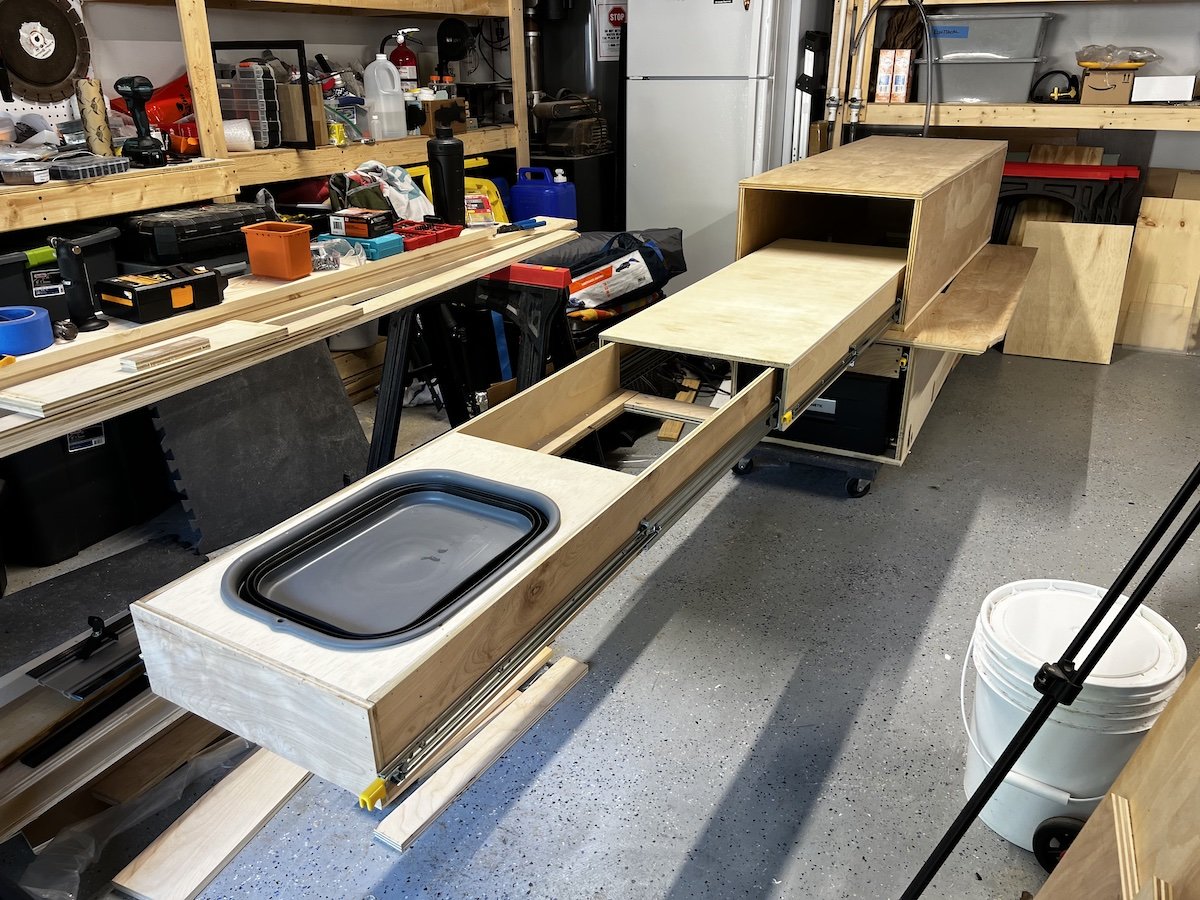

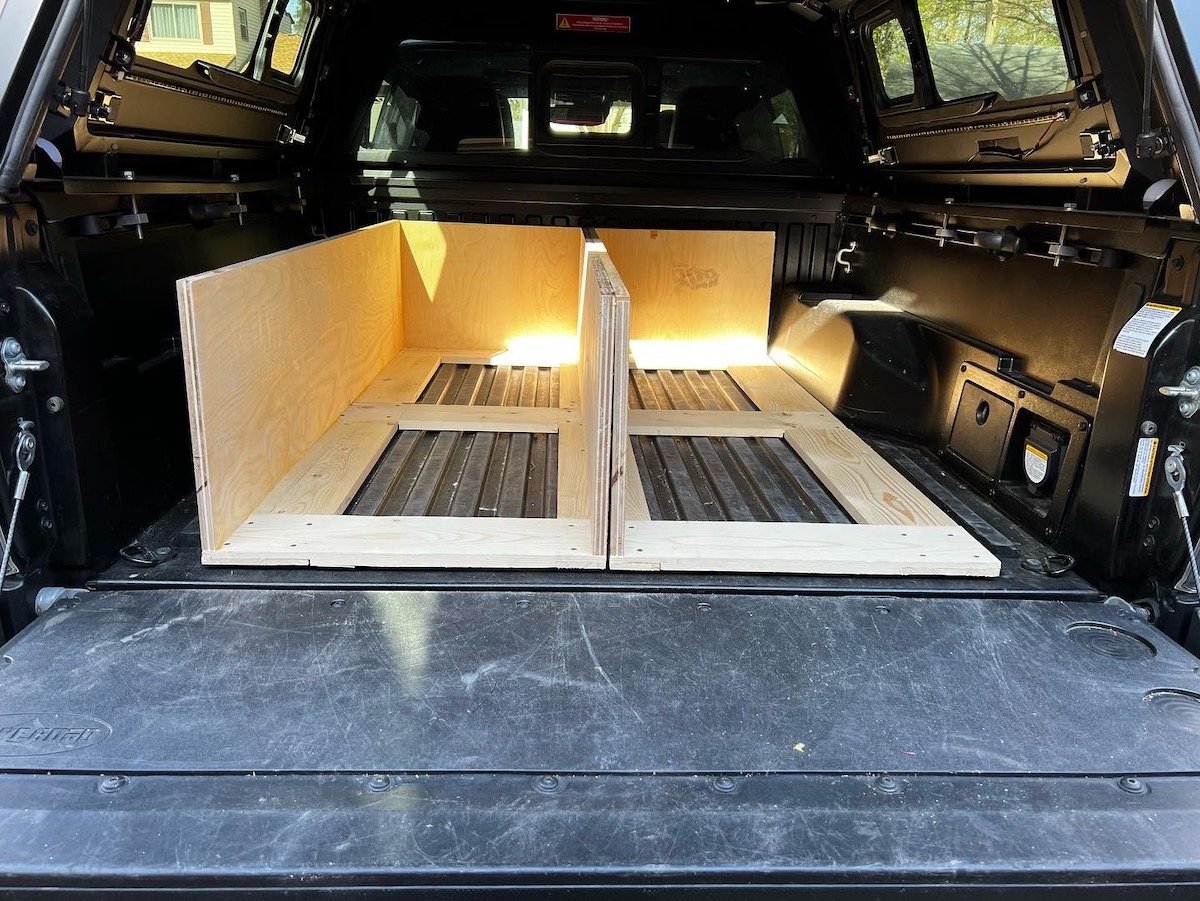

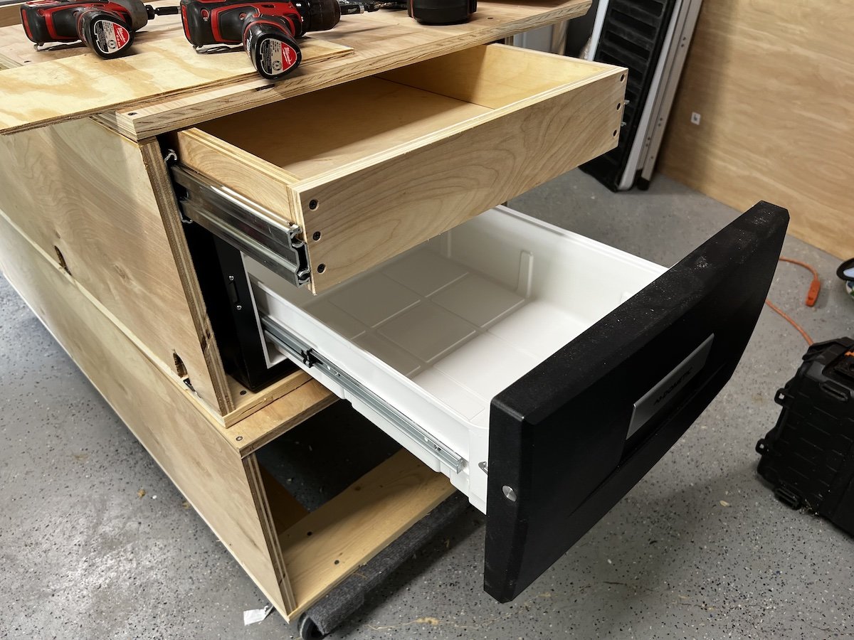

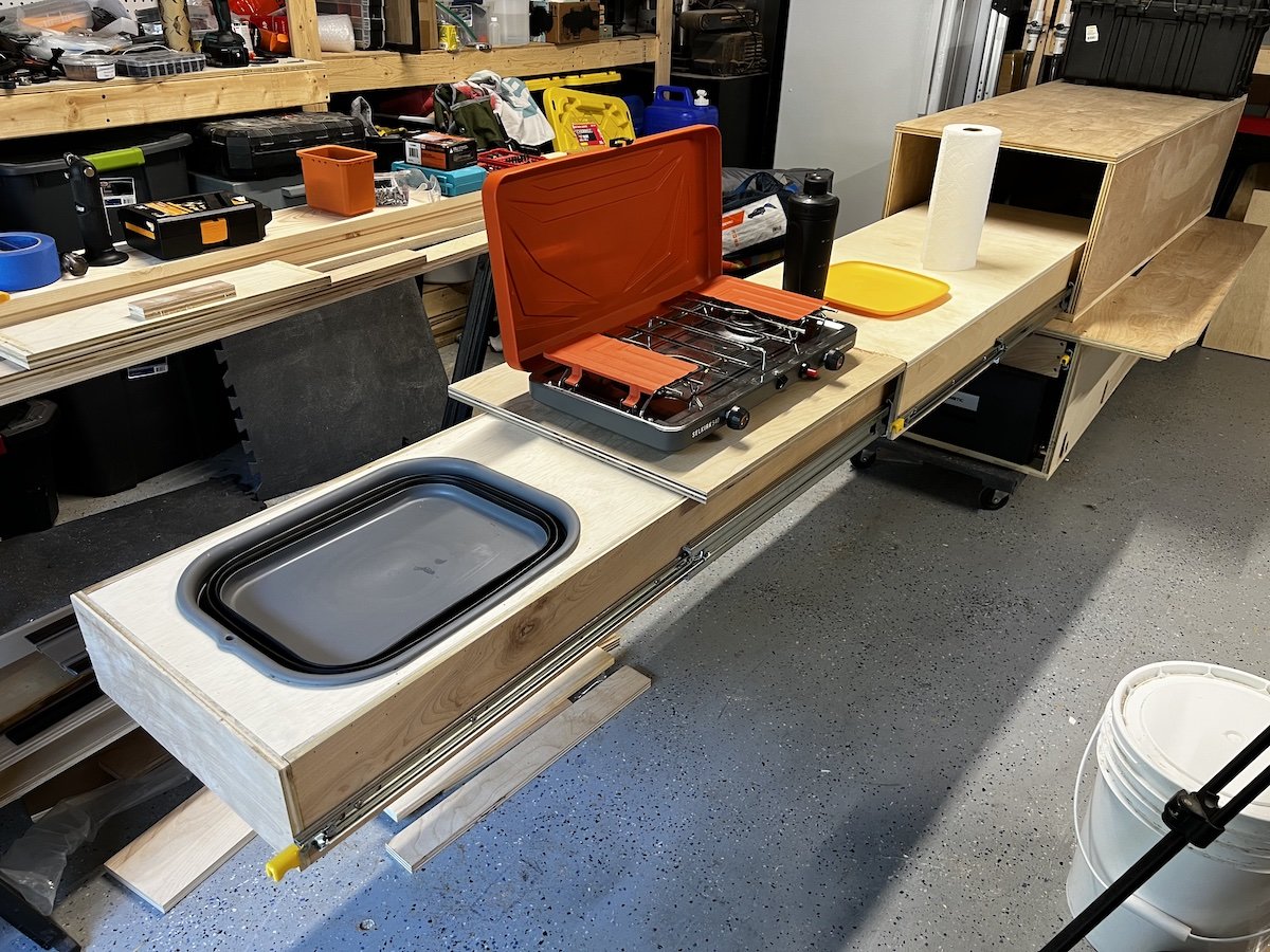

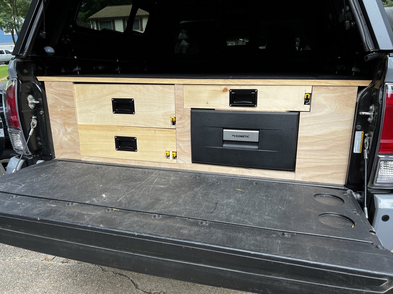

    It's been slow going but here is some progress on the kitchen and storage. Left is cooking/cleaning/sleeping and right will be fridge/utensils and tools/water/air/gas. I have another drawer to make and hope to have the custom stove pop-up done (shown mocked up).
    So so so much left to do including relief cuts for weight, wiring, plumbing, carpet, hatch covers, tiedown points, drawer faces etc. Note that the "wing" that goes over the wheel well is only on the right. The left will come off so I can remove the drawers if need be. This will all be wired with a fuse box behind the fridge to a 4awg Anderson plug running to the front with a Redarc BCDC1225d.
    This has been difficult without a plan. I was mocking it up on the fly after over a year of dreaming it up. Lots of trial and error. If I had to do this again I would go with all 1/2" plywood. The 3/4" is just super heavy, was way too expensive in this day and age and way overkill. This thing will be a rock when it's done but I really don't think it's needed.
    Road_Warrior, ilyace and T.Barn like this.

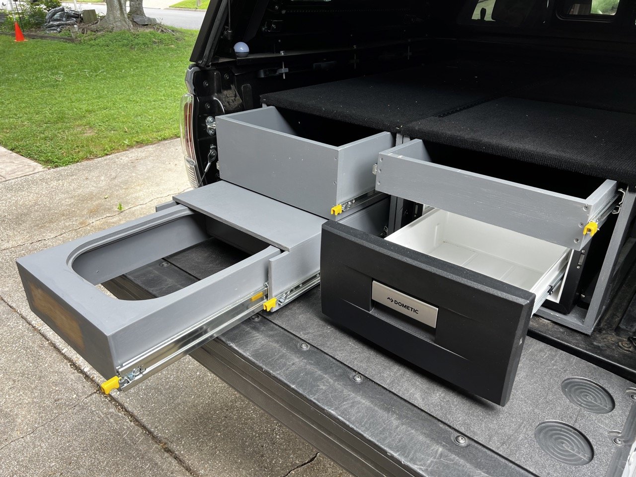

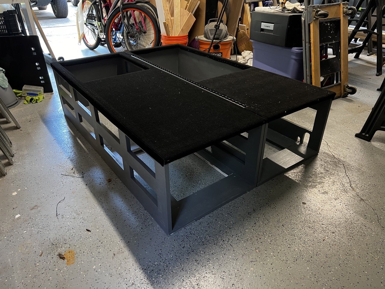

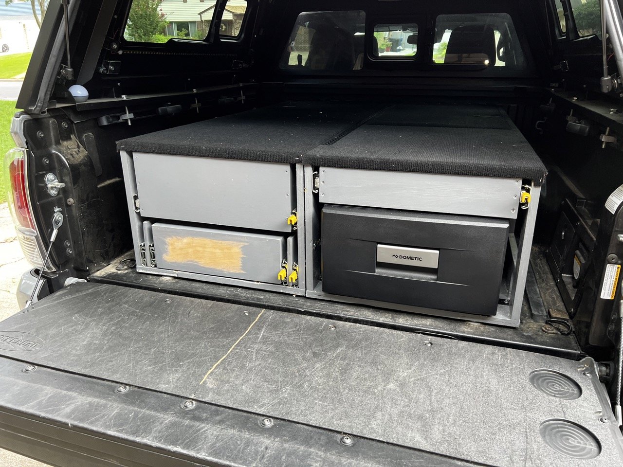

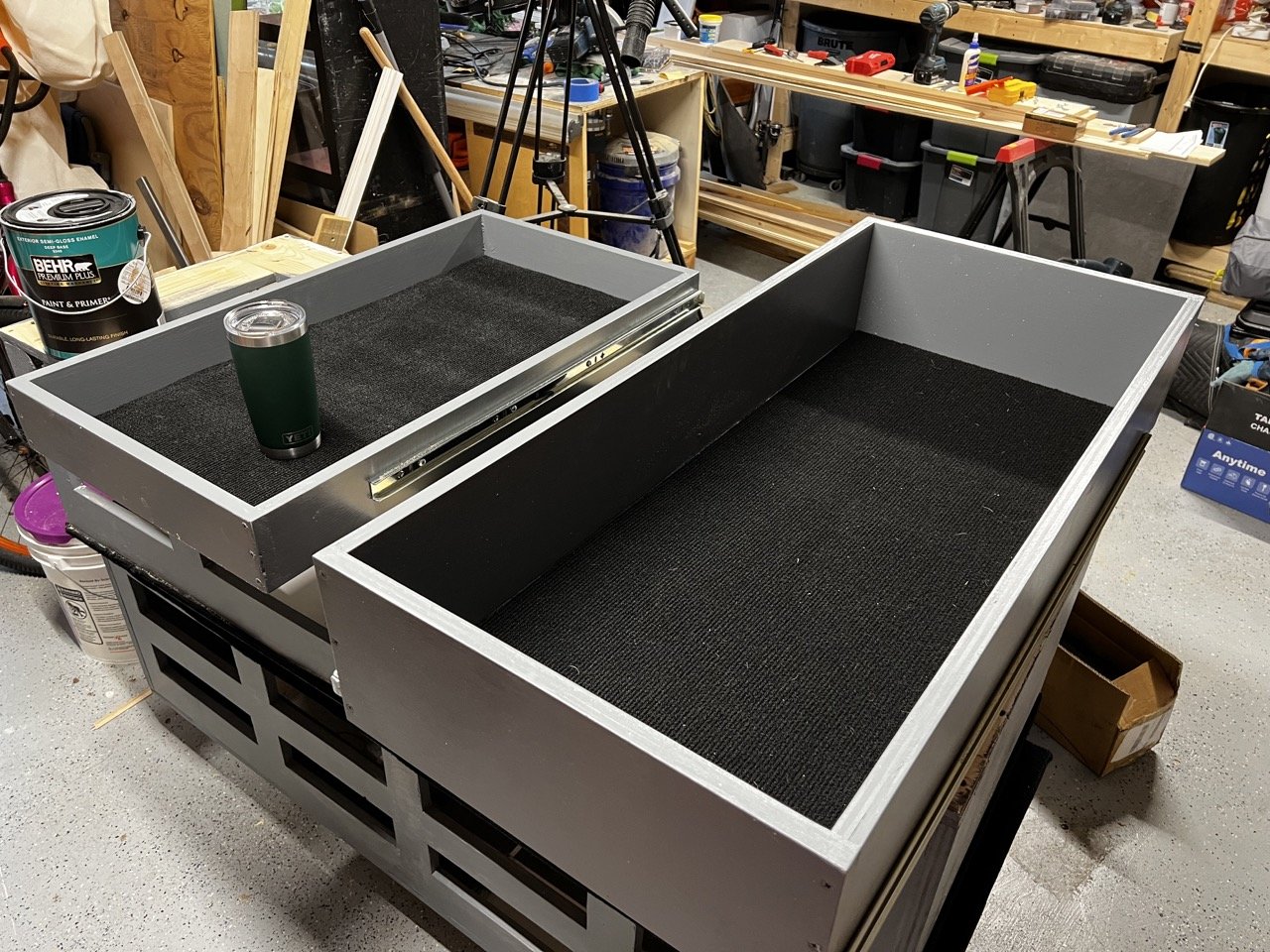

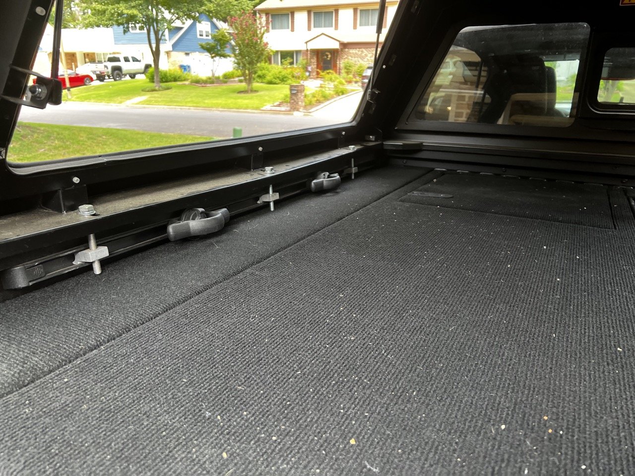

    I realized I haven't posted in here and only on Facebook for a good bit of the summer. Progress has been very slow with the heat and to be honest I haven't been super motivated over the summer. As of today, the unit is mostly put together and in the truck. Wiring is underway and then plumbing needs to be finished followed by the wings and drawer fronts. Lots of mistakes and learning moments have happened but I feel confident this will be done in the next few weeks for some fall trips!
    I went with a marine carpet. This is going to get dirty but will be fine with water. I'll just need to vacuum it from time to time. I'm sure I will redo this in a year or 2 and may try vinyl or some sort of rubber mat. I color matched the paint at Home Depot in a semi gloss
    I actually had to cut the entire back off of the draws and boxes because everything was a tad too long. The tailgate has a slight angle and the handles didn't clear even with the gap I left. The drawers either blocked something or didn't clear something by a 1/2". I was pissed for several weeks before redoing it.

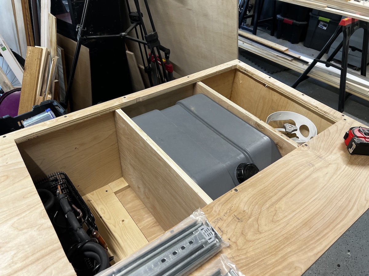

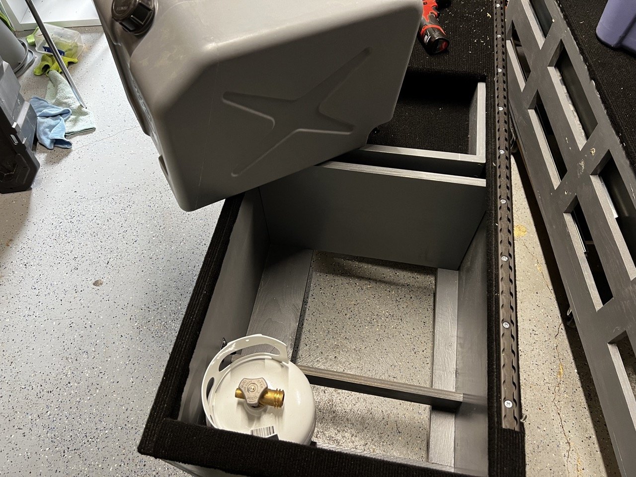

    Everything was made to fit this water container and the fridge. Here you can see the recessed L track for quickly tying down things like my tent, chairs etc. After multiple trips I've learned how much things get tossed around on rough trails.

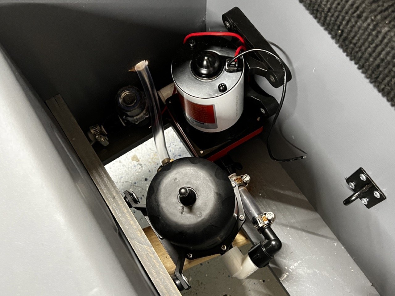

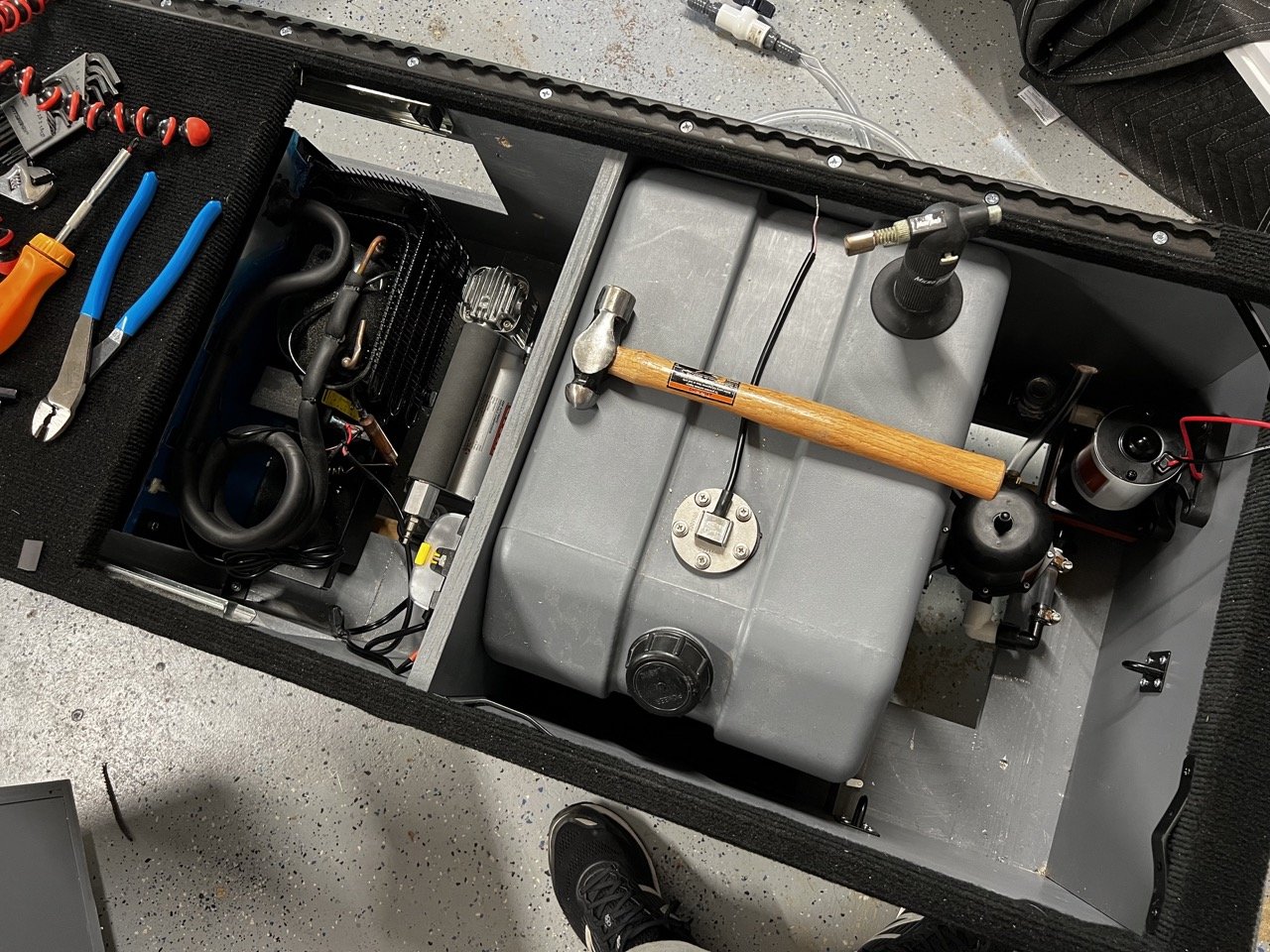

    Water pump and pressure tank. Probably overkill but it will help with the sink and shower.

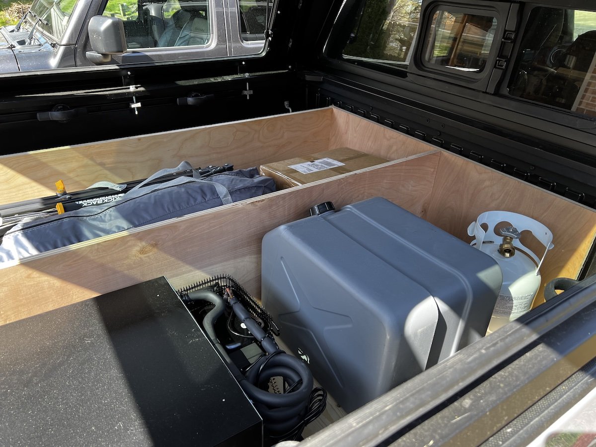

    Everything on the business side is installed. Fridge, air, fuse box, water, pump, pressure tank and gas (5# with a strap on those D rings).

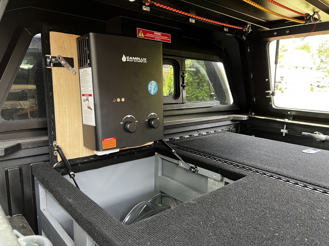

    Gas pop up. Stores flat but needs to be vertical for use. This needs some finish work on it still and a better bracket for the handle.

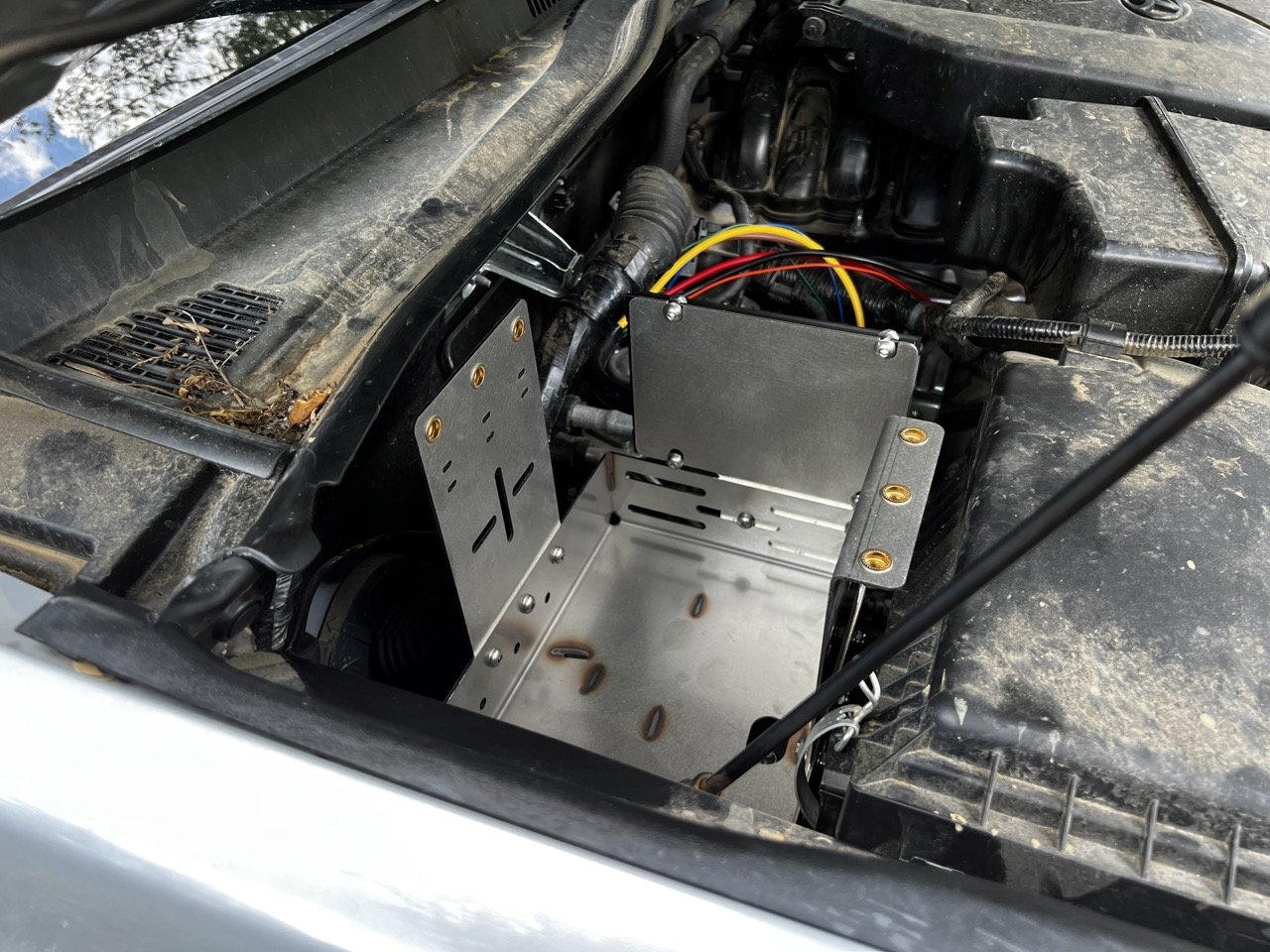

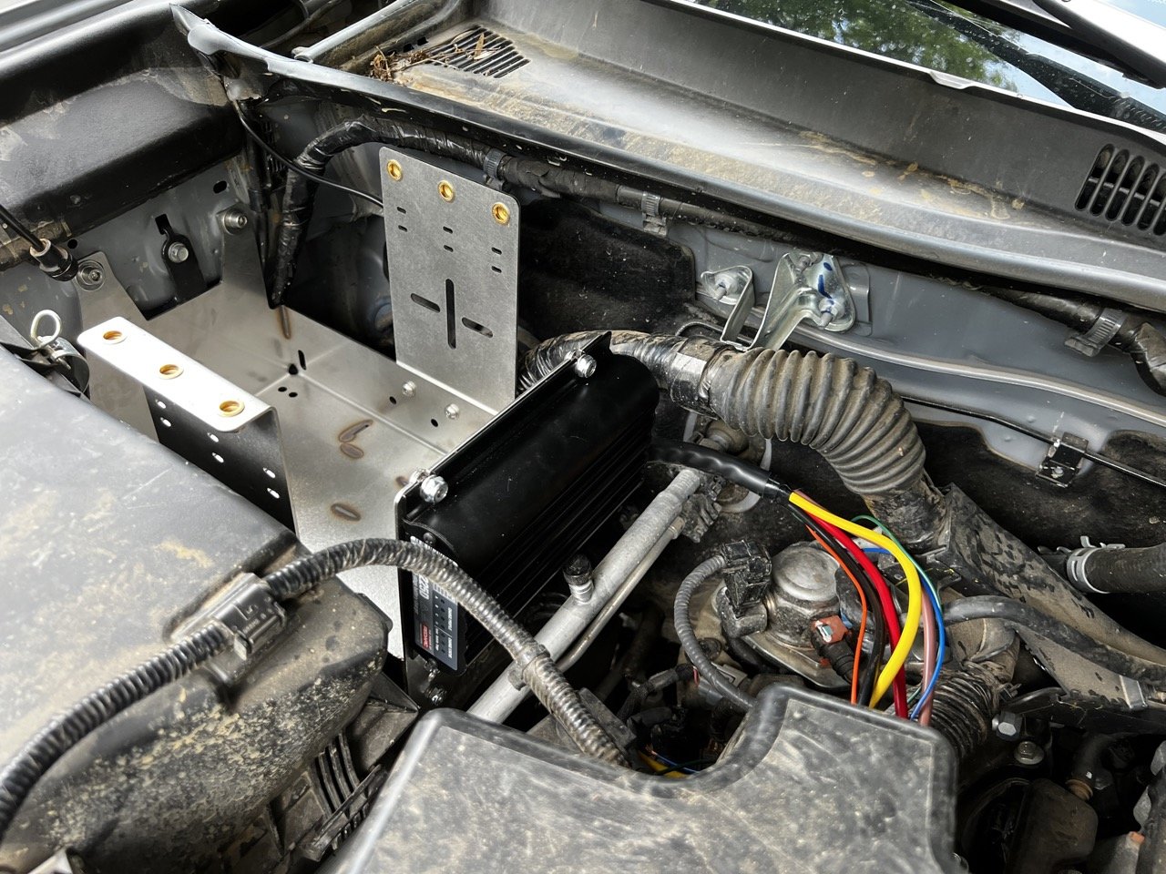

    Rago 2nd battery box and Redarc BCDC. This will hold a group 35 AGM. It's not a massive lithium setup for converters and big accessories. I'm only camping in 1 spot per night with trail rides and charging in-between. I also have an ecoflow river for the tent and device charging. This will power LED scene lights, the sink before and after dinner and the fridge. I will be adding solar to the Smart cap down the road and have a Noco dual shore power charger coming for before and after trips.

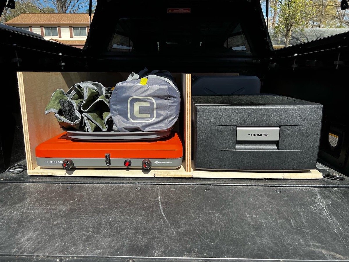

    Assembled in the truck. I have the d rings and turnbuckles in as well now (not shown here).
    Everything opened. I posted this open a few months back if you missed it. I've started on the drawer fronts and handles this week and hope to be done end of September.
    T.Barn and Road_Warrior like this.
