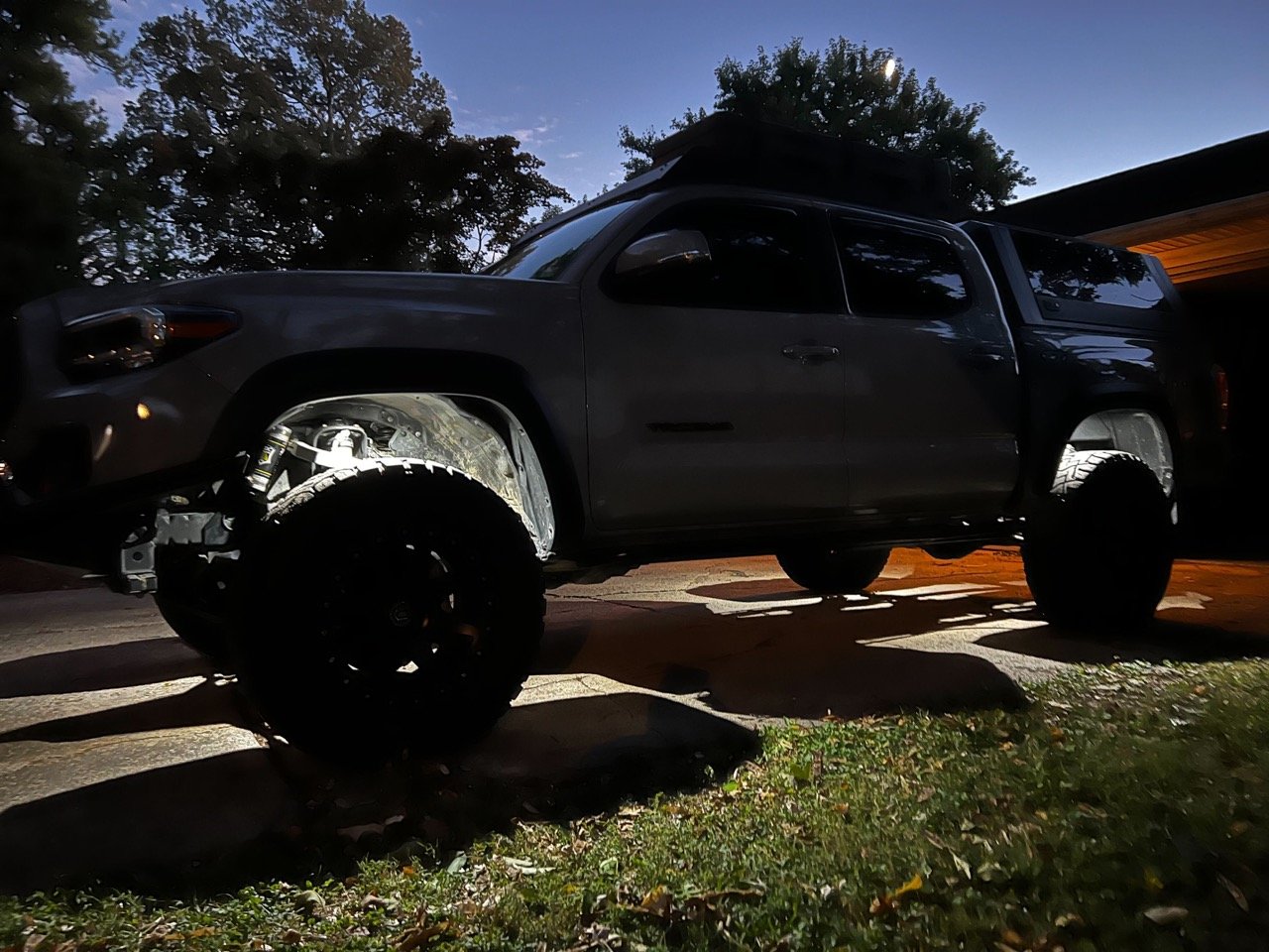

    I got the rock lights on the other day. These are just some cheapos from Amazon but they are super bright. I have more that I will probably install front/middle/back once I find a good spot.

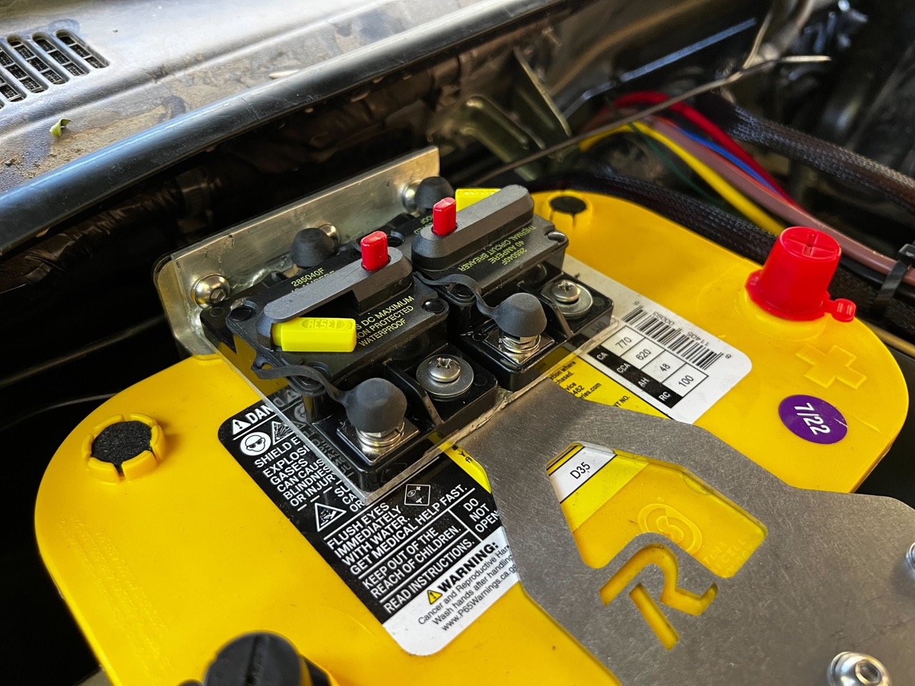

    I also tried my hand at soldering and tapping aluminum to make a breaker mount. It came out decent for my first try but after installing I realized it's just too tight and could be a safety issue. I'm going to redo this soon to allow for the wire terminals and to be farther from the screws. Prototypes right?

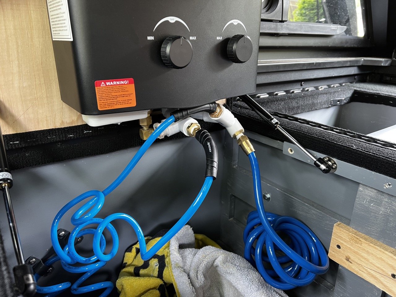

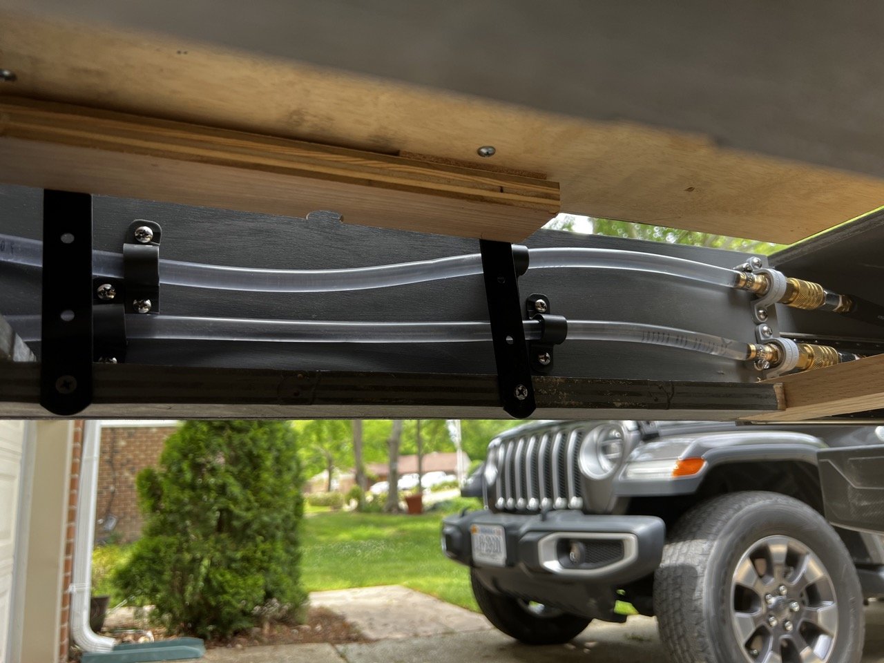

    I finally got around to doing a few things to the truck in an attempt to try and get it "close to finished" even though I know there will be more fun stuff to do. The water is finally done and isn't leaking. I've cleaned up all the lines and secured them behind the grill. I've also got more of the electrical and air run. Today I installed airbags as the truck is definitely sagging when fully loaded for a weekend. This will allow me to adjust it as I unload firewood and water etc.

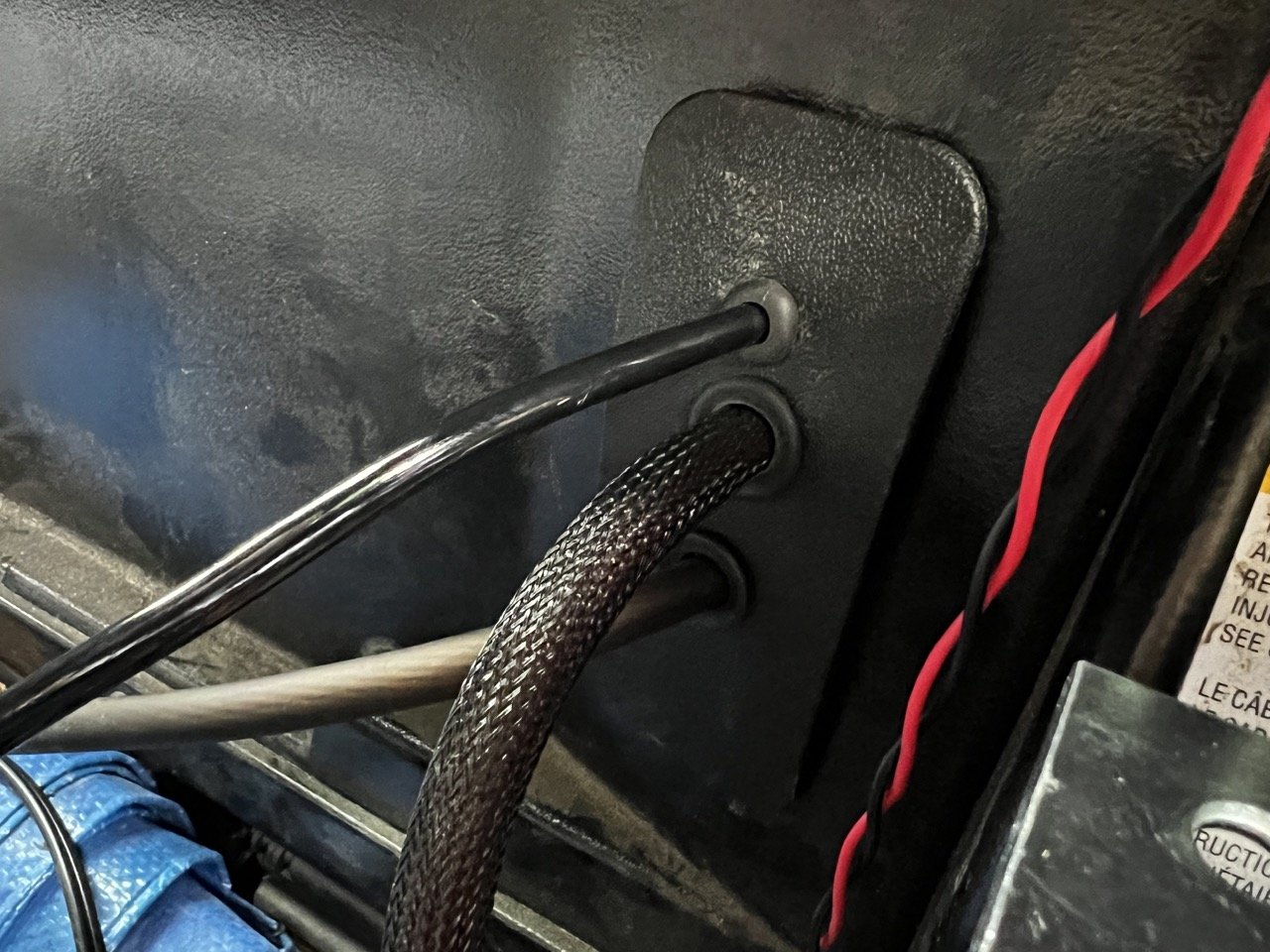

    I know the water looks a little squirrely. Here is some insight. I'm using a Seaflo pump and it's something I saw in a van build. It's definitely too big but I was able to adjust the pressure down some. On the first go, I used 1/2 tubing and barb fittings. I had all the clamps extremely tight and water was still squirting out.
    I decided to switch to air tubing which I could get in a recoil option. This worked great for the 7' slide out. It also allowed me to get everything screwed in with no binding on the tubing. Finally, the ins and outs look a little messy. This is mounted on a hatch so it needs to be able to move freely AND when closed fit in the 2" of space against the back. So while it looks a little crazy it's actually very tight and moveable. On the right you can see the supply coming in to a T which splits to the hot and cold output. Hot water comes out of the left T and there is a spot to hook up the shower hose later. I just don't need it right now.

    Air and power are run through the removable panel for the LED options. This is less of a permanent mod if I ever want to revert this stuff.

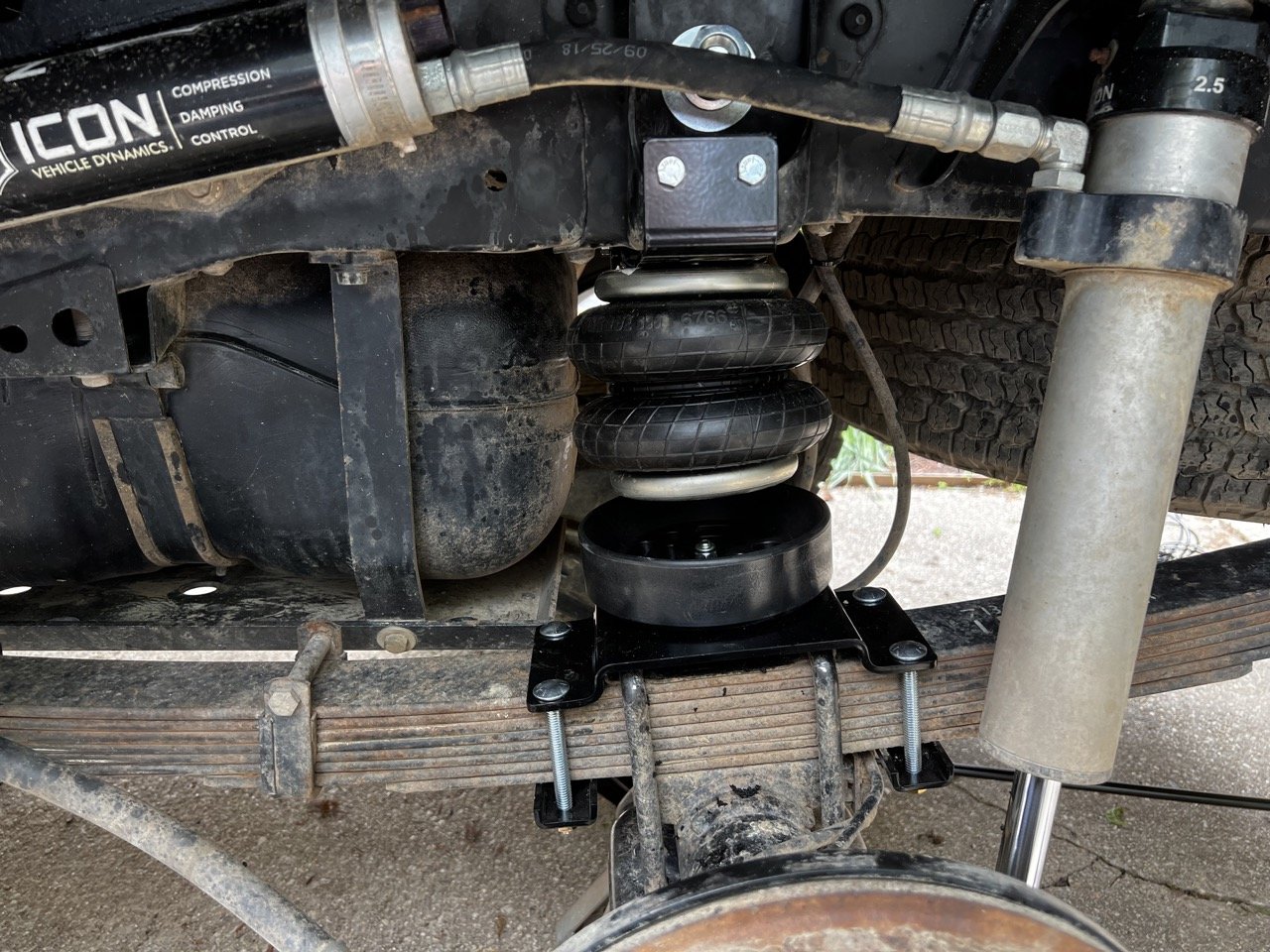

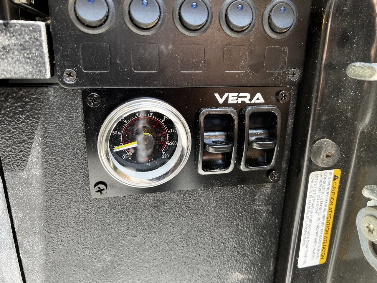

    Airbags and cradles installed. Even with just 5# of air in I got an inch back on the lift already. Looking back I should have gone with something heavier than the RXTs but live and learn. This will be perfect though. I'm just waiting for the controller to arrive tomorrow.

    Everything is hooked up and working great. At 20# I have 2" back.
