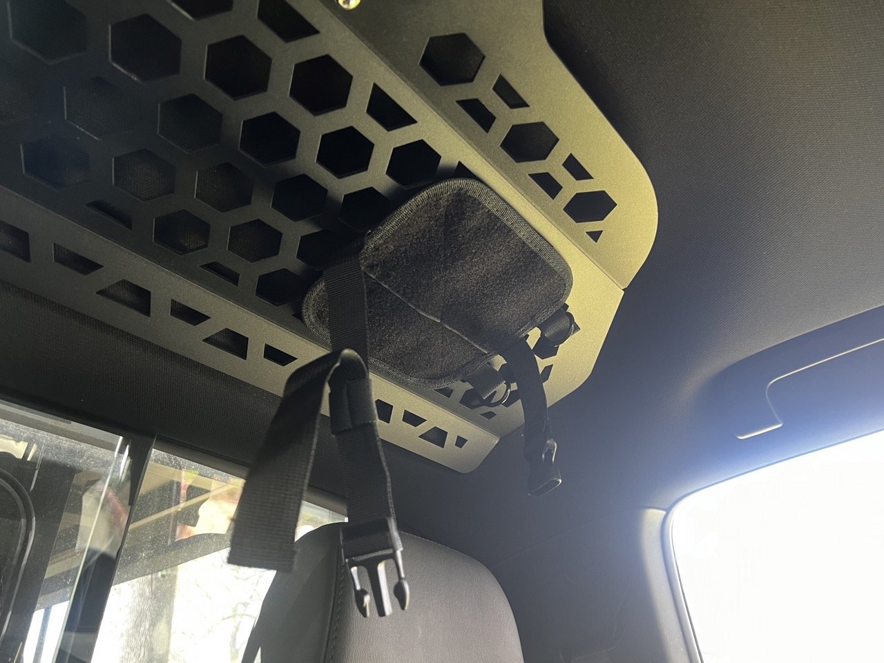

    I also used the ends of some ratchet straps to make pull tabs on the longer wings to get in and out of easier. Super easy and a huge improvement.

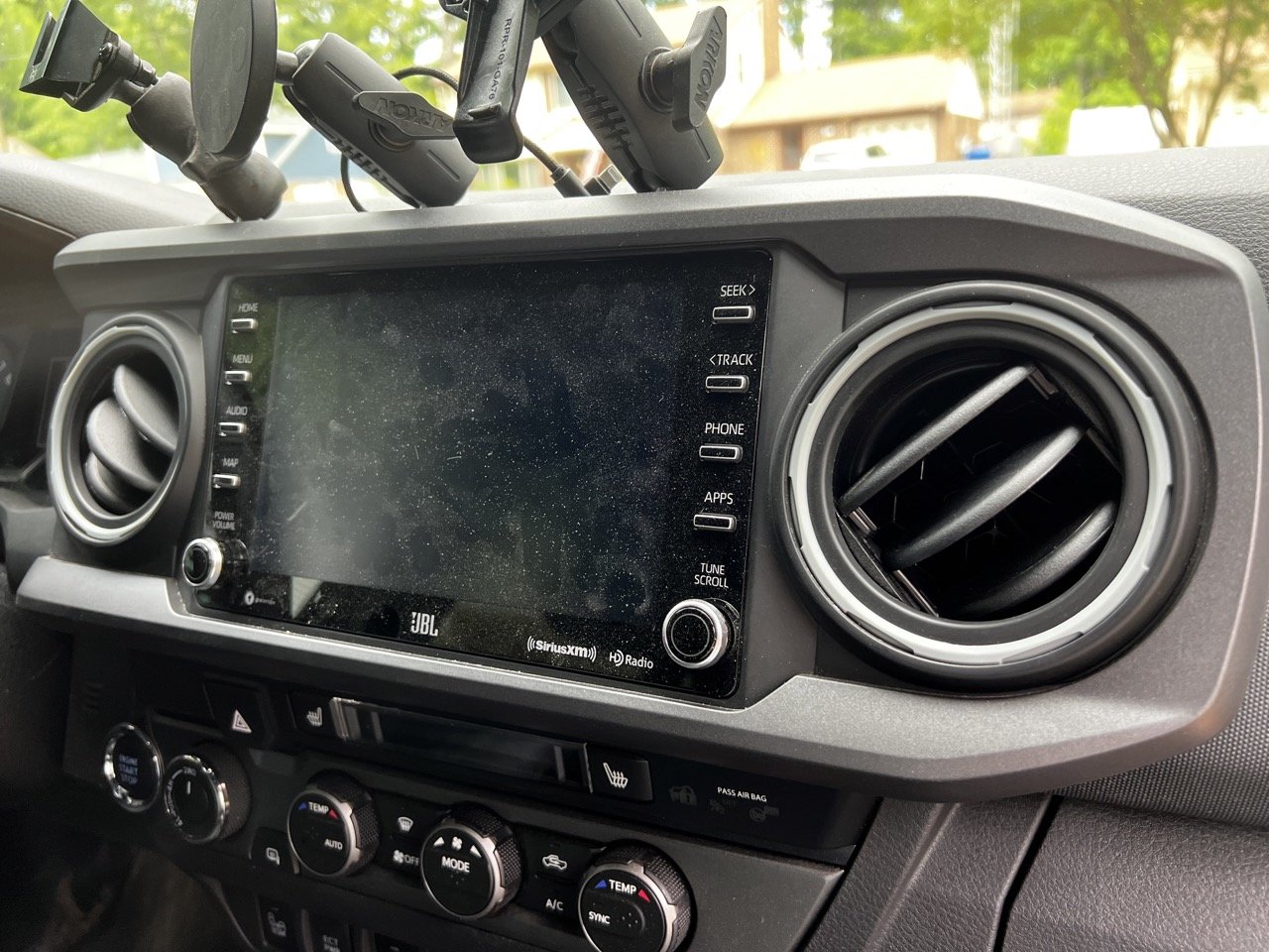

    I've had these chrome delete rings on my desk for a year I think. I finally put them on.

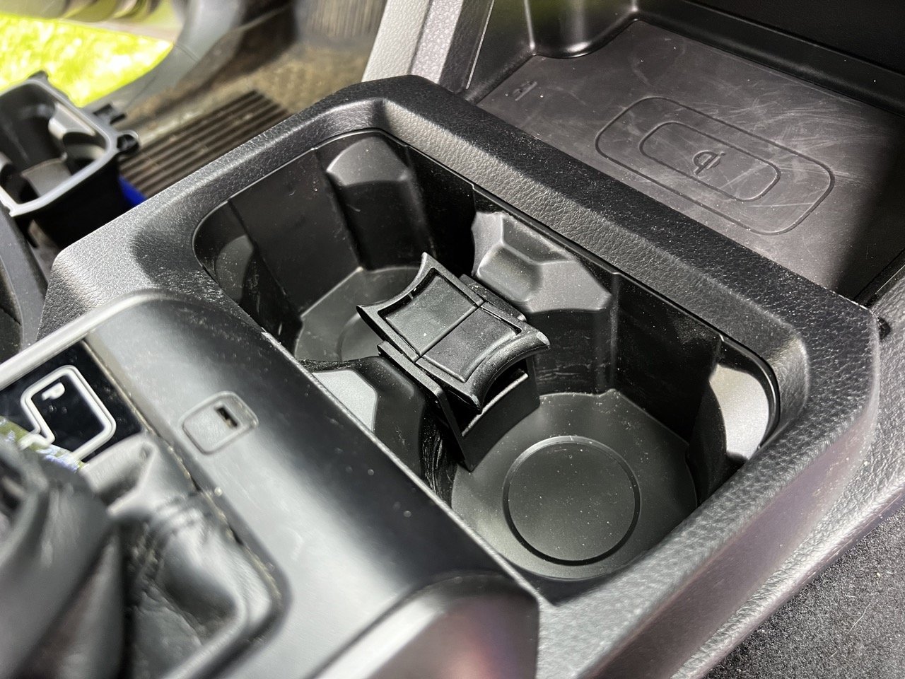

    Today's ridiculously easy and unnecessary mod was installing the AJT cup holder I have had lying around for months. Took almost 4 mins to install.

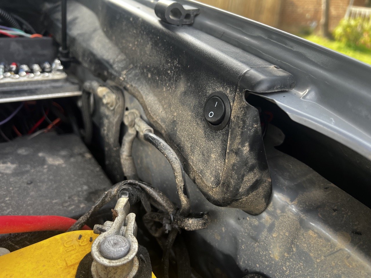

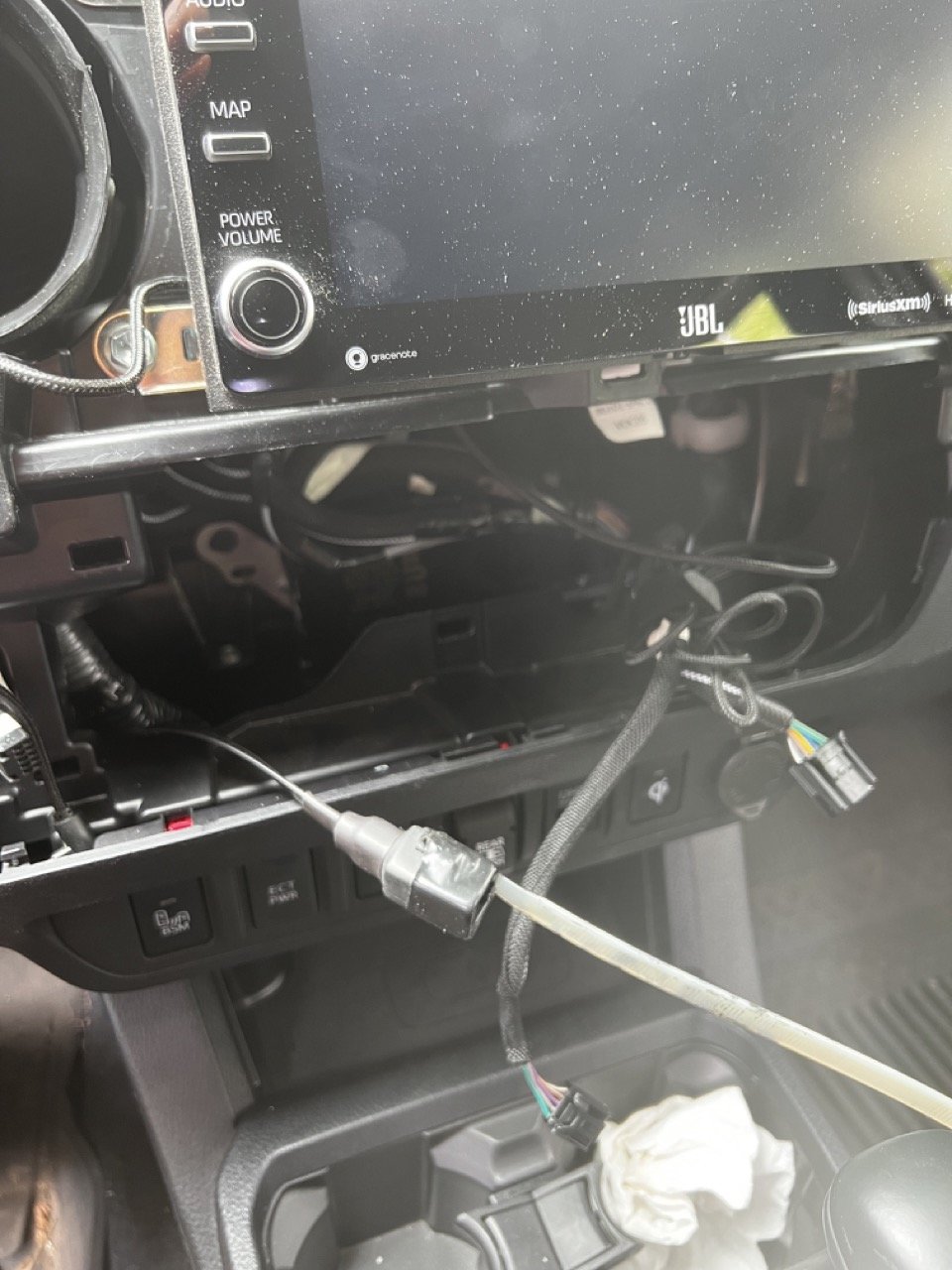

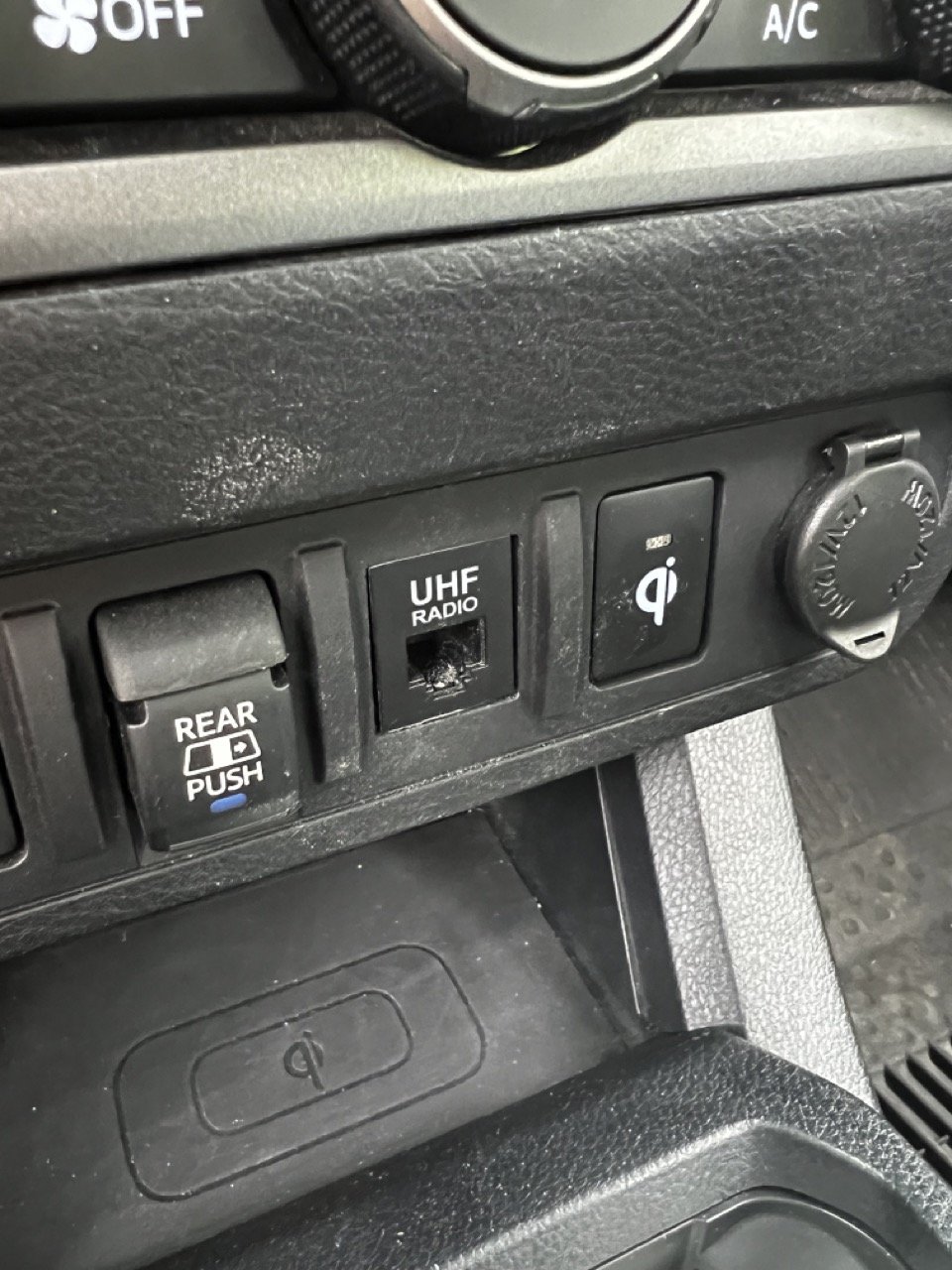

    Another small mod this morning. I found a RJ45 insert for a standard button location. I sanded it down to fit the odd USB slot that is now behind the dash up above the radio. This will be a nice change from it dangling down on the floorboard on trails.

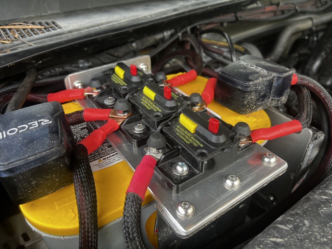

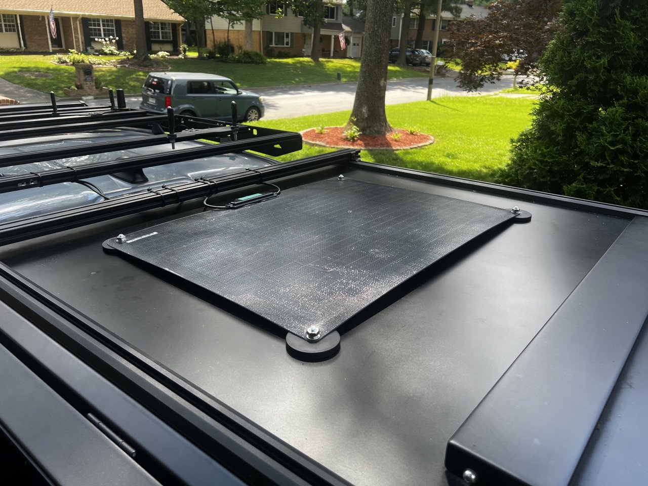

    I finally got around to reworking the breakers on the aux battery and adding solar. I got a friend to bend a new bracket made out of a single piece of aluminum. I tapped and drilled it to fit on the Rago top bracket. It's much cleaner and the new orientation separates the contact points better (old setup). I attached the solar with 4 60# magents that are insanely overkill for this. I have a piece of closed cell foam under it to help it not sag the 1/4" difference under it. Power goes across the rack and down the driver side in a KC Hilites channel. Breakers are primary to BCDC, BCDC to secondary and secondary to bed. Overkill? No... I've tripped 2 of these accidentally now and it's so easy to reset. Super clean overall, love it. I need to wire up my NOCO shore power charger now.

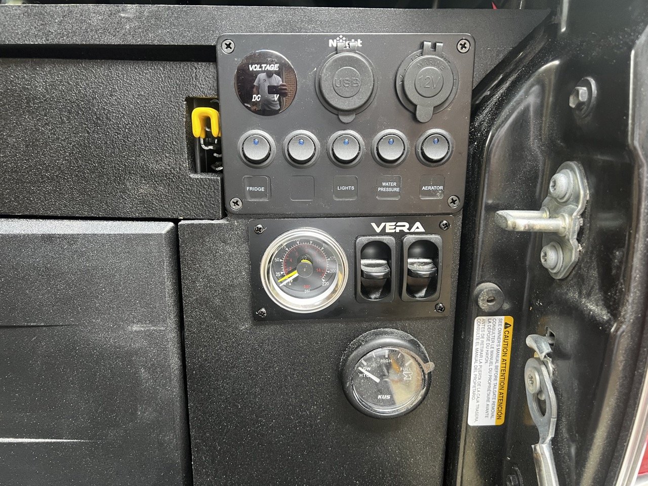

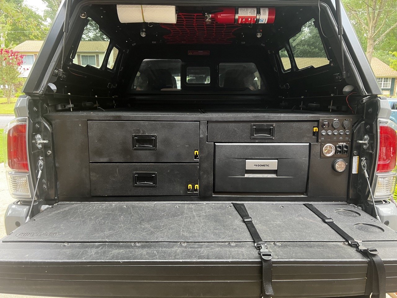

    So the original trim piece and a door face were made from leftover 3/4 plywood. Water has crept in around the doors over the summer and dripped down causing it to separate. I redid them last week and finally installed the water gauge for the tank. I also picked up an Adventure Trail Gear GARB bag for the back. This weekend I'm planning on running air to the front and back frame for easier inflation. Right now I have to move or unpack things and take the drawer cover off to get to it.

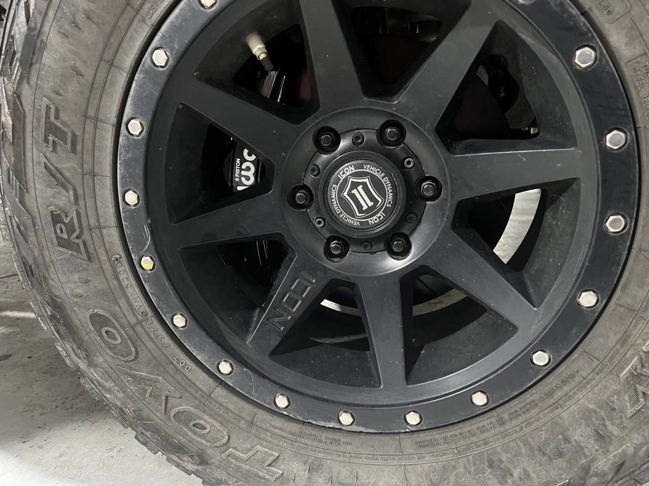

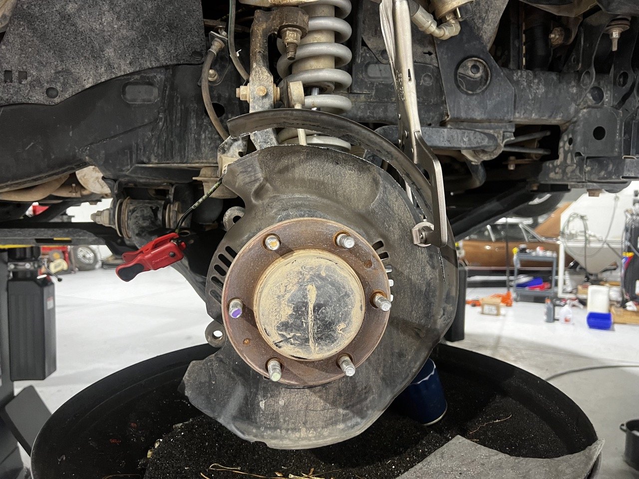

    Today is the first day I felt like this build has stepped into the big boi category. I've never done a brake upgrade and even though I did hydraulics on my hatchback in the 90s, doing brakes feels like a bigger step somehow. This mod only took about 2hrs a little trimming though. Learning to bleed the brakes this morning was a great skill to have under the belt as well. I'm actually pissed I've never changed my own brakes before.. so easy to swap pads.
    I opted for the Wilwoods purely based on the cost of the kit after looking at different BBKs and pad/rotor upgrade combos. I haven't upgraded the master and honestly, I don't feel like I need to. These guys are throwing me through the windshield already and I'm 100% happy with the fit and finish. It's going to make a massive difference on my next trip... almost ready for Kentucky! My last big upgrade will be a regear in the fall (I hope). I'm sure there will be changes and small things but the big ticket punch list is almost knocked out!

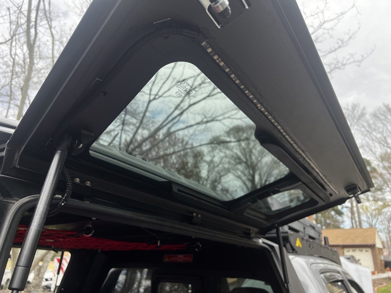

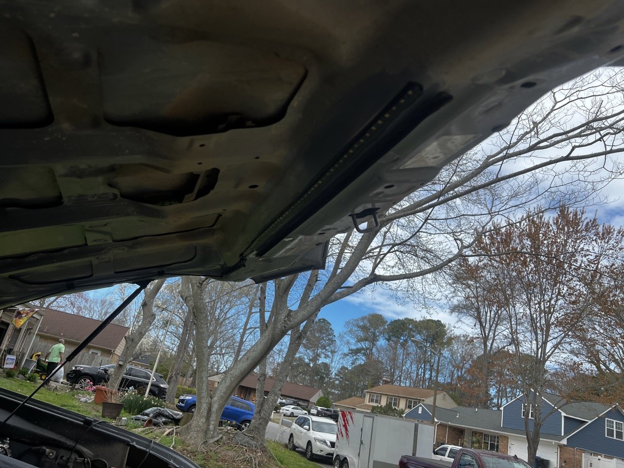

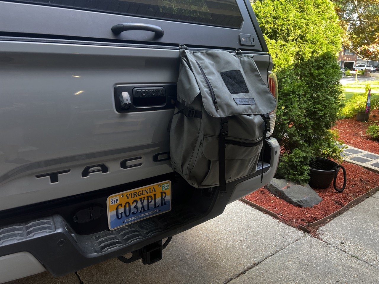

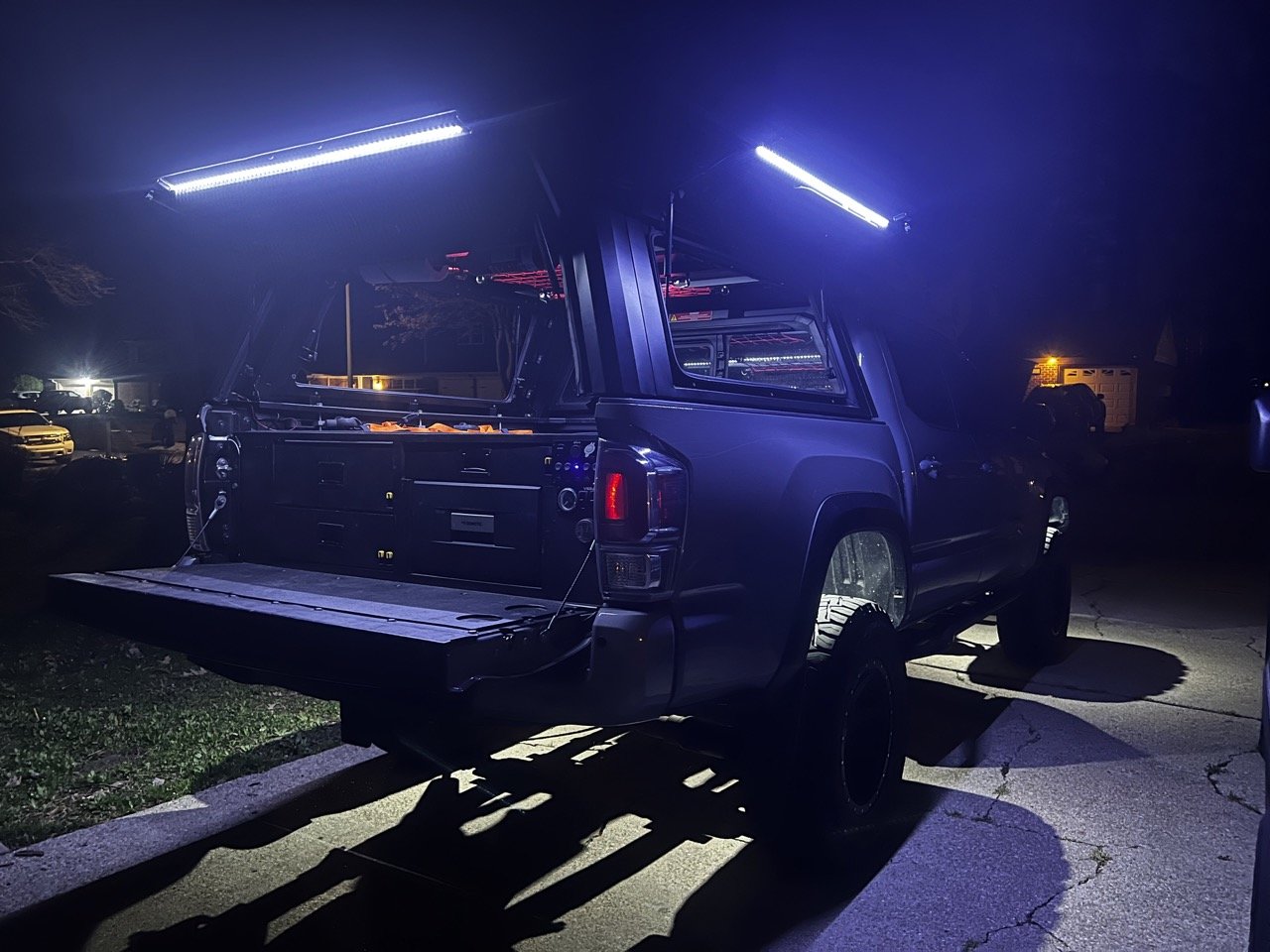

    Did a few more upgrades before my trip to Kentucky. I bought some tear-off bags at overland expo last year and never got them overhead. I also redid the lighting on the passenger gullwing which got torn while trying to wire it originally. I used the scraps to put a strip under the hood. I rushed through the hood strip though and kinda pissed it came out messy but it's whatever. I was originally going to put this on a hood pin switch but decided against it mid install.

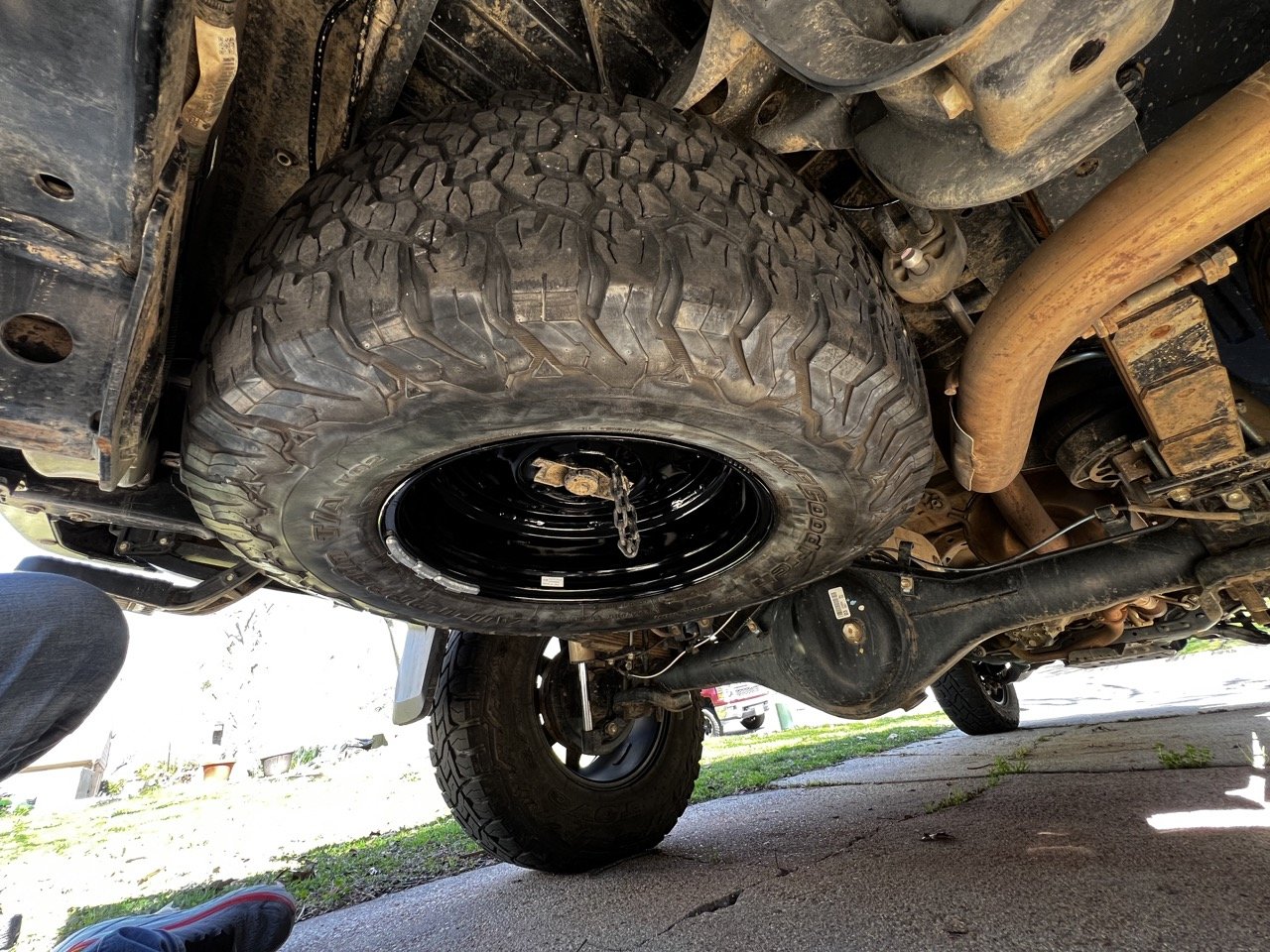

    Finally I got a full size spare under the truck. I picked up a steel wheel on sale and got a used ko2 off a local group. This fit under without any bending or cutting, I just dropped it to 20psi and pulled it towards the rear a bit while cranking it up.

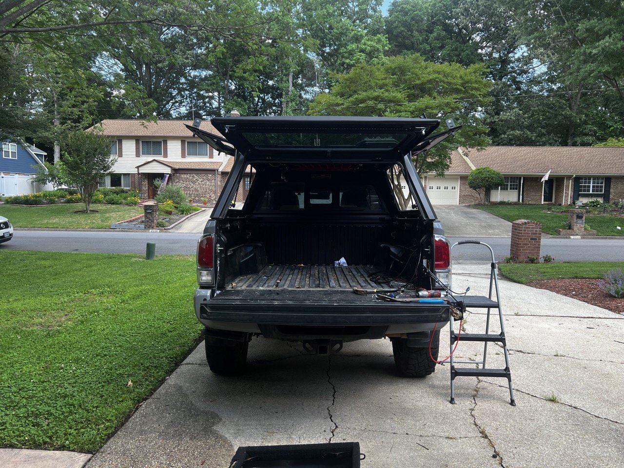

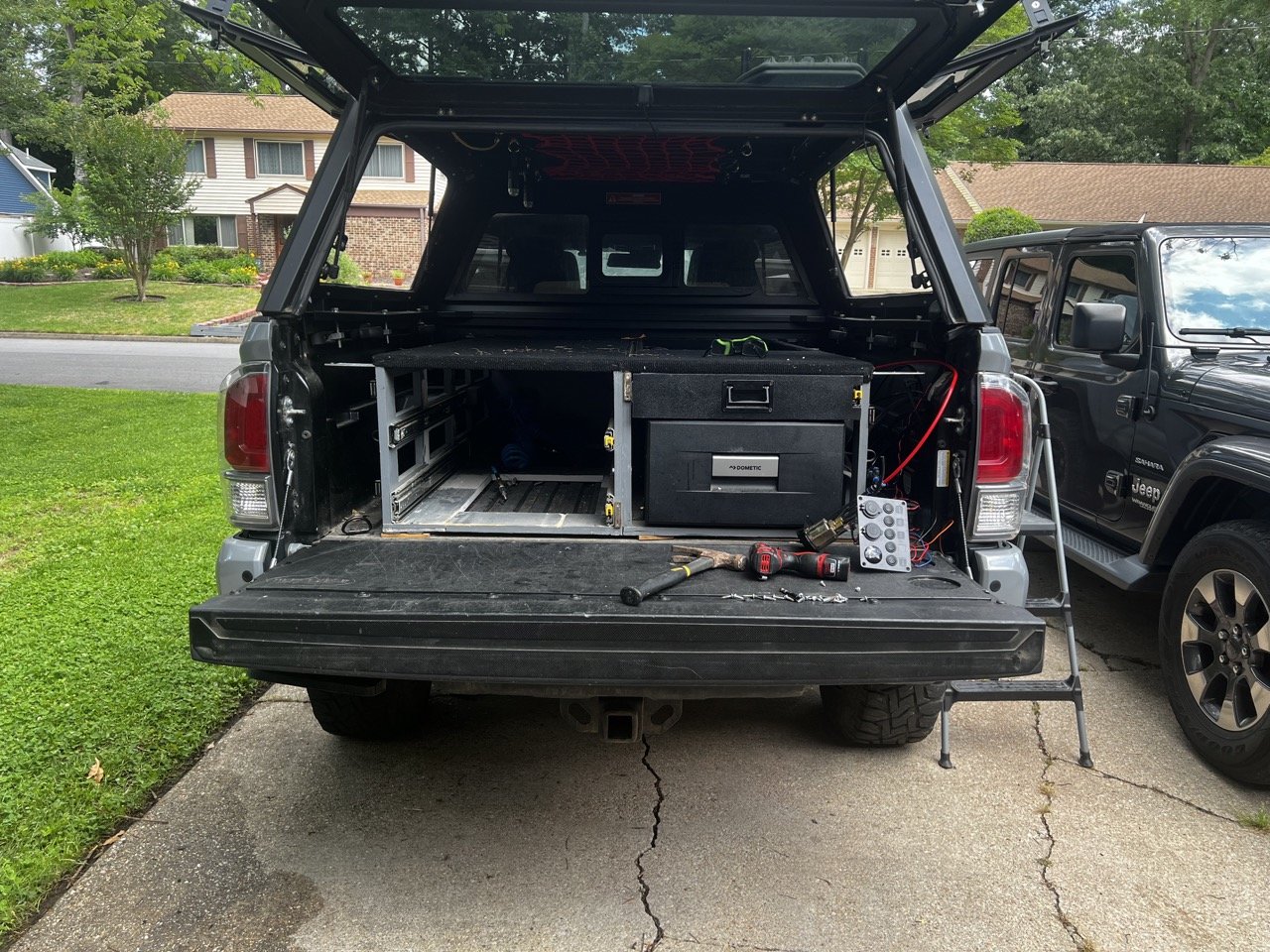

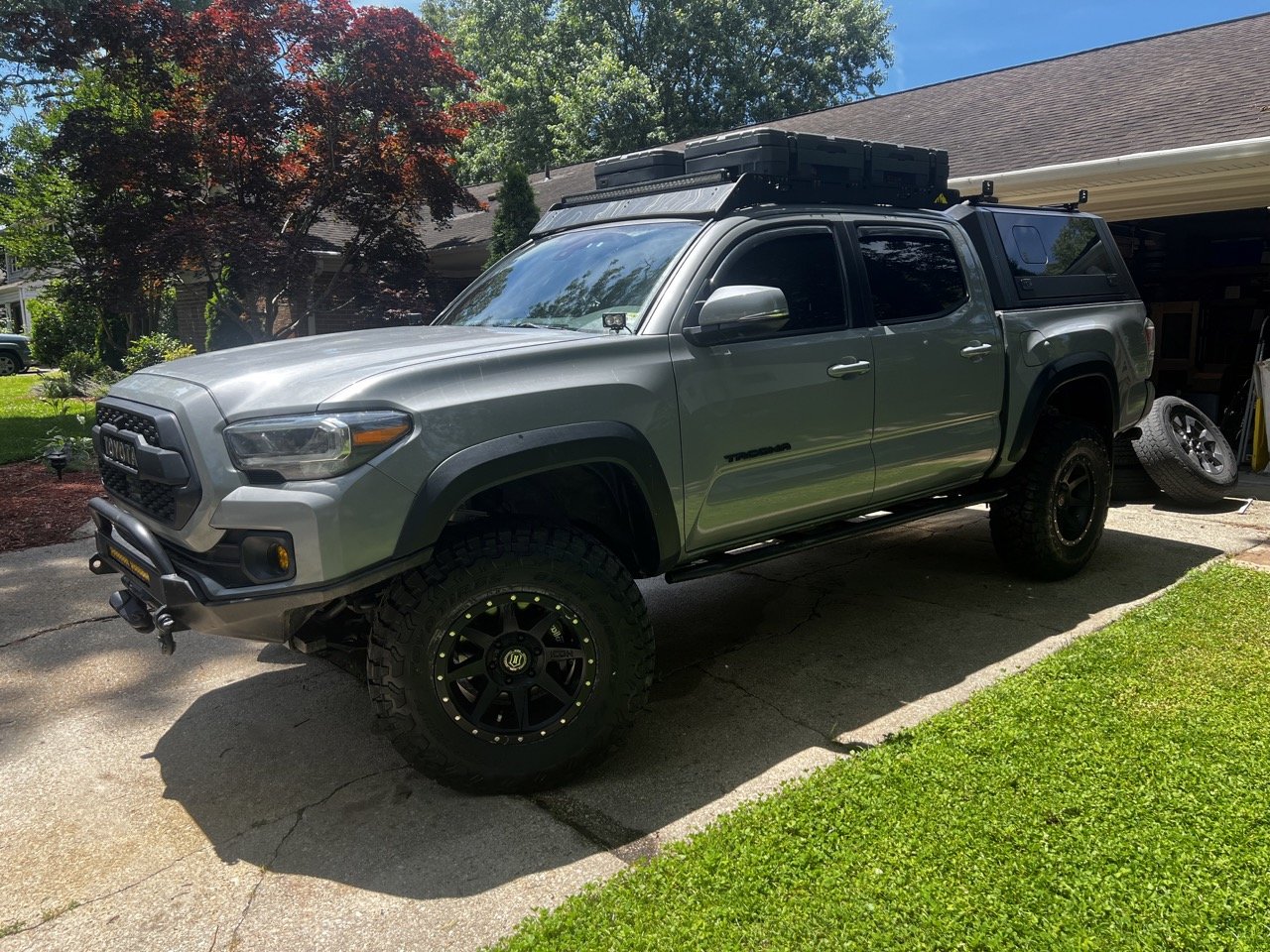

    Last weekend I upgraded to 285/75s. I stuck with the Toyos and these are like 6# more each. We put my 285/70s on my wife's Jeep which had around 20k on them. I'm super mad I didn't measure the clearance before but wasn't a huge change in my head before. I swear the truck sits an inch higher now. I need to regear next but I'm shocked at the prices I'm being quoted. I know it's 2024 but I need to find a place to do it much cheaper if it's going to happen.
    I also pulled the entire back out. I got the truck weighed with gas, water and gear in and it was at roughly 6250#. Time to rebuild and shave off some weight. I'm sure if you've followed this build and have had any experience with drawers you knew this was coming. I'm going to go with 1/2 plywood, simplify the kitchen a bit and lose all the drawer slides which are probably 100# total on their own. I'm even considering using foam after watching a lot of lightweight RV builds but I'm worried how it will hold up after time on trails. More to come.
