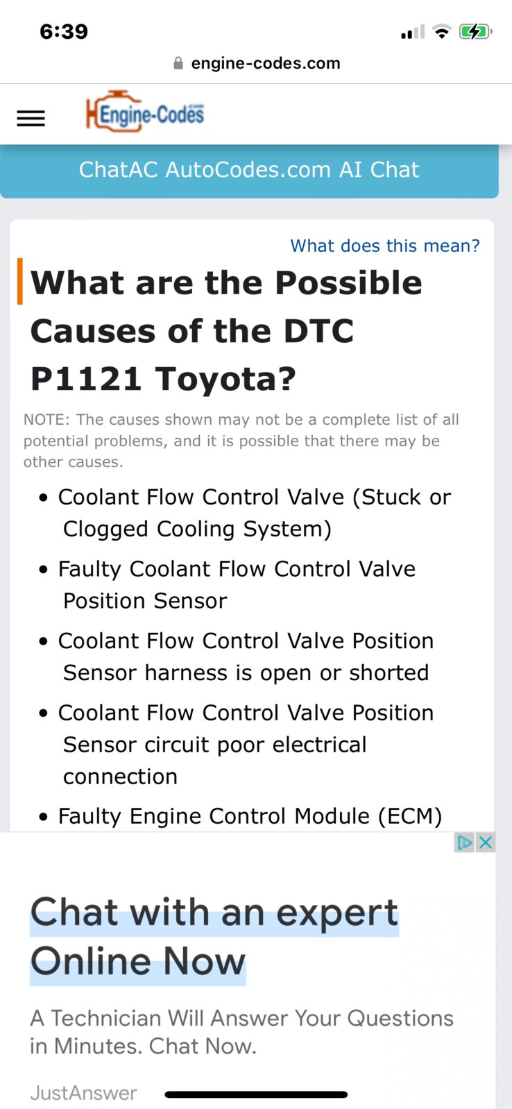

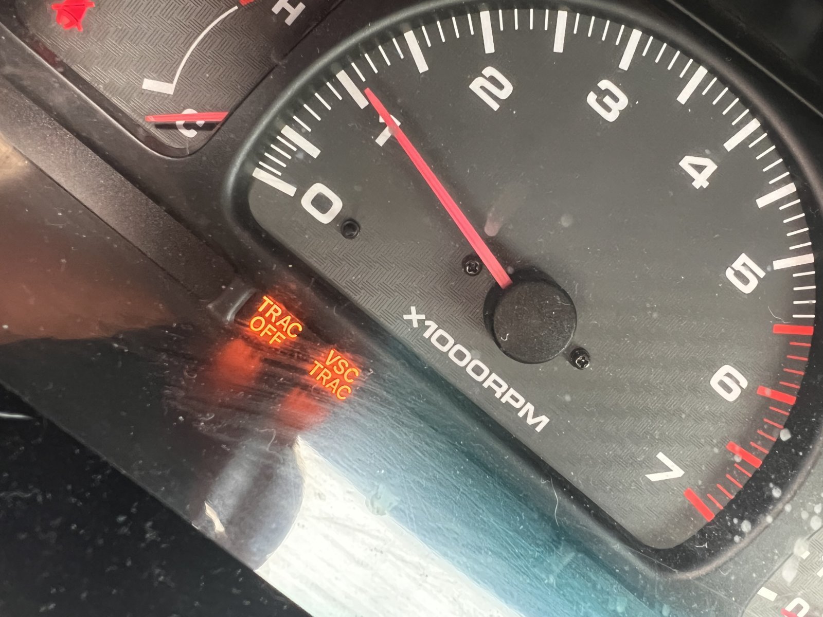

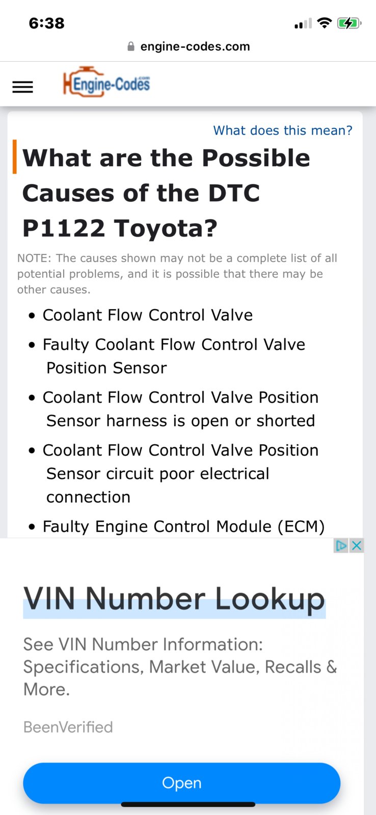

    Having an issue with the above lights coming on all at once. Loses significant power? Mark codes P1121 and P1122 are present. I replaced the hard to find TP sensor and still having the issue. Any thoughts

    On late model Subaru CE/trac control lights on and Cruise light flashes
    Just to get owners to notice something is wrong
    just concentrate on those 2 codes
    Both point directly to coolant control valve
    Assuming 3.4l engine?

    Changed both the TP Sensor and coolant control valve and problem/codes still pop up roughly 10 mins of driving??
