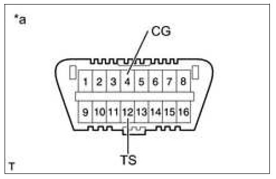

    I think this is what you are looking for. This is copy/pasted from another thread about resetting the VSC after an alignment (this is not mine BTW)...
    Zero Point Calibration
    Here's decent instructions on how to reset the VSC system and perform a Zero Point Calibration using the paper clip method;
    1) Park your truck on a level surface. Make sure the steering wheel is completely straight.
    2) With the key off, disconnect the battery for a few minutes, then reconnect it.
    3) Turn the key on, without starting the engine.
    4) Grab your paper clip, and using the picture below, connect and disconnect the two terminals shown (CG and TS) four times within 8 seconds.
    5) You should see the VSC light turn on. This means that all the calibration data has been cleared.
    6) Turn the ignition switch off.
    7) Now take your paper clip, and connect the two terminals shown (CG and TS) in the picture.
    8) Turn the key back on, without starting the engine.
    9) After a few seconds, you should hear a buzzer sound for 3 seconds. After that buzzer stops sounding, Turn the key back off, and remove the paper clip.
    10) Because you disconnected the battery, your radio presets will be lost, as well as the calibration for the Auto-Down function on the driver's window. To re-calibrate the window; simply hold the switch down until the window opens all the way, then keep holding the switch for a few seconds. Then hold the switch up until the window fully closes, and a few seconds afterwards. The same holds true for Tundras equipped with an Auto-Down back window, and Moonroof. Use the same process described in this step, until all items are re-calibrated.
    That's it. The whole process should take about 10 minutes or less.

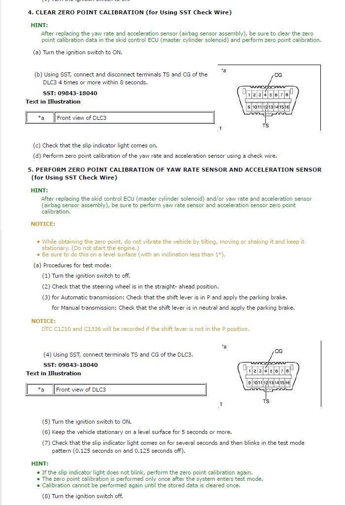

    I just went through this on my 2017. I hit some rocks in DVNP that bent the driver-side lower control arm/spindle, and I had to cock the steering wheel to the right to drive straight. After fixing the bent parts the VSC light was still on, and the alignment shop didn't have the electronics to reset. Between the instructions posted in this thread (post 4), the YouTube video (post 15), and posted section of the Toyota manual (post 17) I was able to perform this operation. IMHO the manual section in post 17 is the most accurate and helpful single document posted here.
    My observations/tips:
    1. Disconnecting the battery is NOT necessary. The factory manual section (post 17) describes it as clearing the VSC zero point data, so it didn't make sense to disconnect the battery and clear EVERYTHING. I successfully performed the operation without disconnecting the battery.
    2. In most of the drawings of the OBDII (or DLC3) connector the connector is shown inverted from its mounted orientation in the truck. Refer to the Youtube video screenshot in post 15 for actual orientation. CG (chassis ground) is pin 4 (per OBD specification), and TS is pin 12 (Toyota definition, pin is not used for OBD). Pins 4 & 12 are directly opposing each other.
    3. With keyless starting remember that it takes two start button pushes without depressing the brake pedal to get into the ignition-on mode.
    4. When clearing the VSC memory the lights go through a blinking sequence and ultimately the VSC and ABS lights starting blinking unsimultaneously (is that a word?). The warnings in the video regarding truck movement while clearing seem to be bunk, the computer is clearing data not calibrating.
    5. When performing the VSC zero point calibration, the VSC and ABS lights start blinking simultaneously when the procedure is complete.
