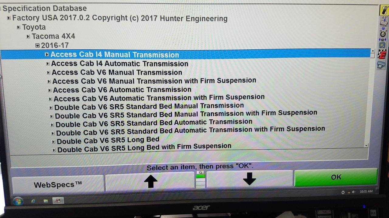

  17. Jul 19, 2017 at 10:27 AM
    #17
    SeanDub
    SeanDub Well-Known Member
    Mar 24, 2015
    #151664
    264
    Sean
    Morgan Hill, CA
    2017 TRD Off-Road
    Icon Stage 4
    20170719_102941[1].jpg Also, our alignment machine has our Tacomas in it.

    is that a Hunter alignment machine?
