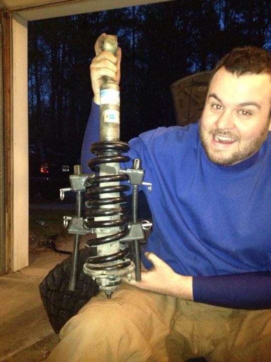

    Just think if this thing unloaded when you had it on your knee, I feel pain just thinking about it.....:eek:

    Holy crap. I used spring compressors like that to do my 885s and it was sketchy. Those looks like they are on the verge of exploding.

    they did later on

    After the last time using those when i noticed one was cracked after using it, ill never use a pair of those compressors again. So damn lucky it didnt break while it was sitting on his leg...broken femurs are very painful.

    I had the same kind break on me as well. That's one tool you don't wanna go cheap on.
